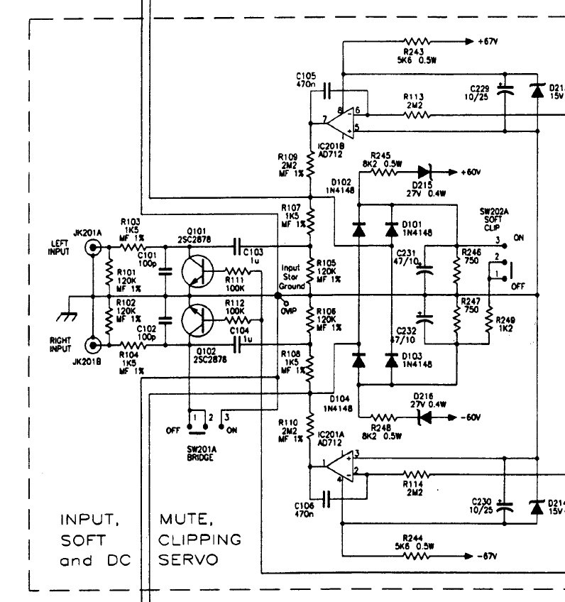

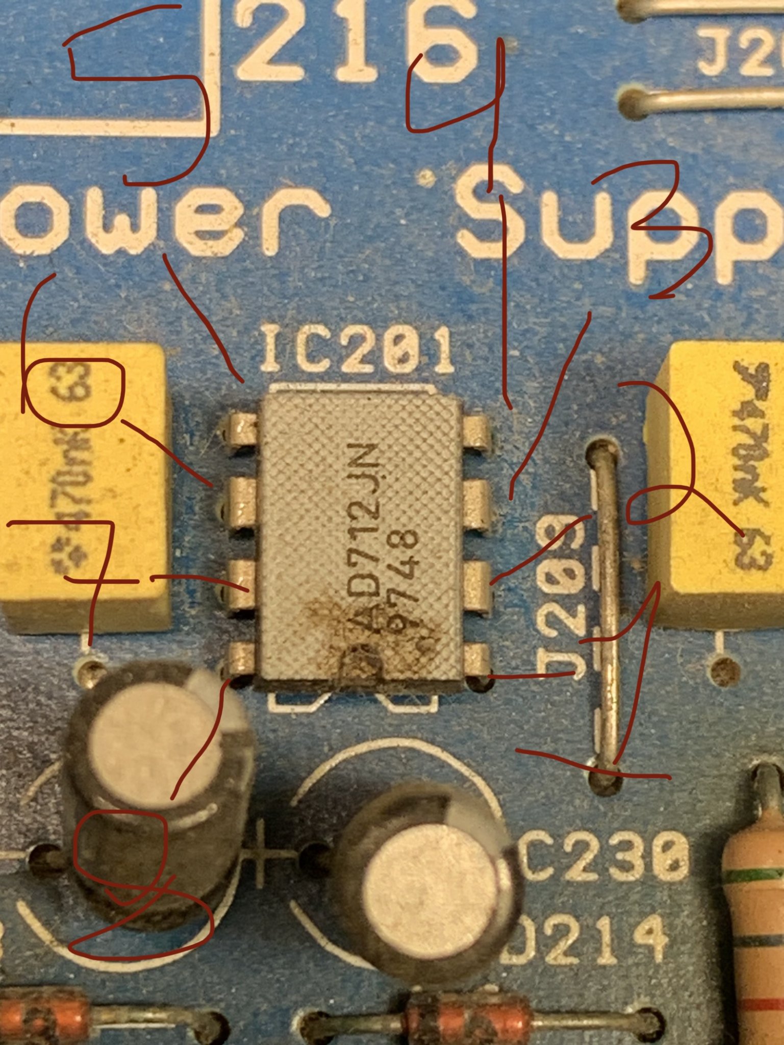

If IC201 terminals 3 and 5 are not at 0V, you had measured voltages wrong or there are soldering problems somwhere on IC201 traces/terminals or all input ground plane is not at ground.IC201: Used the graph below to locate pins, black probe on ground red probing
Pin 1: -0.47V
Pin 2: -6.61V
Pin 3: -15.37V
Pin 4: -15.75V
Pin 5: 0V
Pin 6: -6V
Pin 7:-0.47V
Pin 8: -0.75V
If i understand this correctly the Outputs are fine no?
Also IC 201 can be dead as inverting input 6 is on lower voltage than noninverting input 5 but output is still on minus side. I presume pin 3 value is measurment error and pin 5, 6 voltages are correct.

I re-did IC201 measurement here are results: I also included the photos of which pins I'm measuring.
Pin 1: -0.52V
Pin 2: -14.11V
Pin 3: 0V
Pin 4: -15.48V
Pin 5: 0V
Pin 6: -14V
Pin 7:-0.52V
Pin 8: -0.75V
Additional note: If I want to replace IC201 will a AD712JNZ work?

Now IC201 measurement seems more reasonable.
If pin 8 is really on -0.75V (nearly not possible it can be on minus side but...) not +15V, then D213 or R243 is dead. If I remember correctly on my NAD D213 was dead.

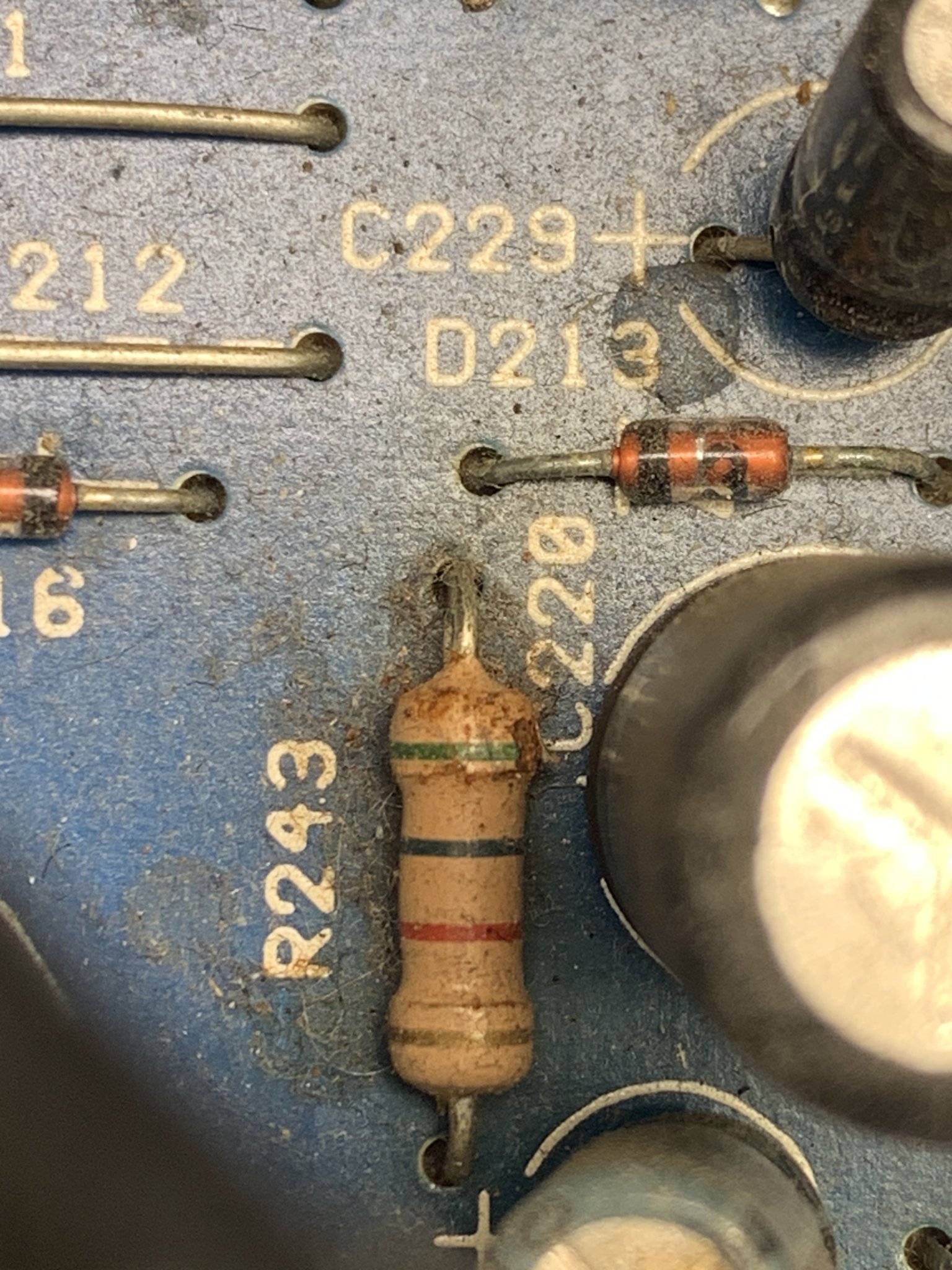

Thanks for the reply @kaameelis, I’ll double check PIN 8. How would I go about testing R243 and D213. R243 is just checking resistance I think but how do I check D213.
R243- Bottom measurement=-1.693V Top measurement=-0.766V
R244- Bottom measurement=-67.9V Top measurement =-15.43
D213- Left side measurement= -0.762V Right side measurement= 0V
D214- Left side measurement= 0V Right side measurement -15.43V
so R243 is toast right ? and so is D213 ??
side note: R243 measures the same resistance as R244 at the top of the PCB haven't tested the bottom because hard to get to and currently waiting for CAPS to discharge.
and pin 8 of IC201 is definitely negative, well at least that's what my multimeter is saying.

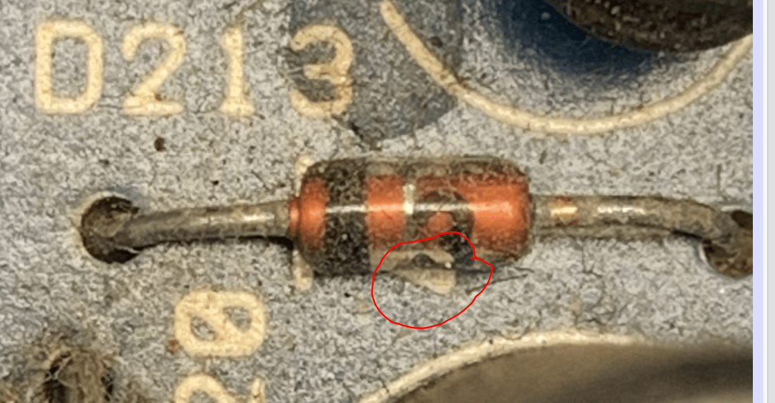

D213 is fine cosmetically, what you see in the picture is the PCB drawing of a diode I think.

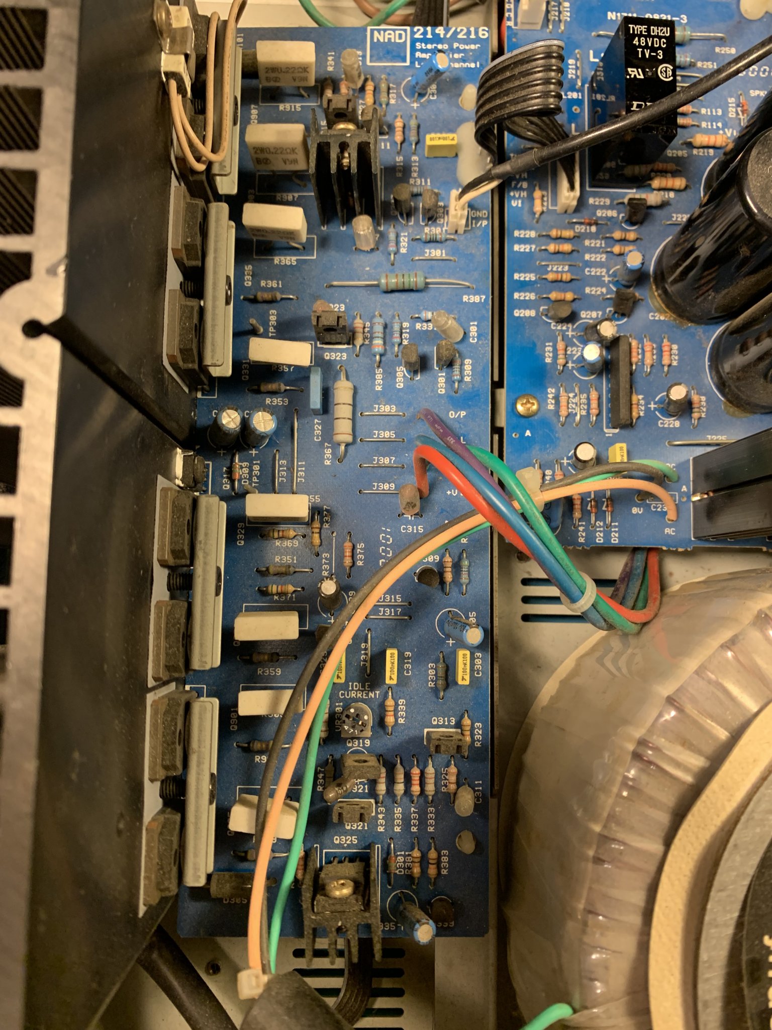

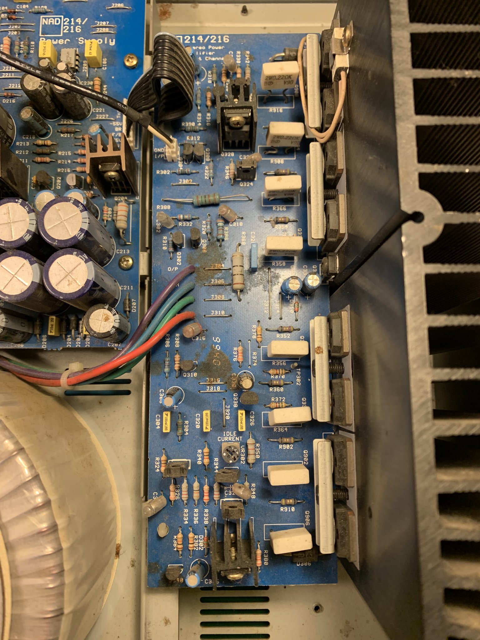

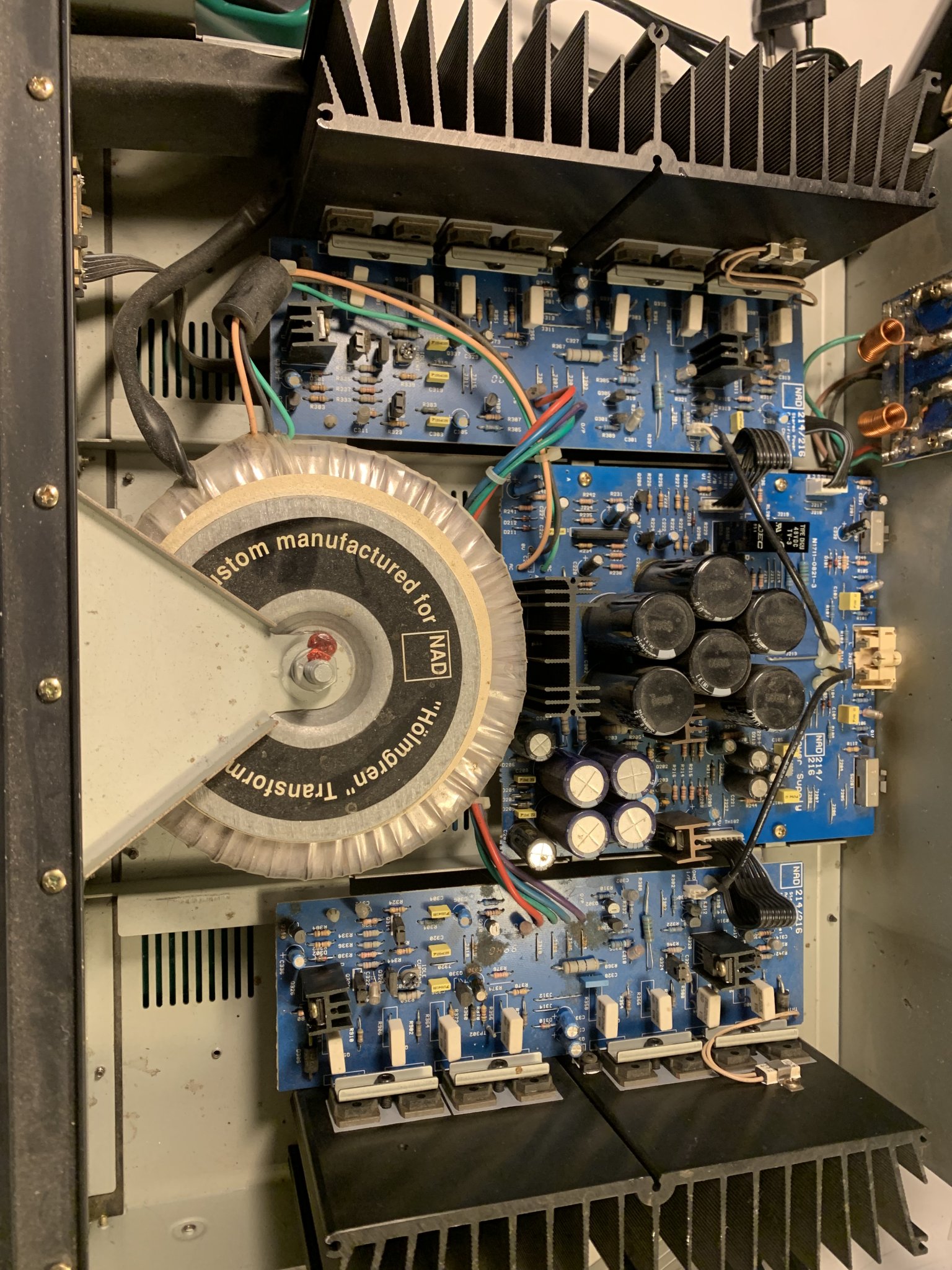

good pictures from the internal PCB's.Hello,
I’ve recently bought a not working NAD 216THX for $110 the seller stated only relay not working needs replacement, I bought the amp knowing it’s not only the relay so not a disappointment, I did replace the relay with the exact same model not newer not older, and still nothing. All the caps seem visually fine so I’ve taken some voltage readings on some jumpers that make logical sense to me as I don’t know where to get started. Just some background I’ve never worked on amps or any kind of other electronics other than making some crossovers. Here are the readings I got (this is with black probe on chassis and red probe probing and AMP powered on)

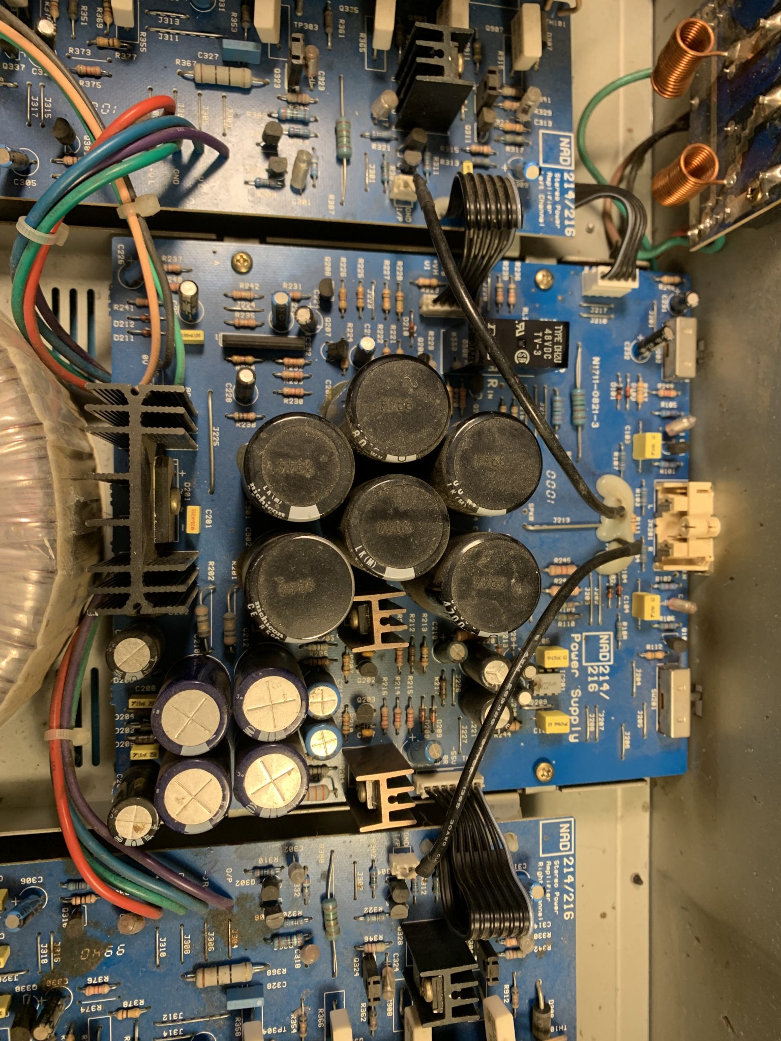

I’ve also included some pictures of the AMP and I found the service manual but once again, don’t know where to start.
View attachment 1205891View attachment 1205892View attachment 1205893View attachment 1205894

On R243 right end on schematic (you call it probably bottom) must be +67V, if not, there must be some soldering, jumper or trace error, +67V did not reach R243.
So after 20 days of "shipping" my parts have arrived, I have changed R243 and D213 to no avail.

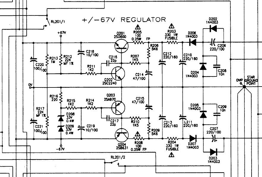

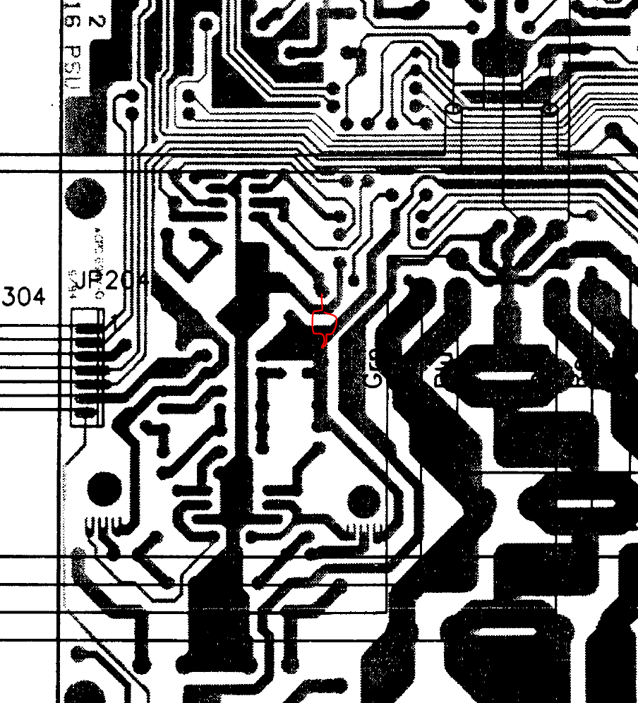

Now, @kaameelis you said that there might be a soldering, jumper or tracer error with the +67V rail at R243 but i just don't understand where the +67V should be coming from, in the schematic it is not shown. So I don't really understand what I'm looking for, I apologise for my lack of knowledge in this subject.
I've tried to trace it back and on D203 I get -57V and on D202 I get -500mv
On D201 on positive rail I get 59.4V and on negative rail -59.4V so D201 seems fine.
Yes, it is not shown on schematic, but I suppose it is easy to find on PCB, IC201 and IC202 are no needed to change. Find R243 on PCB and look where is going trace from this end what is not connected to IC202 pin 8. Before trace reache +67V there is somwehre break or bad soldering.Now, @kaameelis you said that there might be a soldering, jumper or tracer error with the +67V rail at R243 but i just don't understand where the +67V should be coming from, in the schematic it is not shown. So I don't really understand what I'm looking for, I apologise for my lack of knowledge in this subject.
It is possible that +67V regulator is dead. I not find in old posts you had measured +67V.
