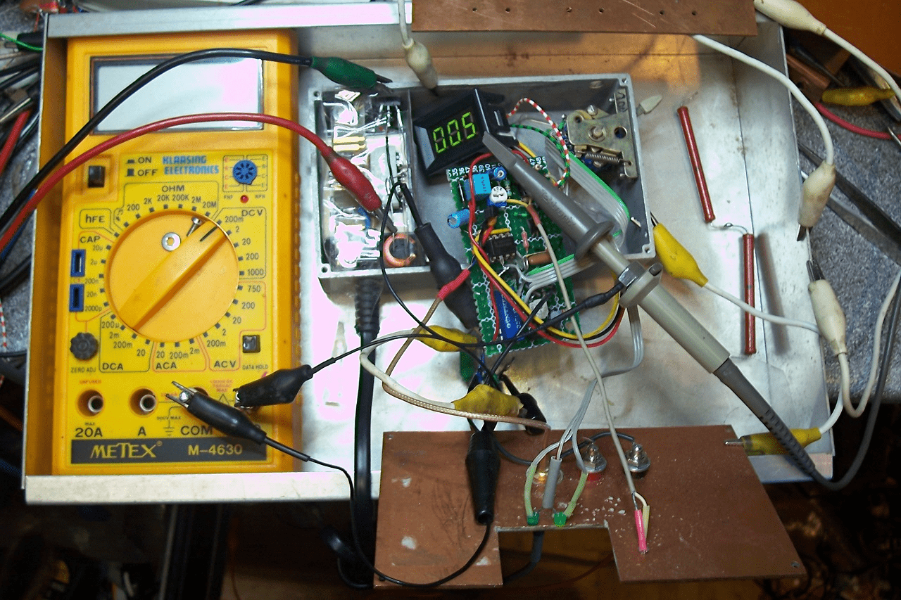

I use a battery-operated millivoltmeter having an input resistance of 10Meg as picoammeter, and I connect its COM terminal to the lowest impedance side of the loop I break.
The oscilloscope remains connected to the opamp output, and does not show anything abnormal, except an increased level of 50Hz hum. When the hum level is too large, I place GND-connected screens around the setup.
U1 remains in the range except with the 900M resistance connected: its output then goes to the +12V rail because it loses control.
On the previous ranges, the voltage is within the linear range, but quite low: for the 1nA range, the voltage is comparable to a BJT CCS.
I agree that something strange is going on, but I cannot pinpoint it. I have tried various method, like a cold spray, but the thermal shock sends the voltages all over the place and no conclusion can be drawn.
I have also tried to explore the PCB with the tip of a high-impedance millivoltmeter, to detect stray conduction paths, but triboelectric effects swamp the measurement

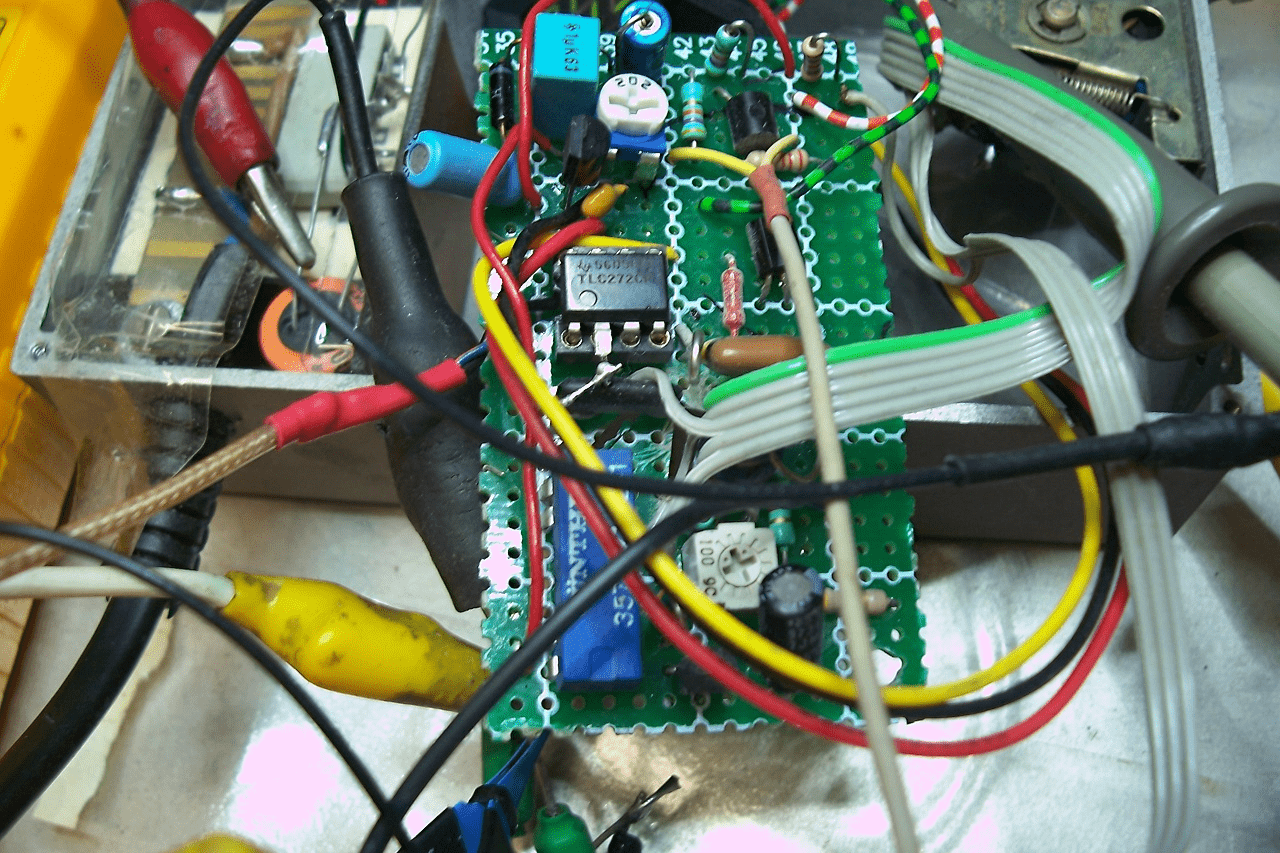

I made some progress: I notched the PCB deeper and further, and manage to scrape (litteraly!) a few pA, but the game-changer was the modification of the guarding scheme: initially, it was according to the outline of the first post.
I reasoned that the sensing node, seeing impedances of 100G was the priority. Therefore, I surrounded the drain of the MOS with the guard connected to the output.
I was a bit worried that the rest of the MOS was unguarded, but with only 1G on its source and a very small area, I didn't take any precaution.
Of course, a deeper analysis immediately shows that the source node is as sensitive as the drain, but with the SMD package and a perfboard, managing two separate guards seemed over the top.
But I realized it could be a problem, since everything else failed.
At first, I simply disconnected the guard under the MOS, and it did improve matters.
Then, I removed the conductor completely and milled a notch under the MOS.
It greatly improved matters: now, with the 900M resistor, the current is 50pA. Not yet the 100pA goal, but a great improvement compared to zero.
The next step will be the squeezing of the two guards under the MOS. Progress is slow and laborious, but it does happen.

Do you see any chance of putting a guard around the source and connecting it to the positive input of U1? Or to replace M1 with something in a TO-92 package?
