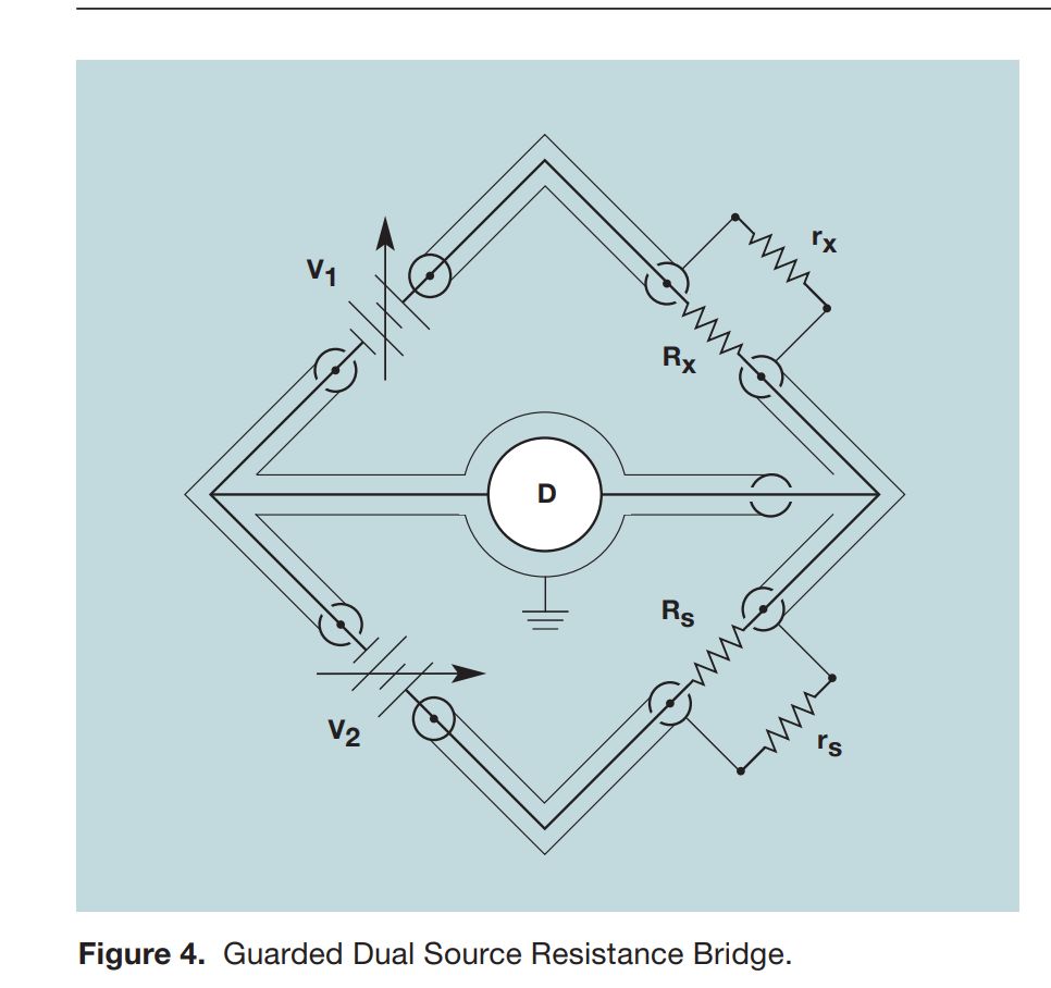

This is a schematic of a high resistance bridge at NIST. The guard circuit has nominal rx in the neighborhood of Rx.
An extreme example of guarding, but not very relevant to my situation.

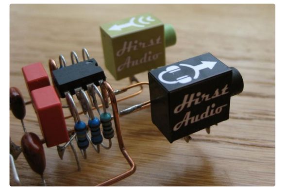

Maybe implement a no-PCB dead bug circuit such as this? Aside from zero PCB creepage, it is a work of art.
Indeed, it is an excellent way to eliminate parasitic conduction paths, and it would certainly have saved the day in my case, but stuffing such a work of art in a cramped enclosure like mine would have been difficult to say the least

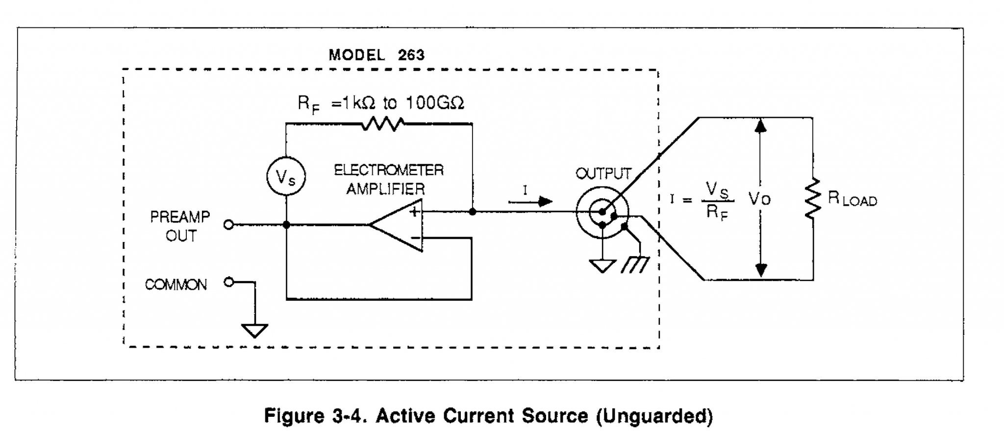

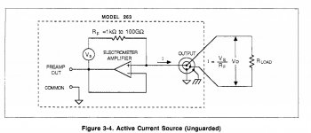

The is how the Keithley 263 calibrator (obsolete) creates a pA to mA current source. This is publicly available information. The op amp used is an OPA128. The DUT is ground referenced. The voltage source has ranges of 200mV, 2V and 20V.
I will give this a try when I can source the op amps.

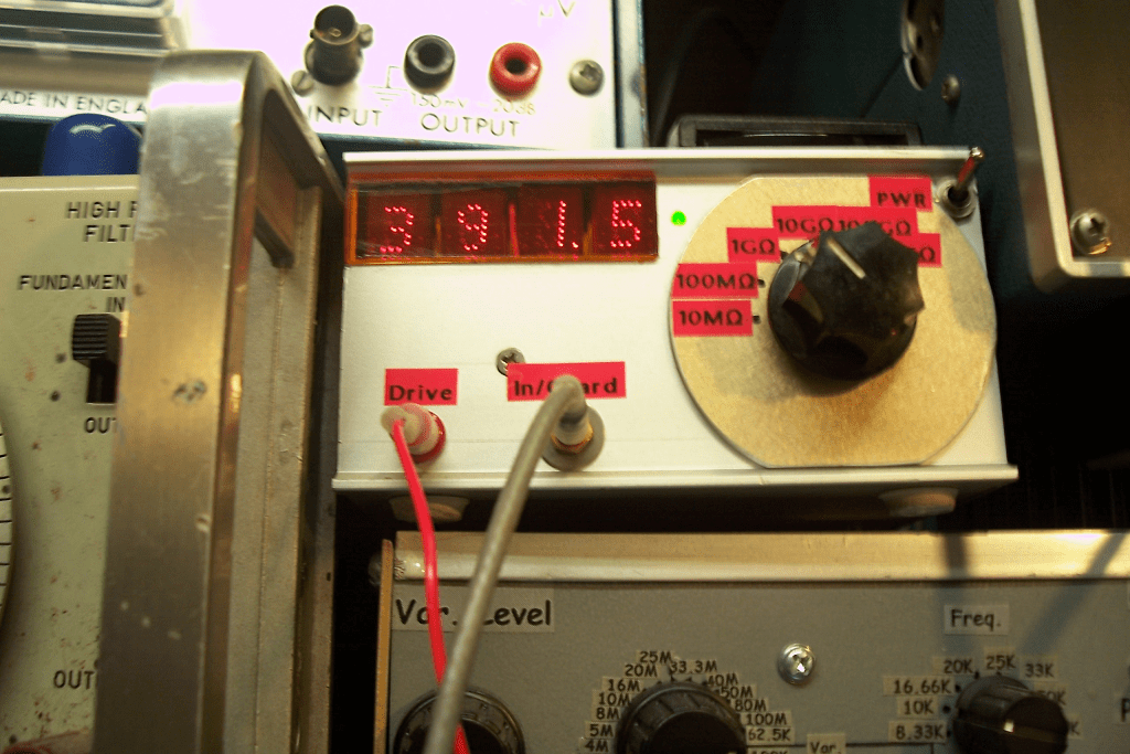

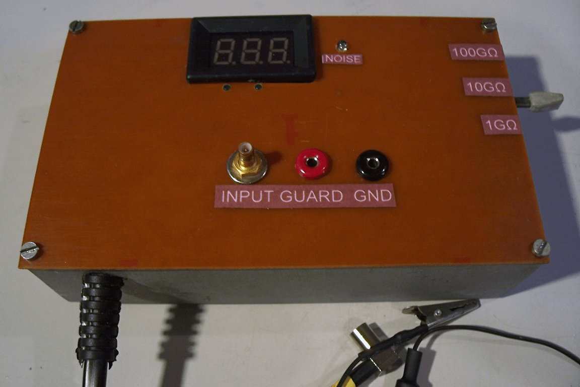

I have finalized the project:
For now, it looks reasonably stable; we will see in six months time. The accuracy is only 0.5 to 5%, depending on the resistance value: I wasn't maniac about the calibration, and anyway it is just a convenient, 3 digit workshop-type instrument, not a metrological device.
The common can be earthed, grounded or left floating (it is a class II device) which is very convenient when measuring earthed or bulky metallic DUT like a tank or a stationary device.
It has a guard terminal that can be used to float the DUT, and replicates the measured voltage=resistance, allowing a better resolution if required.
It is tolerant and easy to use compared to "real" instruments
There is still ~5pA unaccounted for in the CCS region, which I compensated with the current-setting resistor, but the rest looks pretty optimal: I made a test by first connecting the pico-ammeter directly in the foot of the input (that is GND side), then I inserted a ~80Gohm resistor on the hot side: the difference was in the region of 0.1pA, which shows that the output impedance of the CCS is more than high enough, and the input current/impedance of the follower is perfectly adequate.
I had tested these aspects beforehand, thus it comes as no surprise.
The TLC272 is not an electrometer-grade opamp, but selected samples can be quite good, and the pinout globally lends itself to this particular configuration, as there is a good degree of inherent guarding.
The PCB is heavily scratched/milled/butchered/notched, because that's where most of the problems came from, and if I make another pA/fA project (and I am going to make an ion chamber soon), that is something I will look at very closely.
The robustness regarding 50Hz noise is quite good, provided a minimum of precautions are taken: you can see on the pics that the "hot" terminal is a very short stub, meaning the DUT generally sits just above the front panel, which is made of copper clad connected to GND. The full scale voltage of 10V also helps (there is even a ~20% overrange margin)
As the input has its shield connected to the guard, an extension is perfectly possible without affecting the performances when measuring bulky or distant items.
The response time is reasonable, even on the 100G range: there is a 100K/82pF filter on the buffer input, but the charging time is acceptable.
Thus, for now everything looks good; what remains to be seen is the long term evolution: will the leakages remain stable?
