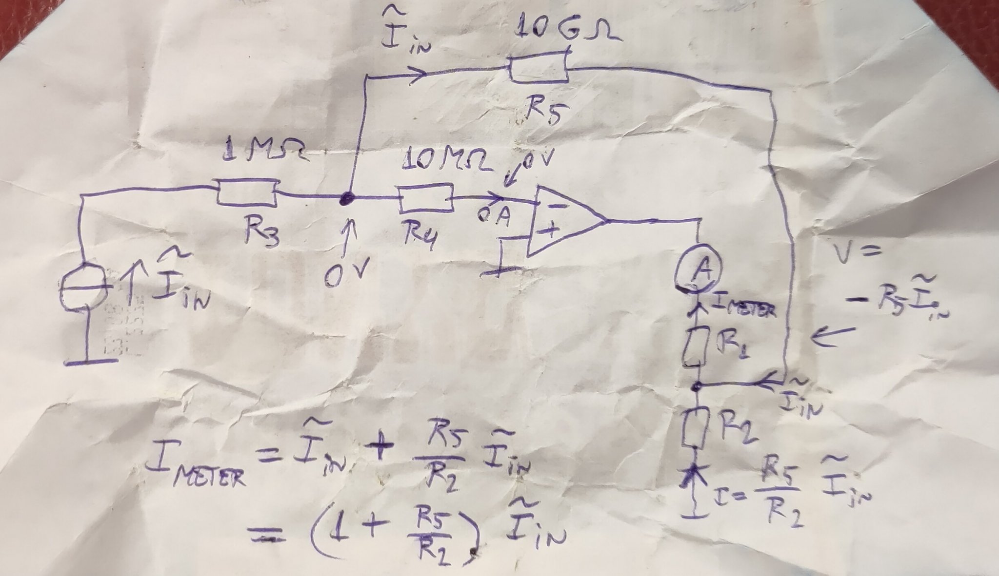

If I understand the intended behaviour of the circuit of post #13 correctly, its input is supposed to be a current input, so the lower the impedance the better. Then why put 1 megohm in series with the virtual ground?
The 10 megohm is straight in series with one of the op-amp inputs and should theoretically do nothing (except adding some noise).
All I could think of, is that the 1 megohm keeps things stable when you connect something capacitive to the input and that the 10 megohm limits the current through the op-amp input during overload or ESD discharge.
I overlooked it at first, but R1 has no impact on the current gain from the input to the meter. Maybe it limits the maximum current through the current meter, or it sets the gain if you also want to look at the op-amp's output voltage? You could connect a scope straight to the op-amp's output without any buffer.
As I said earlier, this topology allows a direct reading display on a cheap voltmeter module..

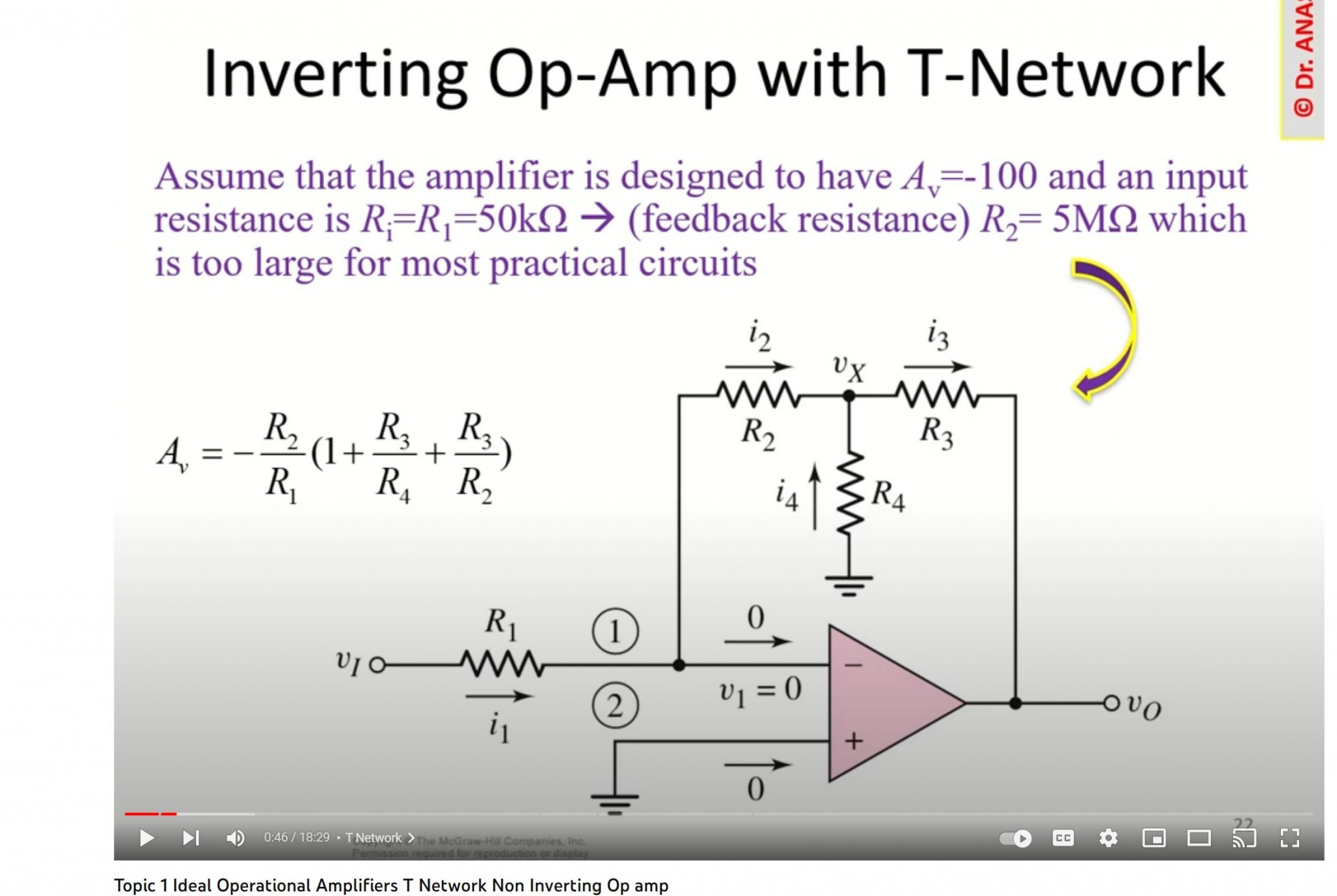

You should study basic op amp amplifier implementations. The T-network is a variation on ordinary op amp amplifier topology. The - and + inputs are virtually the same voltage and no current flows into either node for an ideal op amp. The output drives its node to make the + and - inputs the same voltage.If I understand the intended behaviour of the circuit of post #13 correctly, its input is supposed to be a current input, so the lower the impedance the better. Then why put 1 megohm in series with the virtual ground?
The resistors in the picoammeter circuit form voltage dividers between the input and the output such that current amplification is much greater than when not using a T network.
A T network can be used to create a faux 1 Terra ohm resistor using two 1 meg resistors and a 1 ohm resistor. It is an instructional exercise to make a spreadsheet to calculate the effective resistance for various combination of resistors. From inspection the input of this T network is a 1,000,000 to 1 divider. 10 volts in produces 10 uV across the 1 ohm resistor. The output 1 meg resistor creates 10pA from the 10uV across the 1 ohm resistor. Hence these 3 resistors behave the same as a 1T resistor.

I know that, but as the meter measures the current, R1 drops out of the equation - unless you also want to connect the op-amp's output to some kind of voltage measuring device, of course. The transfer from input current to current through the meter is simply 1 + R5/R2 when the 10 Gohm resistor is called R5, with the sign conventions as in this sketch.You should study basic op amp amplifier implementations. The T-network is a variation on ordinary op amp amplifier topology. The - and + inputs are virtually the same voltage and no current flows into either node for an ideal op amp. The output drives its node to make the + and - inputs the same voltage.
Hence my question about the purpose of the other resistors, R1, R3 and R4.

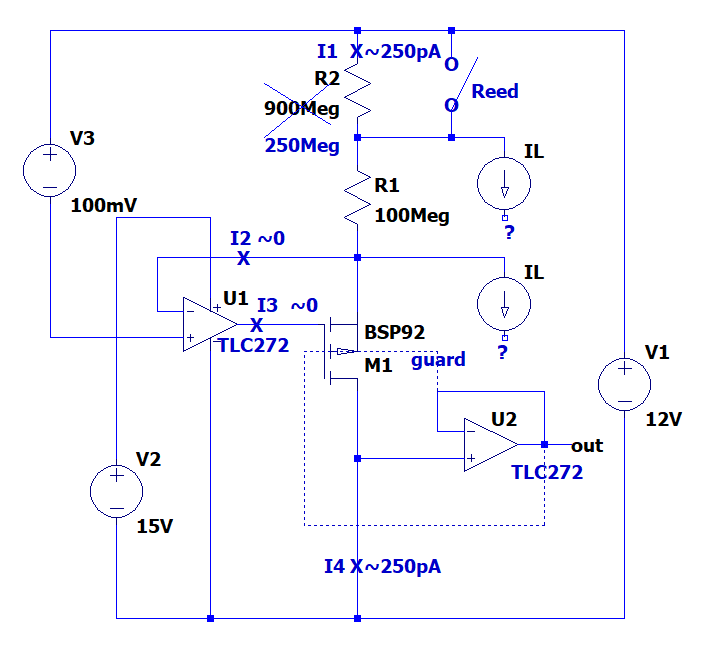

After some reflection, I have noticed an inconsistency in the values I measured.
This is the circuit in test mode:
IL are the possible unknown current leakages.
What is strange is that I1 and I4 seem to track quite closely: with R2 at 250M, the currents are almost identical, ~250pA.
With the resistor at 900M, they both fall to zero.
That's not logical: if IL steals some current from the source node, I1 will remain the same unless IL is much too large. However, I4 should decrease by IL, but it doesn't, and I cannot find a satisfactory explanation. The circuit behaves more or less as if the 100mV reference was reduced, which it isn't of course, it comes from a low impedance and is rock-stable
One thing is certain: the problem is caused by leakages, since cutting through the FR4 improved the situation

How do you measure these currents? Are you sure both op-amps are stable for all combinations you tried? Does the output voltage of U1 go outside its specified range? (It shouldn't, but clearly there is something happening that shouldn't happen.)After some reflection, I have noticed an inconsistency in the values I measured.
