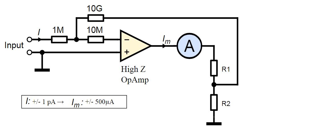

A short update: the instrument has been finalized and calibrated a little more than one month ago, and I have checked the stability of the calibration.
As expected, the 1G and 10G have remained rock-solid, and the 100G has somewhat drifted, but surprisingly not in the expected direction: the 100pA measurement current has increased to 102pA, which means that the circuit has improved.
With the nominal values, the current was only 95pA, because 5pA were lost somewhere. I compensated this loss, but now it has been reduced to 3pA.
I will continue to monitor the evolution from time to time.
The instrument stays in my lab, where the temperature and humidity are practically constant, and the enclosure is almost airtight, meaning external influences are minimal
