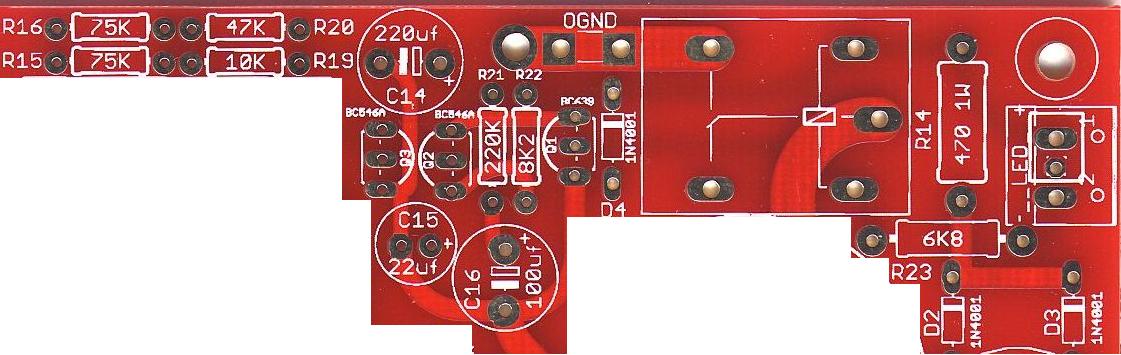

Troubleshooting help needed
I have put two kits (one stereo) together.
I have made nice replaceable resistor dip-pin based sockets.
(I will post pictures later
One channel the relay clicks on. The other does not.
Re-checked all solder joints, nothing seems wrong.
Can someone give me a clue how to start trouble shooting? I don't want to blow the nice parts!!!
Michiel

You have two boards, one working and one not so you can use the comparison method to troubleshoot. The attached image shows all the parts in the relay circuit. Compare the two boards - are all the part values the same, capacitor and diode polarity the same, anything different about how the parts are placed? If you have the LED connected on the bad board, does it light up? If the trouble is not yet found measure voltages starting at D2 and D3 and work your way through the circuit until you find a large difference in the readings between the two boards. That should localize the problem to a few components.

Follow Bill advices, they are straight explained. Compare voltages between these 2 boards in all the components of the relay circuit, and then you should see where is it failing.
Regi
