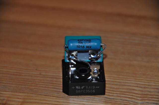

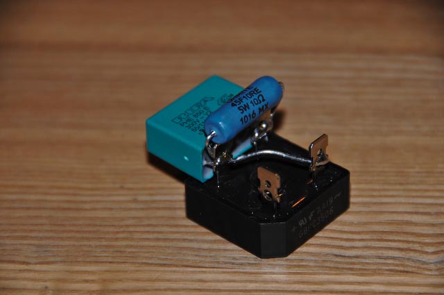

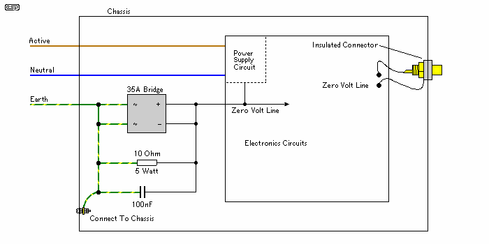

Questions about ground breaker
I have built a ground (loop) breaker Like the one Regi suggested from the ISP site Earthing (Grounding) Your Hi-Fi - Tricks and Techniques .
1) I don't understand how this device works or how I can test that it is working correctly?
2) I read that I should have used crimped connectors rather than solder, I understand the thinking here, but is it really necessary?
3) I should use one for each channel?
Can someone kindly point me towards a method to test this device and perhaps a little reading which might help me understand the principle of how this works? I have two decent DMM's, a dc bench supply to 32 volts, a variac, (and isolation transformer), and a bulb tester.
I don't understand how the amp works either but I can test that with my ears...this is a safety issue! I want to be sure my grounding is secure.
Bill
