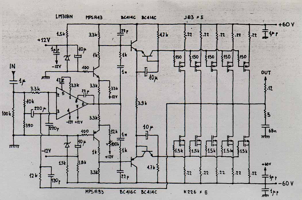

I am quite unhappy with the choices for C9 and C21 values. I expect to do a lot of swapping here after I hear the standard version.
What would you have placed instead of a Blackgate? And for C21, yes, we could have placed some film and foil or polypropilene.I am still assembling.
A jury rigged, uncased version may be running at the week end.
C21 was supplied as type FKP2, a film and foil polypropylene.
Comparing the impedances of C9 and C21 at 10 kHz, C21 is 7200 times higher (77dB) so how can it influence the sound at all? At lower frequencies the difference is 10,000 times.
Andrew, I am curious about what is wrong with the value of C9 at 220uF.
Have you actually measured it? It is a very interesting fact that already hasn't arised...C21 was supplied as type FKP2, a film and foil polypropylene.
BTW, my apologies about the C21 cap assumption. A big slap in my face...
If you are asking have I measured the capacitor impedance, yes the graphs are in one of the PDF files I posted a while back.
My comment about the FKP2 was not intended as a slap, just a gentle correction.😀
OK, now I can remember reading your capacitor graphs when I was on the bus 😀

The issue isn't the total capacitance of C9 and C21 in parallel, theoretically one could compute just using formulas and see C21 doesn't have a profound effect on the circuit.
I think the idea is that the bigger cap is electrolytic and has some real life downsides that may be audible but bypassing it with a better quality cap negates some of this. YMMV.
Right, the issue is not the total capacitance, rather it is the comparative ratio of the impedance each capacitor provides to the total current path. Stated another way, 99.99% of the signal current will flow through the Black Gate capacitor. Maybe you can explain how a small capacitor passing 0.01% of the signal can negate shortcomings in the larger capacitor.
The C9 value comes directly from the Musical Fidelity A370 that inspired Mauro Penasa.
Sure it would be great if there's a way to reduce it to 10-22uF so we could manage to use a film cap. 😎
In the MyRef Evolution Mauro fixed the problem using a DC servo instead.
Regarding C21: the value is strange, I agree, but I've tested several values and 22nF was the only that seemed right. (see: post1, post2, post3)
But that was with standard elcos, Black Gates usually works better without bypass...

I don't know a better cap in 5mm lead spacing...😉
And nevertheless it does... see the three posts I've linked.

I didn't expect an explanation for the 0.022uF capacitor because logically it doesn't make sense that it should help. That said, it was part of the kit and I mounted it to the card with the rest of the parts. If it doesn't help it shouldn't hurt either.

C9 and C21 is a complicated topic, but, based on Bill P's findings and Andrew's and Regi's points, I think I see a resolution.
Mauro's original design did not have any bypass cap for C9; there was no C21.
C21 and most of the other bypass caps were added by Russ White of Twisted Pear when he designed these boards for sale to DIY'ers.
After I built my first amps and started experimenting with different components, I noticed a strange distortion on female vocals and some instruments. It sounded like a weird, out-of-phase kind of thing, very fleeting and subtle, but real. Dario was experimenting at the same time and recommended a certain cap for C9. I tried that and the distortion did not go away; it might have gotten worse. Dario recommended the current small value for C21. I tried that and the distortion went away. At the same time, I replaced C9 with a Blackgate. The sound became beautiful, no other way to describe it. I had made the rookie error of making two changes simultaneously, so I never was certain that the distortion was caused by C9, or by the interaction of C9 with a larger value C21. I was never completely satisfied with the small value of C21, but my amps sounded so good that I quit experimenting.
I now believe that C21 is such a small value that it has very little, if any, effect on the overall sound of the amp, other than that it might have no effect at all. Perhaps Mauro's original design was the best (as we have determined again and again). Bypass caps are always a tricky affair, and perhaps the best bypass is none, especially directly in the signal path.
A larger value C21 would probably introduce the same distortion, no matter how "good" a cap is used for C9. I believe the quality of sound from this amp is the result of the quality of C9, the Blackgate. That might sound like voodoo to you tech guys. Prove me wrong, and we'll all be richer for it: no more $7 caps at C9.
Simple experiment: leave C21 out and listen. I'm not gonna do it first.
More complicated experiment: different C9's. Been there, tried that. Blackgate's are legendary for a reason. I wish someone could make them again, or something else that sounds as good.

it will develop a small value of AC voltage across it.I am curious about what is wrong with the value of C9 at 220uF.

Can you explain why does it develop a voltage?

The input cap passes frequencies that will develop a voltage across the feedback cap.
That combination of 2u2F Obligatto and 220uF Black Gate guarantee that.
Reducing the input cap to 1uF gets close to filtering the problem LF, but why pay for 2u2F Obbligato and leave it in the packing?
Maybe add 75k//100k (Rin~43k) to make the input filter more effective.
Or double up the 220uF BG with a cheap 220uF, or replace with a 470uF or .... , there are many options to prevent AC across the feedback cap.
