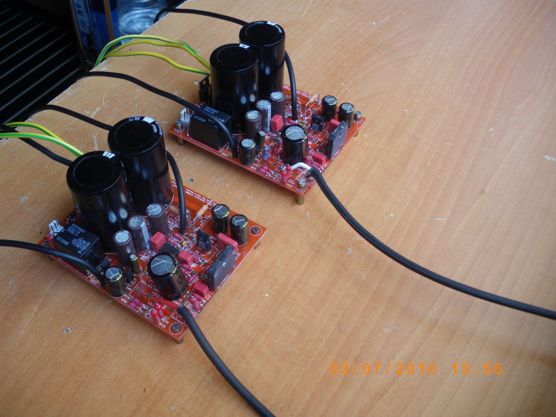

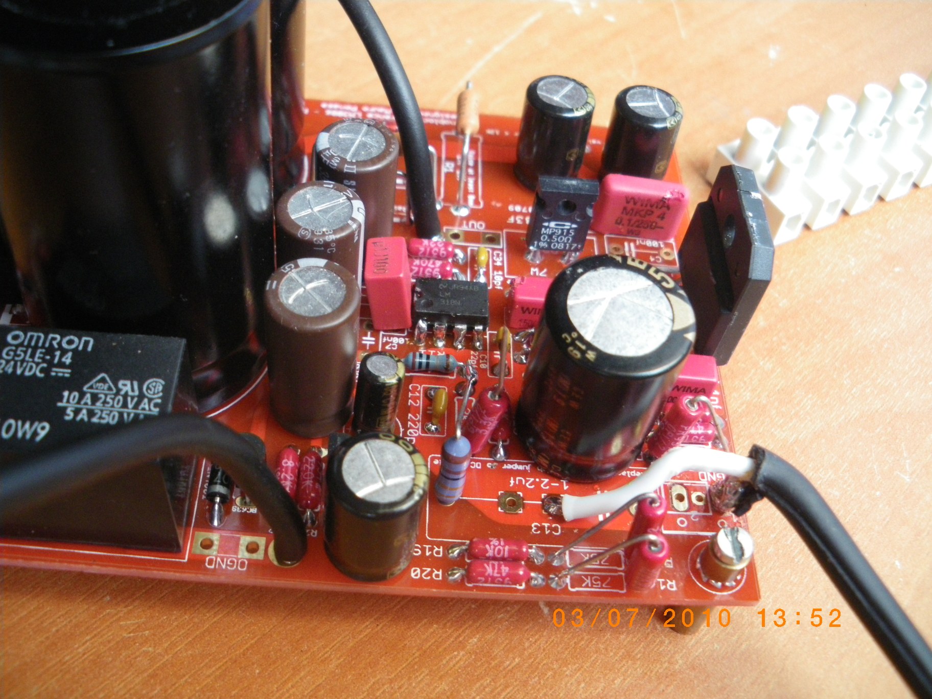

I'm only using the terminals for the power input, not for the speaker output. The cable end is no problem, I've got good crimping tools.
I've finally managed to solder the terminals to the board. Found some old 60/40 solder, worked perfect without extra flux or sanding/scraping of the terminals. Seems the coating on the terminals didn't like the 2% of copper in my other solder.
I have done that with the output and the ground to the speaker, but for connecting the trafo I have soldered three terminals. Not that I am using them, but they are soldered. There are holes enought for soldering the cable and APART from that, soldering the terminals too. They can be used to hook up test probes.Don't use the terminals. Solder wires directly to the board, especially the outputs. Think about how often you will want to disconnect/reconnect anything. Problem mostly or completely solved, and better sound.

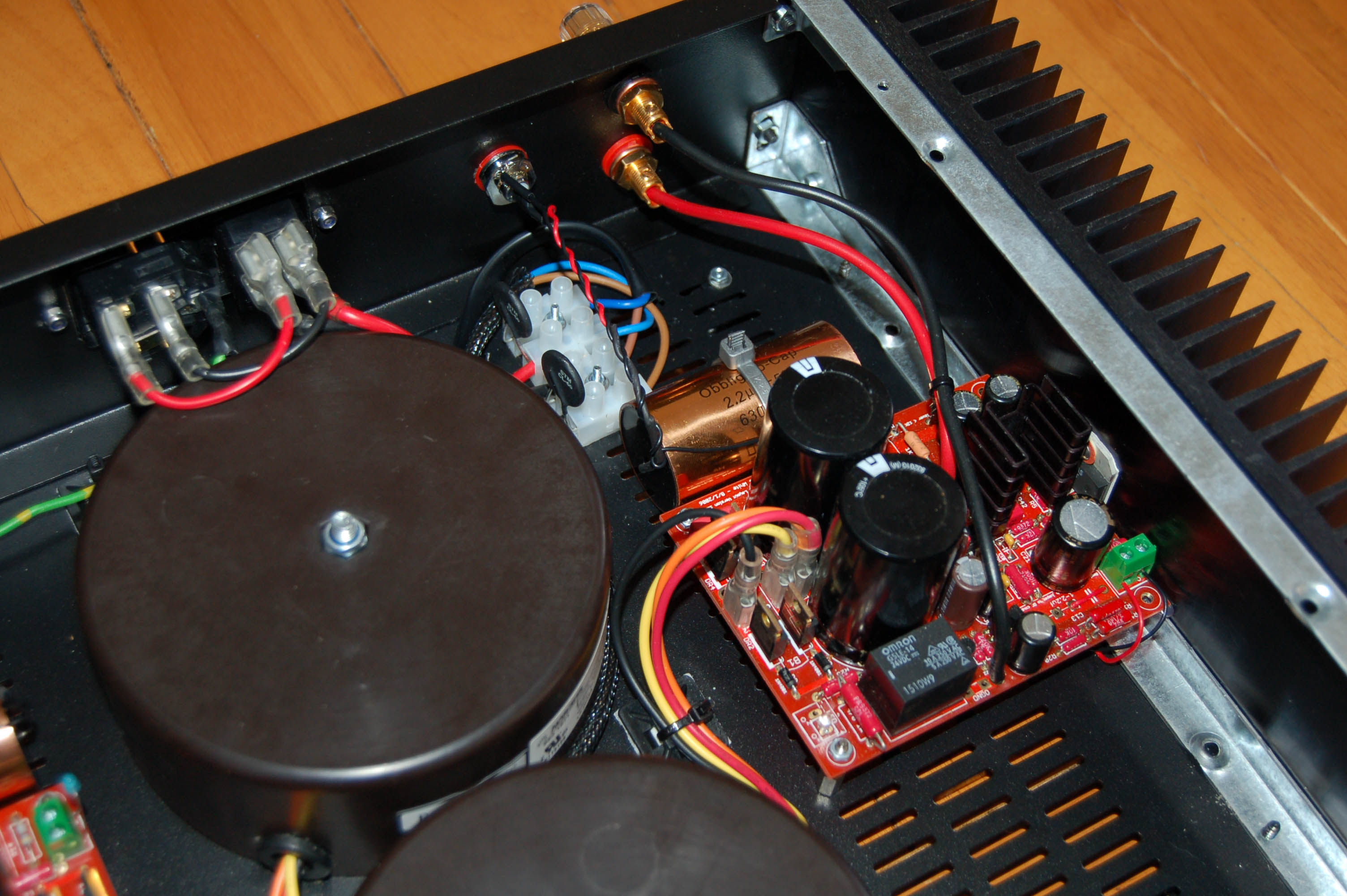

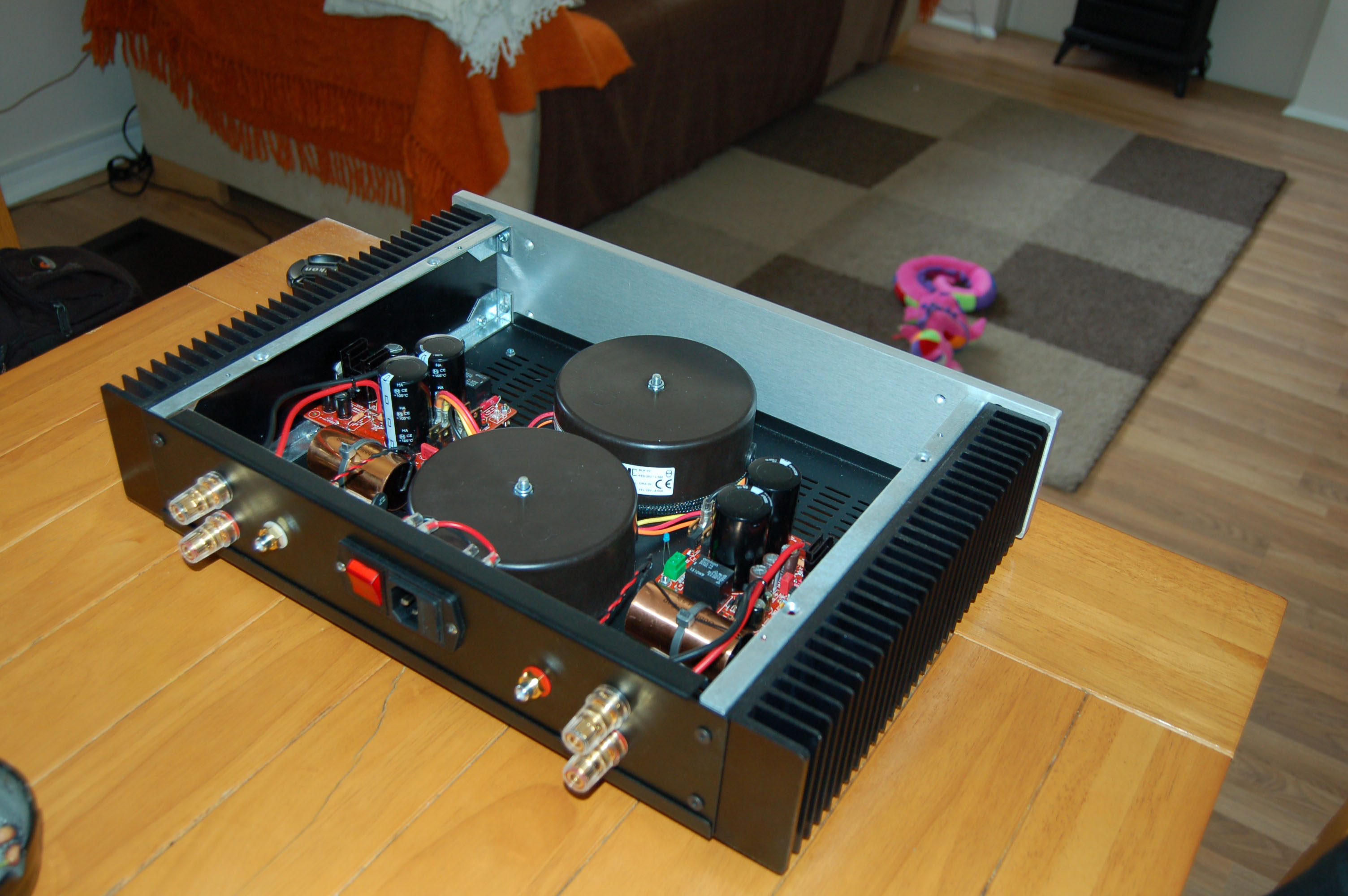

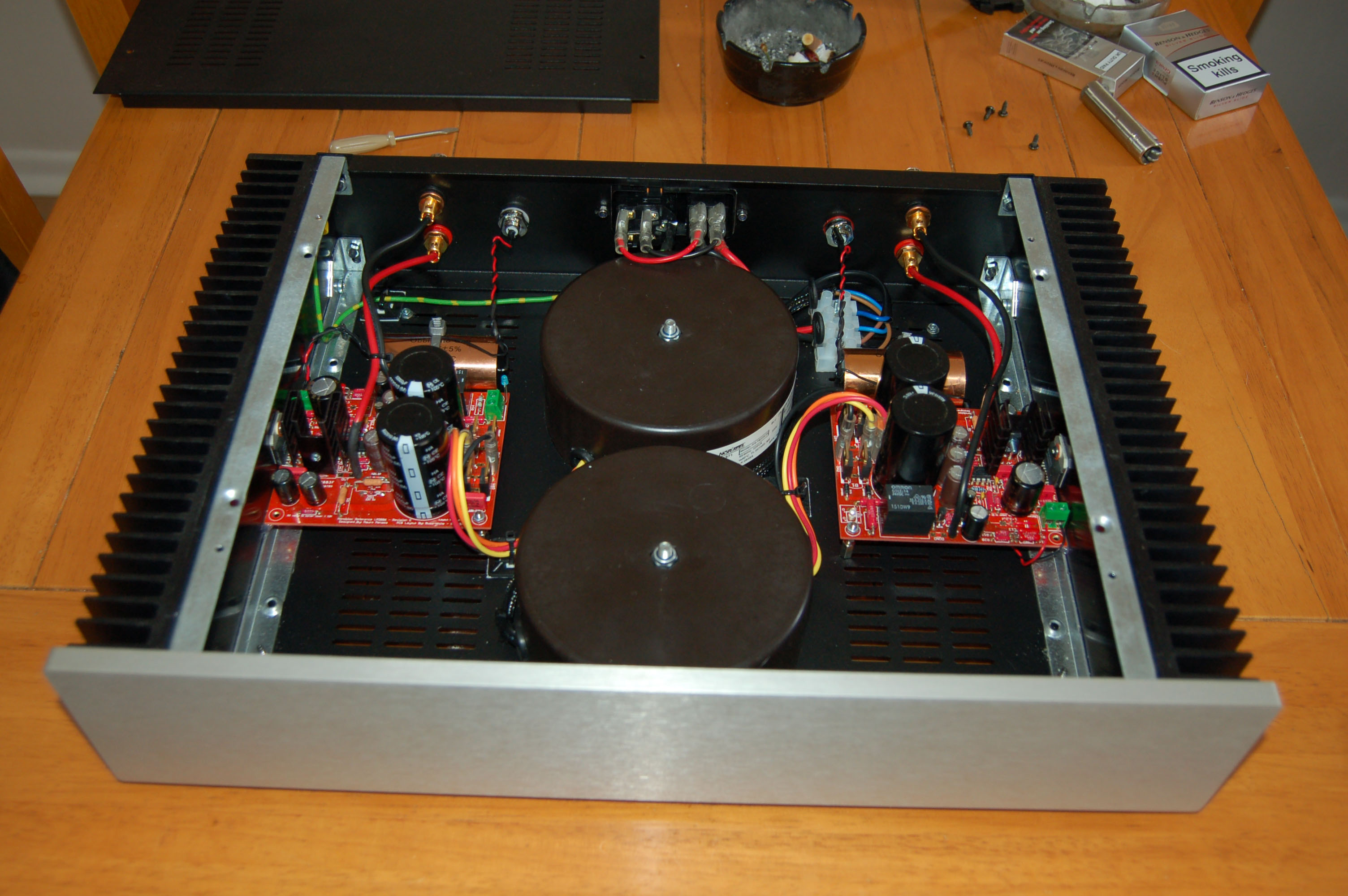

(Glad to see you caught the channel indicator issue)
I searched for this with no joy. Could you elaborate, please?
In your second picture you had the right and left RCA insulators backwards. Looking at the back side of the amp the right channel should be on the left side so the speaker leads would not have to cross at the back of the amp.
But in other pictures (1st, 3rd and 4th) the insulators were correct so I "assumed" you caught that and corrected it.
But don't let that distract from the first comment. Beautiful execution. VERY well done.

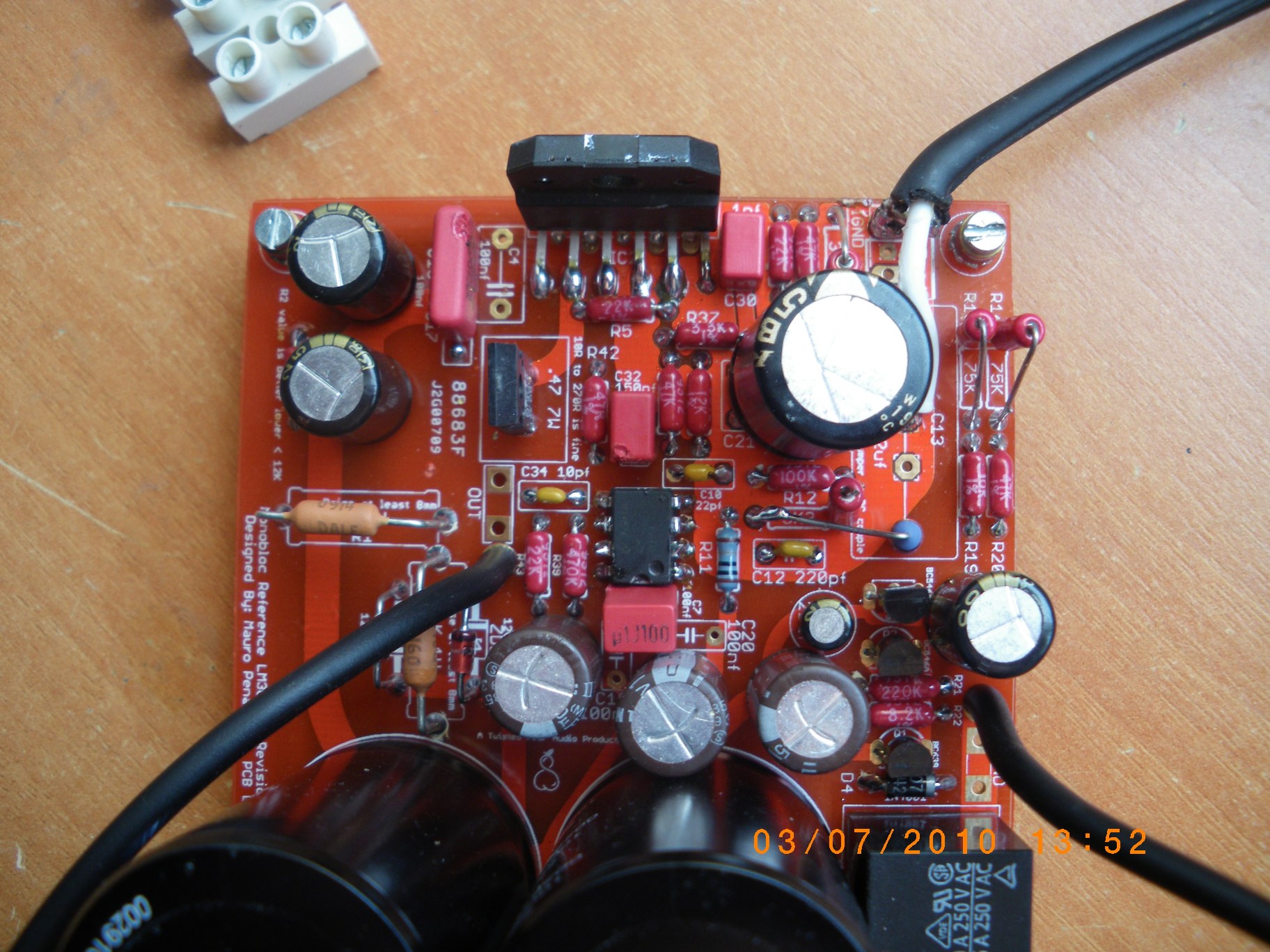

Regarding another matter, I have placed the tantalum resistors. I was able o put in the 3k3 input ones not without difficulties. They lead pitch is bigger than the holes in the board, so I wasn't able to try the 390r.
You can see how I managed to place the 3k3 resistor. Using one of the bigger holes of the input cap and a bit of the older resistor's lead.
I will post listening results as soon as I hook it up
