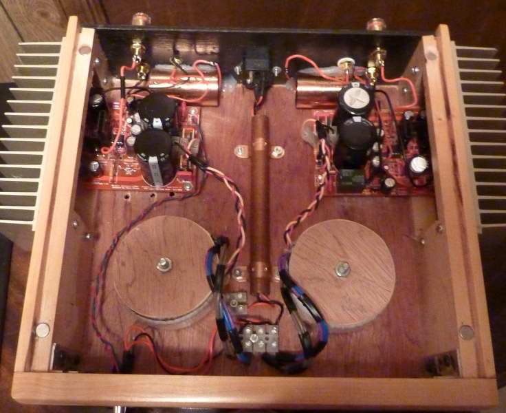

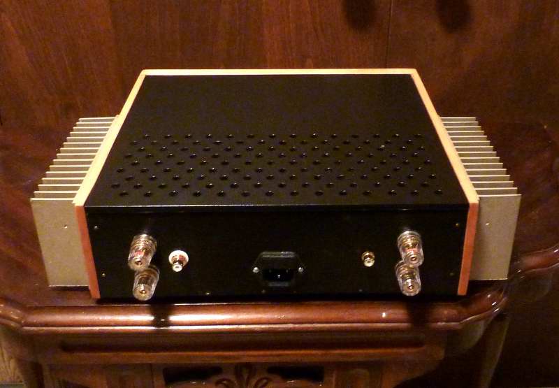

Hi Guys
Another RevC dual mono is born. I finally finished things yesterday, got 2 mv and 0.5 mv DC offset, not bad. Hooked it up using an old Marantz 1060 as a preamp, sounds very clean and smooth. Now I need let is burn in a few days and will use a SKA pre with a LDR pot to compare it to my old original Twisted Pear RevC. A fun project, thanks again for your efforts Uriah. Some pics below

Nice build PJN, I like the wooden finish and the wood supporters for the transformers.
