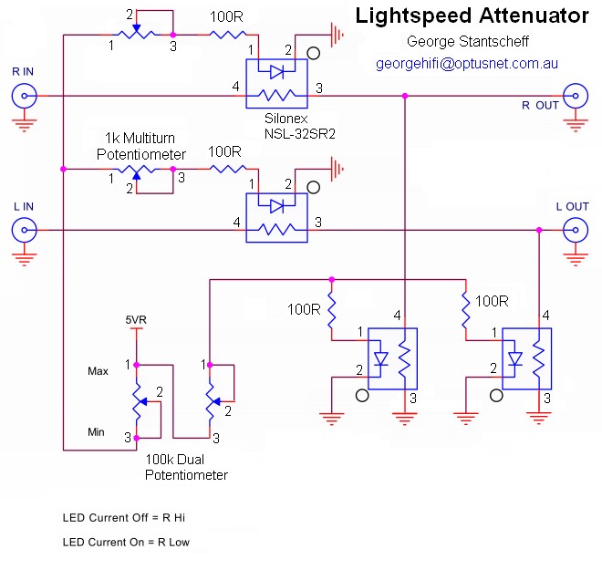

MyRef_C with integrated Lightspeed Attenuator
Another thing. I obviously sell LDRs to build the Lightspeed. I have some LDR Mount and Balance boards I sell for $8 and matched quads of LDRs I sell for $35. Normally I charge 10 shipping worldwide for any order. For anyone buying in this group buy: If you want to build a Lightpseed all you need is the board/LDRs/100k pot/ 5VDC supply. I will include the LDRs and Mount and Balance board for a total of 30. You dont have extra shipping or extra 13 you would normally pay. So saving about 23 from purchasing some other time. I will also supply the 5k pot, 200R trimmer, 4 limiting resistors free of charge. So thats another 2 dollar or so value.
I just added a column to the spreadsheet so you can place order for the LDRs, etc by marking YES or marking the number you want if you want more than 1 set.
THATS the real Ultimate BOM.
Uriah
As Uriah points out, he's offering the Lightspeed Attenuator with this group's buy kit at a really reasonable discounted price. He is including the LDRs, the boards, the resistors and the trimmers for 30$. A nice deal for controlling the volume. You only have to put a 100k dual pot and a +5vdc supply.

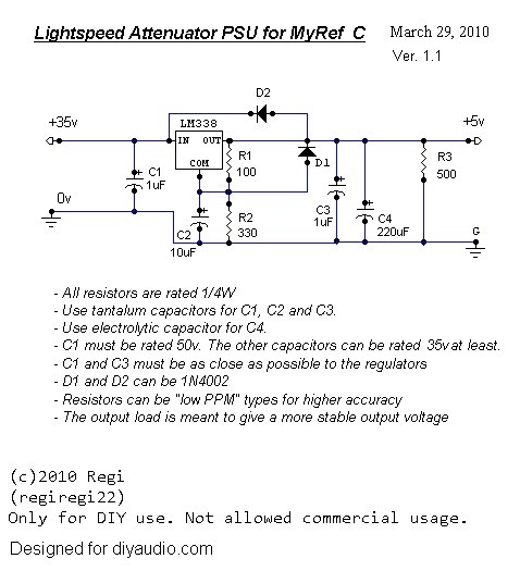

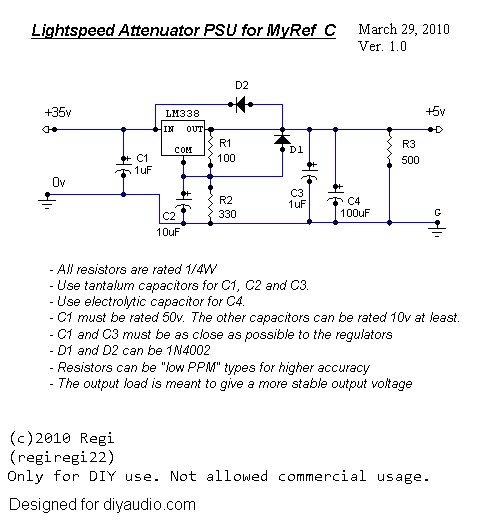

I am going to explain how to integrate the supplied kit with the MyRef_C using his PSU:
We will tap the +35vdc from the already rectified and smoothed out from the My_RefC PSU. You can hook up a pair of wires to the solder side of the big 10.000uF caps, this is a clear/easy place to solder. These will give us around +35vdc, so we will step it down to +5vdc using an LM338 regulator. We could use the lower-current-rated LM317, but Uriah told me that LM338 is more stable, so no place for discussion with the small price difference they have. You can mount this circuit on a little piece of stripboard or veroboard. You can even mount it point-to-point if you have enough care.
Here are some technical explanations, not necessary to succesfully build the circuit:
-An output load resistor makes any regulator happier 🙂 It keeps a constant load all the time, which turns out to give a better steady voltage. The LM338 datasheet says that it has a minimum load current ranging from 3.5 to 10mA, so a 500 Ohm resistor will suck 10mA. Plus the Lightspeed consumption, it will be enought current. R3 is using 50mW, so a 1/4W resistor will suffice.
-R1 is 100 Ohm to allow pass a 12.5mA adjustment pin current. Everywhere is recommended to put there at least 10mA. With 1.25v it consumes 15mW, so an 1/4W resistor is enough.
-R2 is 330 Ohm. I don't know how to calcule its consumption, but I know that you need a 1/2W resistor if you go above 1.6k having R1=100. SO we are fine with a 1/4W resistor.
-C1 and C3 are bypass caps, which improves regulator performance. C2 improves ripple rejection. C4 is there to provide some output capacitance and doing a bit of post-filtering, like C3. They have to be tantalum types (or even film types) because of its high-frecuency response.
The only one cap that needs to be 50v is C1. 35v would work, but too tight for long-term endurance. The others can be anything above 5v or 10v.
-D1 and D2 provide protection in case that the currents from capacitors return back and damage the regulator. 1N4002 or 1N4003 are enough.
-Uriah suggested me to use resistors with a low PPM. That means to have a low thermal drift. Output voltage will fluctuate less due thermal variations. But, in practice, with a more or less steady power consumption, this is not a big deal.
-I would go with metal film resistors because of its advantages, but it goes down to personal choice.
This circuit will provide you a first-class regulated +5vdc supply for your Lightspeed or anything else you want. You can even hook up a LED to ensure that it keeps working. The regulator will get a bit hot because of the big voltage drop, but not too much because of Lightspeed's low current consumption. You will have to attach it to an small heatsink, or to the same heatsink as the LM3886, but making sure that it's well insulated from it.
Building the Lightspeed attenuator with Uriah's matched LDRs should be trouble-free. It should take no more than a square inch veroboard. But with the supplied kits, boards are included. Hook it up to the regulated PSU and you're done. The PSU shouldn't take up more than an square inch board.
Attached files are my PSU schematics and Georgehifi Lightspeed Attenuator.
Please, comment any flaw you experienced DIYers see, any recomendation, comments, objections or insults. If we work together, we can develop the perfect partner for our Ultimate MyRef_C 😀

Regi - differences- the improved power supply, the ability to select your impedance, the ability to balance from left to right, the current source, it just flat sounds better. I am not sharing the schematic until I come out with the microcontroller edition so lets just leave it at that with the schematic. Here is one man's opinion

Regi again, Your post is correct in nearly every way. I would use higher voltage caps on the output of the LM338 and I would use a pot for R2. Changing voltage gives the option of changing impedance but now the resistor values on the mount and balance board must change to protect the LDRs. Each participant would have to make sure their LDRs dont dive below 40-50R at min/max volume. As long as that precaution is taken nearly any voltage will do. I personally dont go over about 15V. Maybe sticking with 5V like you are suggesting would be best for the most people. Easier for us to so that there is not a new explanation of the same question every day.
I would use a decent heatsink on LM338 as this is one of the big reasons that circuit is so stable. Decent being something like this Digi-Key - HS380-ND (Manufacturer - 530002B02500G)

So many thanks you Uriah for your response. I am actually wondering if is it essential for the lightspeed to have exactly +5.00v supply? If not, we don't really need a trimmer. My resistor combination will produce 5.37v. We will need a trimmer to down it to 5.00v ONLY if tolerance of the lightspeed is quite tight. It's a way to reduce innecesary costs. What are your thoughts about that?
Are 220uF enough for the output? Shall we go for 470uF?

I have just changed the voltage rating and capacitance value and this is the new schematic.
I hope it helps most of the builders to make a really nice integrated amplifier.
