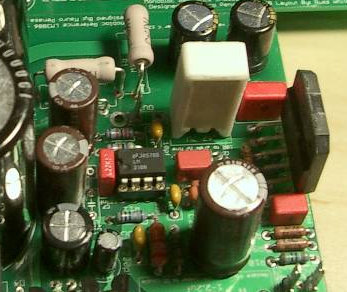

Regarding C13: remember that is does not need to be 2.2mfd. The amp will function perfectly and sound very good with a slightly smaller cap, which would help save money and space.
Dario, I am willing to give the Silmic another try when I have extra amps and boards to experiment with. I am quite pleased the kits will include Blackgates, and I would be interested to learn your opinion of them.
How are the varistors working out? Can you give us a part number? The link you provided gave a Maplin part number which means nothing to me. Would this be an item worth including in the kits?
You're right Tom specs for the input cap are from 1uF, in fact quite all caps I've tested are between 1 to 1.2uF.
It seems that sound is not affected and they reduce/eliminate spikes quite well at least the majority, some (minor) spike pass.
Probably the selection of the varistors could be better done but I didn't found any information on how to select them...
I'm going to try Varistors to try to stop spikes (Mouser 94-2381-592-52516 <220V> or 594-2381-592-51316 <110V>), I will report in the next days.

Its hard for me to give a impression because I have not listened to any other capacitor in this position. Overall, I'm very pleased with the amp. I'm using it with a Lightspeed pre-amp driving Jim Griffin Jordan/Aurum Cantus speakers.
I've brought the combination to several DIY meets and everyone has been extremely complimentary.
With regard to the input cap... I'm using an Obbligato.
Which Obbligato are you guys using? I asked for quotes on the copper and the gold premium but there is also the black premium and the tin foil.
This one
With this model, I think we could step up to 1,5uF. The 1uF costs 8€ and 1,5uF 9€. But for 2uF you have to step up to 12,5€. Just to aim for a bit more lower extension.

I've suggested Obligatos as the best price/performance ratio caps that let perceive the good that our mods give but my reccomended cap for this amp is the Mundorf MCAP Zn 1,2uF 250V.
Let me be absolutely clear: among the various caps I've tried Obbligatos and MCAP Zn are the only caps similar to DC coupling.
Both let pass through quite all details with MCAP Zn best for a perfectly transparent timbre, Obbligatos add a bit of very nice 'analog' colour.
Regarding bass slam I think you'll have a nice surprise from Silmics in C6/C11... in this regard Nichicons KZ are even better but overall I've preferred Silmics.
So we should try Silmic's in the power supply? I'm willing to give that a shot. They do have a nice bottom end. Do C6 and C11 affect the sound very much? I haven't tried anything there other than the Panny FM's. The price difference for Silmic's is not too much. Do they fit? Things get really tight on the board in that area.
