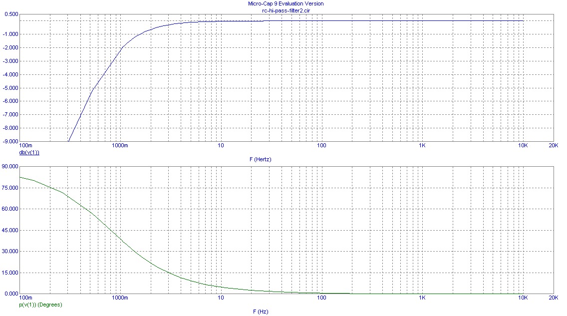

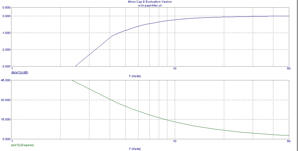

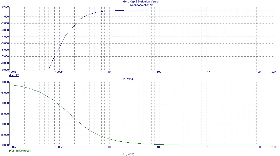

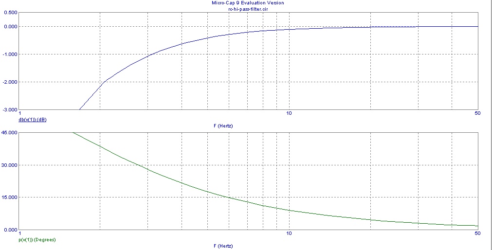

I have spent some time (gratefully financed by my boss) to made a pair of simulations with 1uF and 2.2uF. At 20Hz, attenuation is null on both, far less than 0.1dB. What goes a bit down is phase distortion. Have a look at them.
I need to make ones later more focused in 20Hz and above, to see better the differences.

I can't say with any certainty what effect the two sizes will have. My input cap is 0.68, and I think that is too small for a full range amp. The lowest bass gets a little sloppy, although it's still there and sounds okay. The only advantage of a smaller value cap, if not cost, is size. Both offer a low enough cut-off, but the larger cap will provide lower phase distortion. If your speakers (and music) really go down to 20hz, the larger cap is needed. I always intended my amp to be used only for mid and high frequencies, with a more powerful amp for bass, so a smaller cap means nothing significant is distorted. When run full range, they suffer somewhat on organ and lowest bass notes.

I have made a closer look comparison between 0.68, 1 and 2.2uF in the attached files. There are clear differences in phase between 0.68 and 2.2uF at 20Hz and above.
