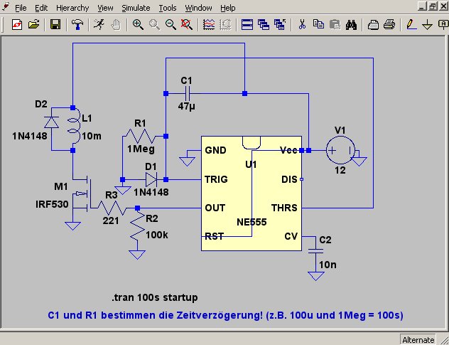

Or........try this one. Note that the author (in German) is stating this is a 100 second delay circuit. The delay is determined by the values of C1 and R1.... You can use the NE555 techsheet to determine C1 and R1 values for a more useful delay (say, .2-.5 seconds). This circuit is "nifty" since it also incorporates a mosfet as a driver for the relay. You should be able to drive multiple relays (or one hefty industrial relay) with this circuit.

Or........try this one. ..... You can use the NE555 ............ This circuit is "nifty" since it also incorporates a mosfet as a driver for the relay. You should be able to drive multiple relays (or one hefty industrial relay) with this circuit.
the statements made by Can Am do not recognise the "problem" as specified in my post..................And you effectively end up with a resistor (R1), charging a capacitor (C1)through a diode bridge, with the capacitor slowly (in relative terms) reaching a delayed voltage to trigger the relay. Ergo, this is effectively the simple RC network delaying operation of the relay that I had talked about earlier.............
A simple RC does not work well.
A 555 uses an RC in a circuit that is designed well and performs well as a timer.
One can mimic the 555 timer action of the RC, using discrete.
The post shows the relay and mosfet switch powered from the same supply as feeds the 555. The relay and mosfet can be fed from a separate supply selected to drive the relay rather than to not overload the 555.
