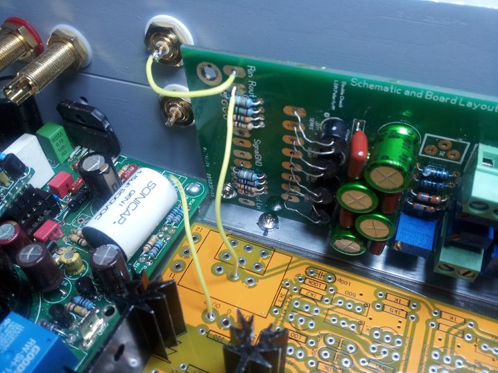

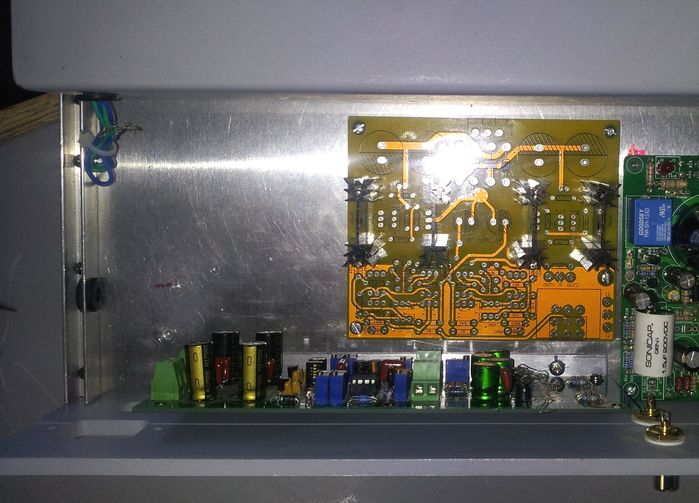

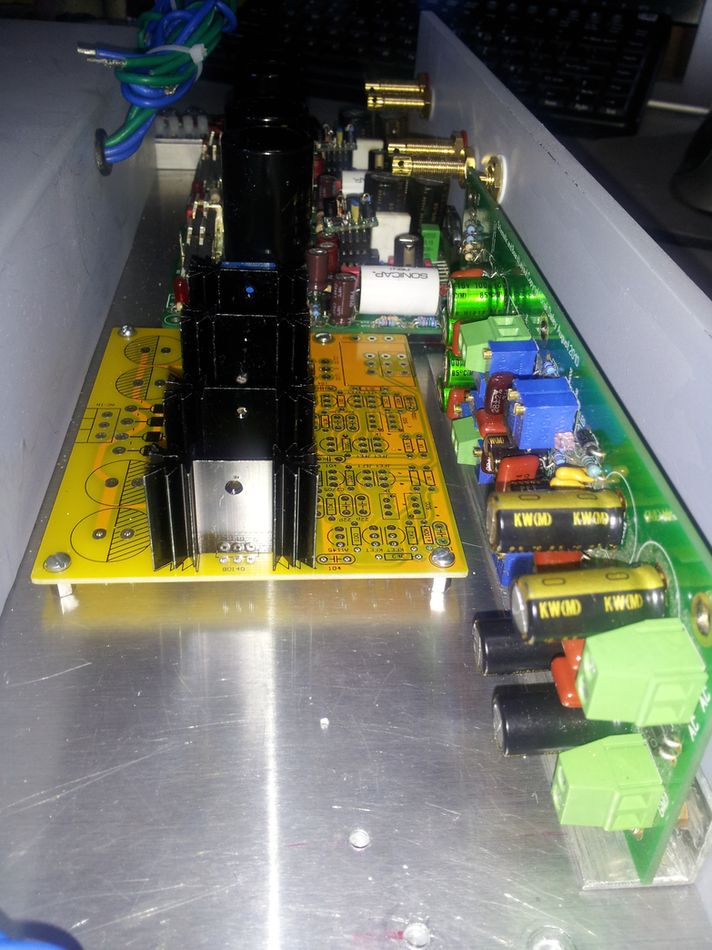

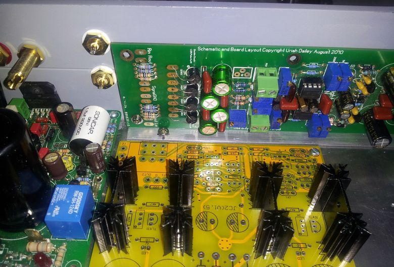

I took Uriah's advice for a 90 degree mount for the Lighter Note. I was even able to use the base of the previous bracket. Moved the out posts over 3/4" and changed the RCAs to over/under.
Gained big block of space - hopefully enough for the protection elements.
Fake yellow wires demonstrate short path signal travels in one channel.
Next step - let the protection system develop on the thread and squeeze it in as best I can.

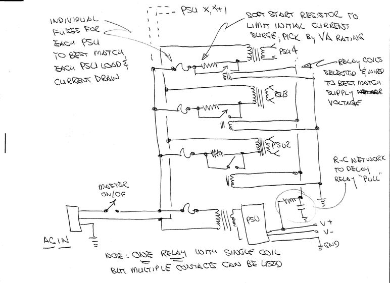

Here is CanAmMan's take on the proposed transformer protection project. This time I got the OK of all involved and hope there will be an active productive discussion here on the board.
"I'm back in cold Colorado, and had a chance to digest your thread and AndrewT's comments. Here's my thoughts (and please see the attached).
1. AndrewT is making the case for individual fuses sized to each toroid and power supply. This makes good sense, because if you size to one "mega-fuse" and your smallest power supply goes bad, it may not (in itself) be enough to blow the fuse. That can lead to bad thins for that specific power supply, and your amp in genera.
2. AndrewT is addressing soft start from the "engineering, build your own" perspective. He's right in saying building a custom soft start is easy, and integrating it into your four power supply MyRef is not difficult, if you take the DIY route.
3. See diagram. Andrew is saying take your smallest (and therefore, in theory, your "most safe" power supply, and do NOT use soft start on it. Rather, use it to power it's respective circuits AND POWER A SOFT START controller (see lower right-hand side of the diagram). Let the DC from this power supply serve as the "sense" and power source for your DIY soft start circuit (which can be as simple as a resistor and capacitor in an RC circuit, or perhaps with a simple IC timer (such as an NE555)). The soft start should have an output capable of driving MULTIPLE relays (more on this in a second....), after about 10-20 "cycles" of your main line AC voltage (i.e., for 60 cycle line current, that would be a delay of 10/60=1/6 second, to 20/60=1/3 second).
4. After that appropriate delay, your DIY soft start circuit should then drive ONE relay for EACH of your other amp power supplies. The coil voltages for these relays should be determined by your DIY soft start circuit output voltage--and wire the relay coils in either series or parallel, as to best match your soft start circuit output. In my diagram, I show them as wired in parallel, but obviously, your DIY soft start circuit would have to be able to provide the current draw to energize these relays in parallel.
5. EACH relay then serves as the soft start "delay relay" for each respective toroid. On initial start up, the relay is NOT energized, so initial mains current for each toroid would pass through a resistor, limiting the initial current surge while the toroid flux built, and while the filter caps come up to charge. There's continuing debate if these limiting resistors should be "normal resistors" per se, or if using thermistors (NTC resistors) makes better sense. I'll let the debate continue.
6. After the first power supply (again, lower right hand part of the diagram) is energized, and the soft start circuit puts out its "delayed voltage" to the MULTIPLE relay coils, the contacts on EACH coil are pulled down, thereby bypassing the INDIVIDUAL mains surge-limiting resistors for EACH toroid--and the amp starts normal operation.
7. If you are able to find a rugged relay with MULTIPLE pairs of contacts (suitably rated for your line voltage and current draws) you don't need multiple relays....but remember to handle EACH TOROID individually, with it's own respective limiting resistor and set of relay contacts.
8. Is Andrew's approach overkill? Not necessarily. Use of multiple fuses is great advice, and should NOT be avoided. Use of soft start (particularly on your higher VA circuits) is always a good idea. Is use of "normal" resistors or NTC thermistors best (TBD)? Keep in mind, Andrew's concept, and the circuits in the diagram (attached) are not difficult nor complex to implement--and Andrew is giving you a good, safe, and sound engineering solution. In fact, his solution is pretty elegant, especially if you can find one robust power relay with multiple sets of contacts.
9. Are there other ways to do this? Yep. Individual (commercial, of the shelf) soft start modules can also be used--but at a cost, and at the expense of "real estate" inside your amp chassis.

You need one timer.
That one timer is located at the bottom of the diagram and is powered by it's own direct on line starting, low VA transformer.
Now move up the diagram to the lowest of the power transformers.
There is a soft start after the fuse. That soft start is a resistor or thermistor rated for the transformer VA that it is starting. Initially the resistance acts as a current limiter.
After a time delay of a few hundred milliseconds the relay triggers to short out the resistance and the transformer now runs direct from the fuse and mains.
These same two components, relay and resistance, are repeated for each power transformer.
The fuses are not protecting the downstream components.
They are preventing the cables from catching fire and taking your house with them.
You need one timer.
Just a minor point, too, on my schematic. In it, I suggested "tapping into" your lowest VA power supply/toroid to steal power for the soft-start circuit. If you have the opportunity, an alternative would be to use a separate power supply just for the soft-start (and then use relay contacts and surge resistors for each and every MyRef power supply/toroid).
I provide the separate power supply as an alternative, because if you use the "industrial grade" Omron relay I suggested (4 pole, single throw, normally open), it's a hefty relay with a not insignificant current draw in the coil. This may or may not be bothersome, depending upon what else is being powered by your "lowest VA" power supply. Your call........
(Besides, if you are already using four toroids in your amp--what's one more, to power the soft-start circuit? 😱 )
Understood Andrew, then what is the method to determine the needed values for the components in the protection circuits? Is it purely calculations, and how important is determining the current swing from quiescent to full bore operation?
The quiescent current is entirely within the LM3886 chipamp - it can only be externally sensed, as AndrewT stated, by adding a sense resistor in series with one of the power traces - either +Vdd or -Vdd. However, the LM3886 has an internal SOA protection mechanism called SPiKe, that can sense both the output voltage swing and the current(s) through the output stage, and force clipping on overload. This is completely inside the chip, and there's no way to monitor or control its operation.
The external protection circuit is merely looking at the DC output offset - if it's too high, it de-energizes a relay and disconnects the speaker from the output, to protect the speaker, not the chip.

CanAmMan - What exactly are you abbreviating with "R-C Network" at the left lower side of the diagram? I'm learning to be very hesitant to make assumptions.
I think the word "protection" is muddying the waters. There may already be a EE term for this concept - but I'll try to coin sometime a bit more definitive. How about "Transformer Power-on System" = TPS for future reference on this thread?
Use a timer, not an RC filter.
The major problem with an RC filter is the very variable output voltage that tracks the mains voltage and droops with load current.
The resistor must pass high enough current to ensure positive triggering when voltage is low. That same resistor can run very hot when the voltage is high. The relay will also see all these voltage variations.
Andrew, I'm still a little dull here. You mention "timer" at the start of your last post, and "relay" near the end. Can you clarify?
