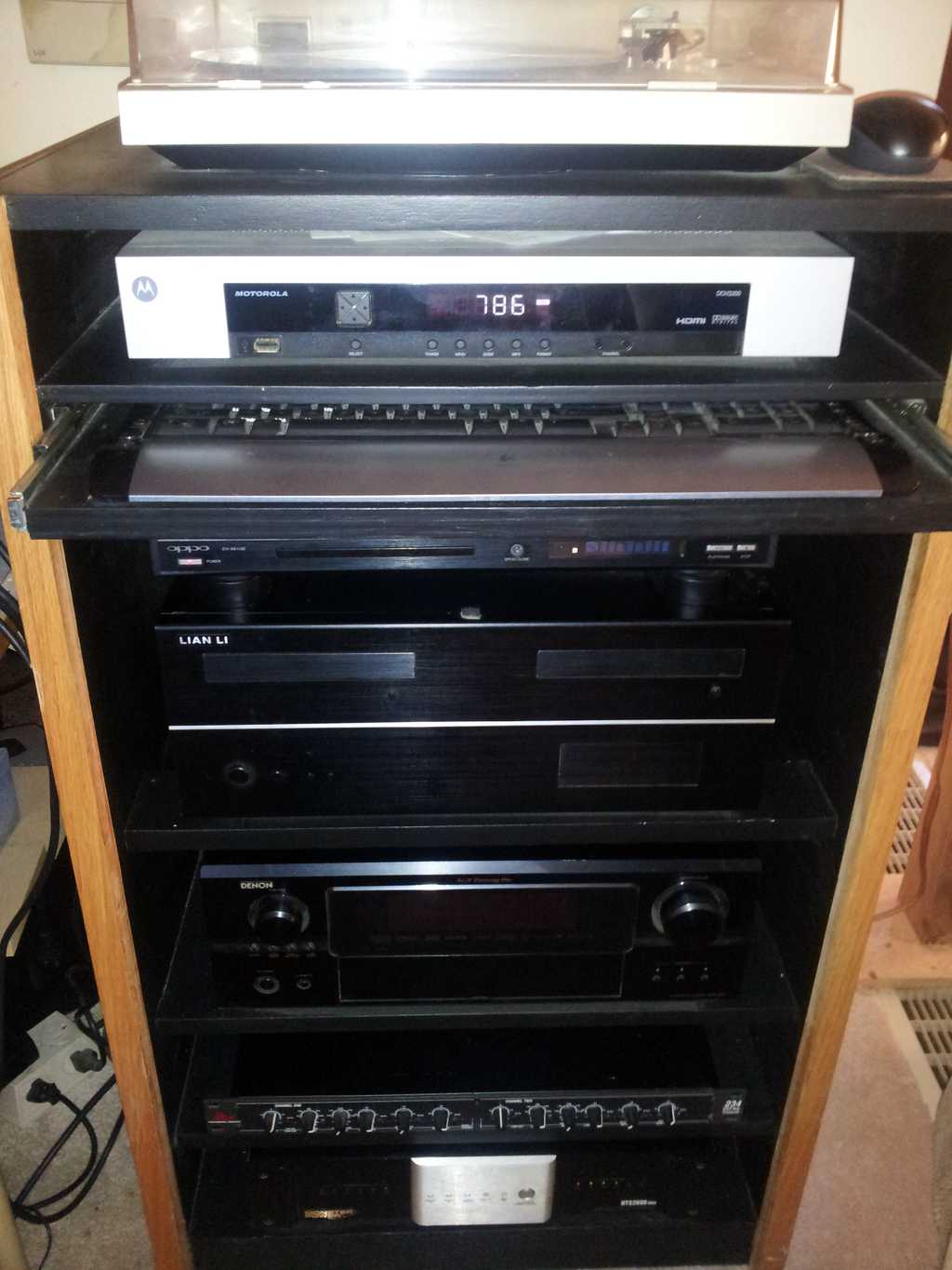

..and here's another - There is a 16 foot BNC cable between the computer and the DAC/FEs. The amps are monoblocks, each with a short 3 foot DIY AC Belden wire mains cable that come from separate outlets on the same dedicated circuit.
The entertainment center can be switched off by a single button on the power center (bottom unit in photo). After a bit of research I learned the filtering ability of the Monster box can degrade the performance of power amps (or isn't necessary) - thus the direct AC feed. Someday I might combine the amps, DAC, and a pre for an integrated build, but right now I'm stuck with a three or four step system activation process. I've almost got a path worn into the carpet to follow if I forget. 🙂
If I ever get to the end of this silly amp/pre/DAC/speaker building phase, I'll go "SLICK" with the magical mystical RF system I bought three years ago. 🙄
P.S. I still cant do a one button off as it produces error/delay if Windows isn't shut down properly first. 😡

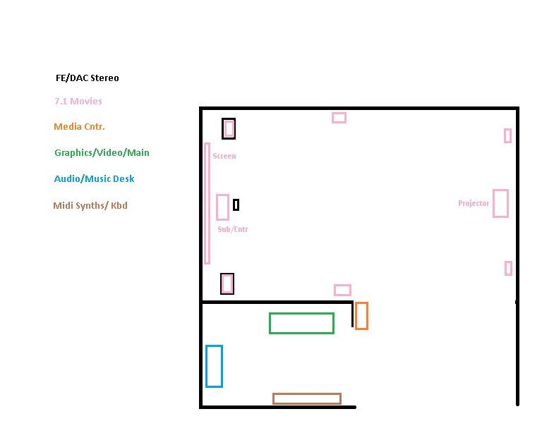

You are correct Jac. The separate AC feeds are most likely overkill. The dedicated AC circuit is a leftover from a time I had a video workstation, multi-synth music DAW and the main computer in the same room. No place for a couch for the occasional human who might occasionally intrude. :whazzat:
I'm not sure if the new arrangement is better or worser. Years ago when renting a house on a summer long road assignment, my landlord said I reminded him of his nephew who had a fixation with extension cords - over 1000 in the collection. Someday I'll melt down all the copper I own and have a second retirement. 😀
