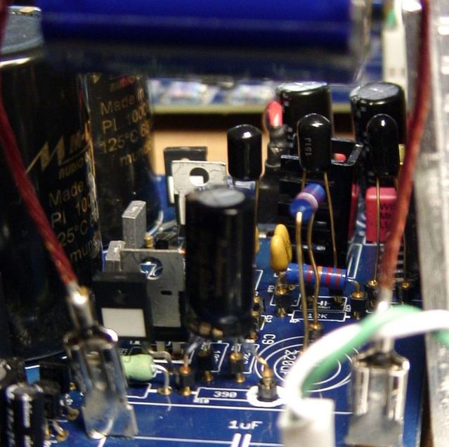

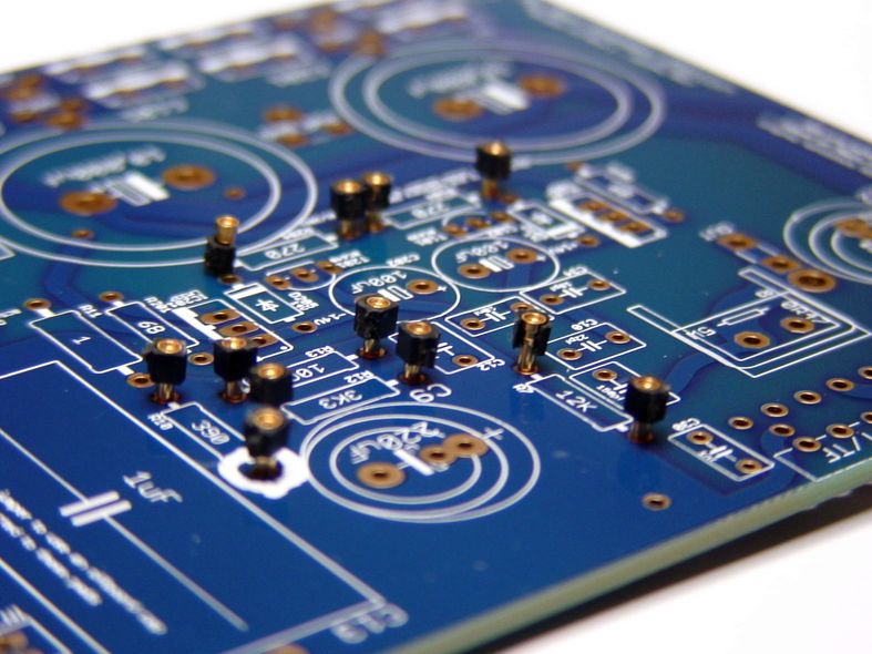

Here is a picture of a little socket forest. They are great for testing but there is an audible improvement after they are removed. You might find some leads to large to fit. Just use a super fine file to bring the diameter down. Do it in small increments as it's easy to go too far and end up with a sloppy fit. I also found it easier and safer to use small needle nose pliers near the end of the lead to insert in sockets and avoid bending and breaking resistor shells.

Here is a picture of a little socket forest. 😉
Thanks Bob. That is a much better picture of sockets and how they work.

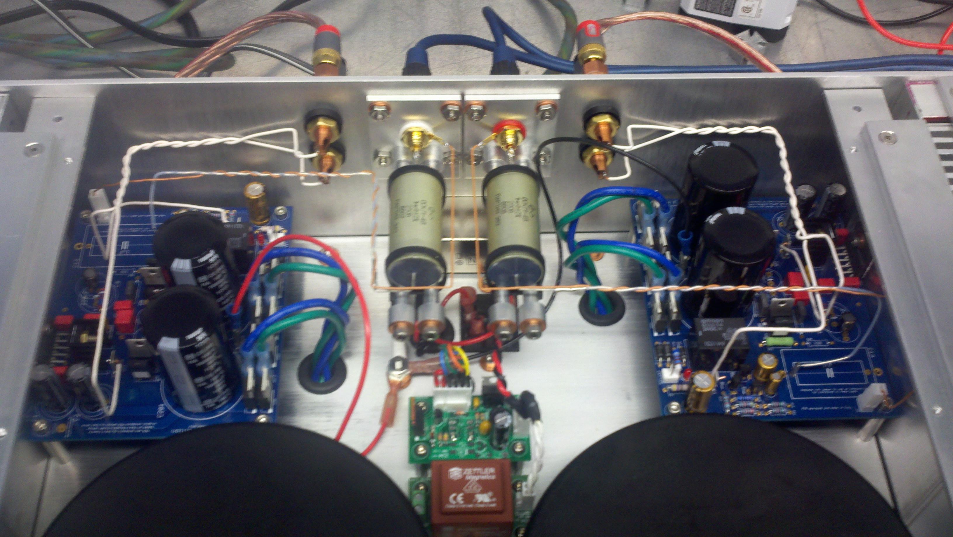

Okay I finished all the wiring. Tested with the light bulb setup, all is well. Tested offset, right channel 15mv left channel 40mv and drifting 🙁 on to the listening test. Wired up a temporary pot, must have done it wrong didn't work right and has hum. Hooked up Yamaha integrated for use as a pre. Worked better but still hum. Source and pre off amp still has hum. Even with the hum the amp sounds good, lots of bass great soundstage........any thoughts

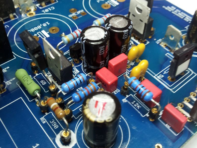

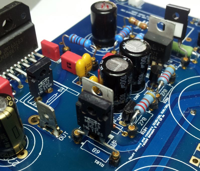

I found a few more pics that might be helpful.
If there's hum it's probably a grounding issue, It happened on several builds, are you using Molex or soldered connections?
Speaker sensitivity?
You're using LM3386TF? If so is the heatsink grounded?

Dario, all of my conections are soldered except for the my input ground, I used the molex for these.
Yes I used the lm3886tf, the heatsinks are grounded to the rest of the enclosure, but I am not using the heatsink ground conection or the pgnd connection...I will add that I did connect the transformer shield to the chassis (antek as 3222)

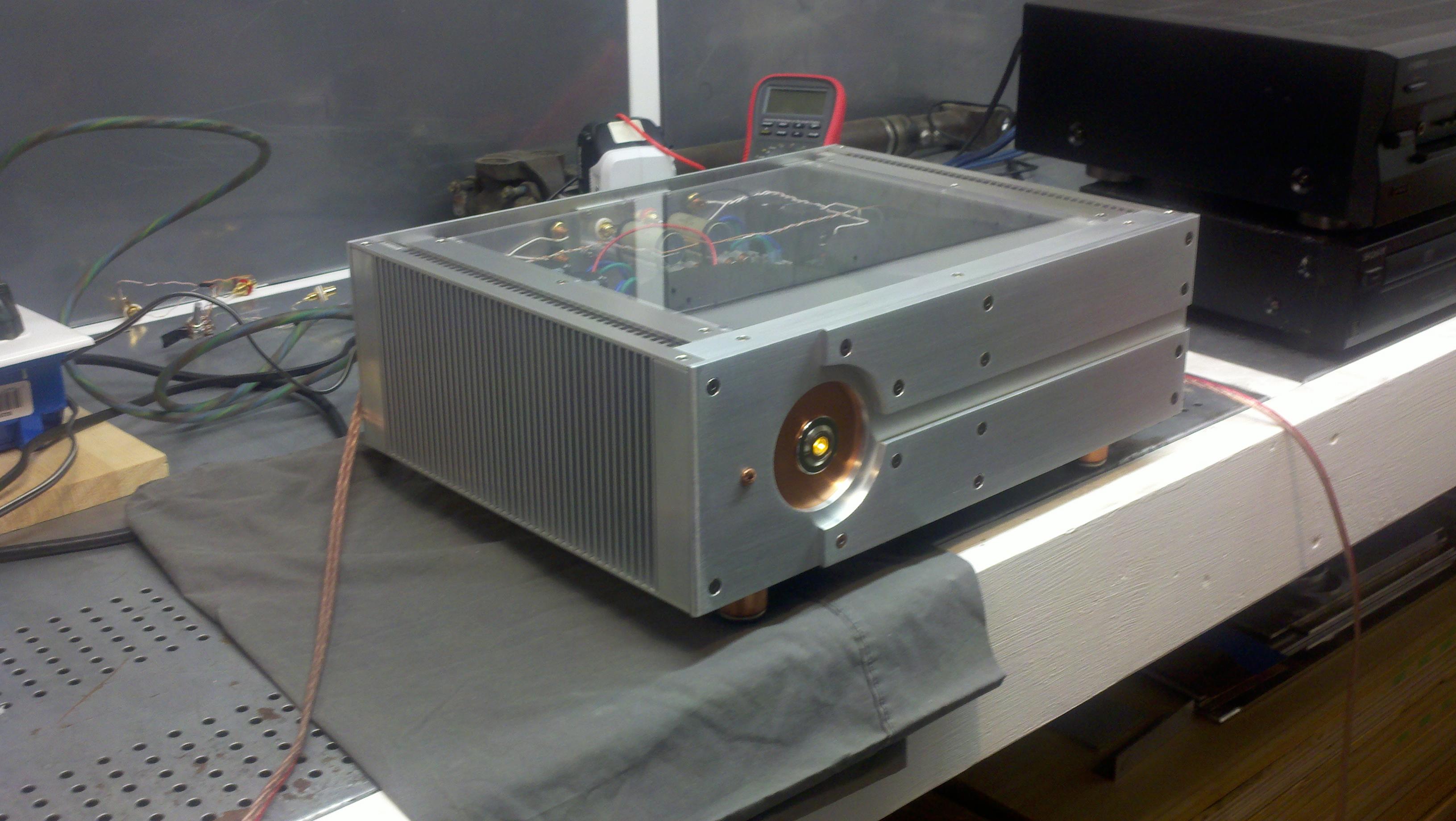

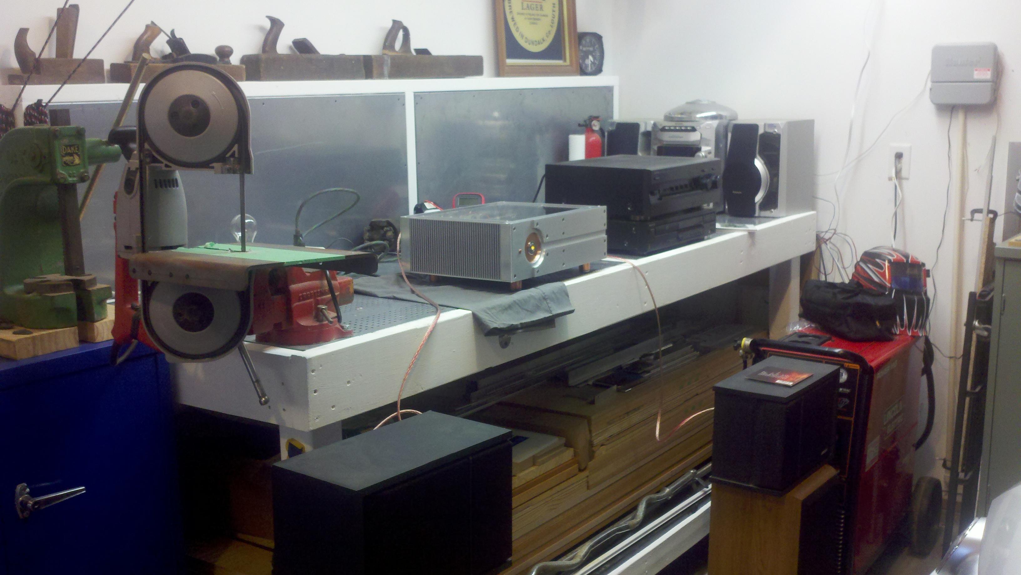

After a few unrelated early morning projects I was able to get back to the FE. I made a connection from each boards pgnd tab to safety earth and re connected the light bulb tester. With input and speakers disconnected I tested the offset. This time both channels were around 45mv and stable. Good. So on to a test with speakers. First was a pair of disposable infinity reference threes. Turn on was silent...amp on cd player at idle..total silence. Hit play on cd player adjust volume to 1/8 and wait. Slowly bon ivers Perth crept up out of the darkness. Eureka!
I quickly hit stop and shut off the amp, which aside from all three relays unlatching is silent. I connected an old pair of bose (I know) 201s for some better listening. Same thing dead black background very clear and refined bass, excellent separation, and detailed highs! I listened for a good forty minutes with a smile.
Its hard to tell from the pics below but that is Nathaniel Rateliff playing you should have seen the other guy in my garage/shop😀
I will hook all this up to my klipsch kg4s later and get some more impressions. And some better pics.
The offset will go lower.
The fact that connecting PGND tabs to safety earth removed the hum confirm the presence of a grounding problem, IMHO.
All my builds are perfectly silent with PGND unconnected.

Dario, do you suspect a grounding error somewhere in the audio circuit or otherwise?
I did connect the toroids ground shield; I don't know if any other builders have used this toroid and can comment. In the build guide for the diyAudio store f5 the reader is instructed to not connect this. So maybe there is an issue with these that I have not encountered on the web.
I attached a pic of the layout, it is a cell pic but you guys will get the idea. Im at a loss to figure out what error would be fixed by connecting the pgnd. The sound is perfect, is this somthing I need to fix..hmmmm.
Do other MyRef designs connect to ground or do they "float"?
