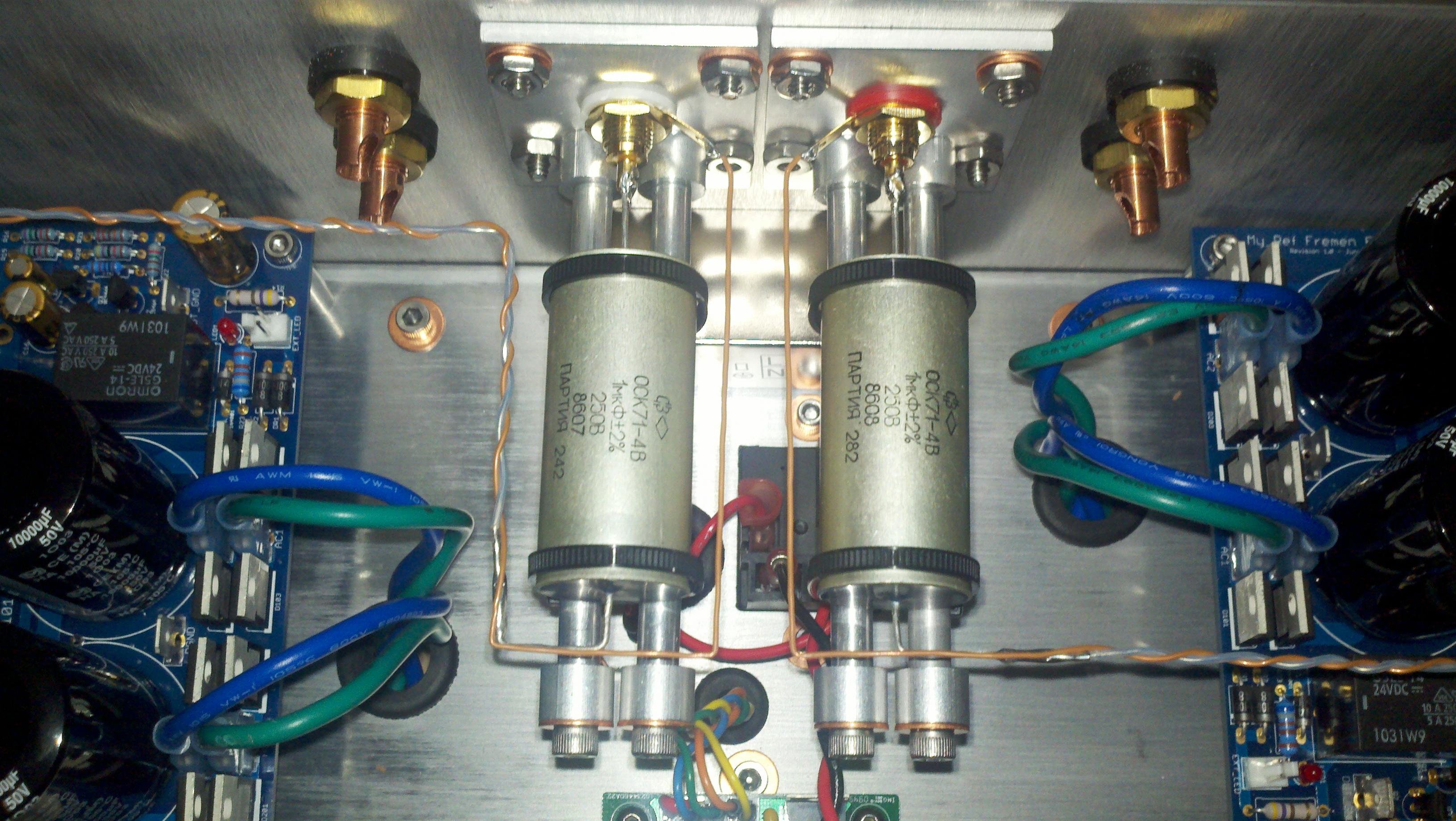

I bought my k71-4 caps from valtek. The shipping was reasonable and fast to the US. I bought two sets and they were very closely matched. The set that I am using for the FE build measured .999uf and. 998uf. They measured the same after soldering too😀 I am hoping to have some listening impressions soon.
