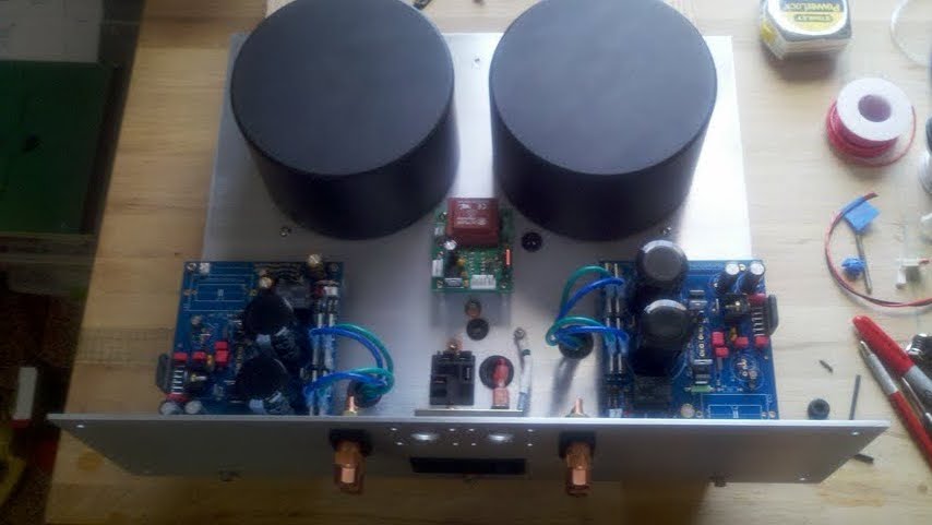

Well I am a little late to the party, but I guess it is not over 😀 I wanted to check the basic function of the boards before I finished all of the assembly of the chassis, and all of the input and output wiring. I designed the chassis for ease of repair if neccesary and any component swapping I may do. I will get to that soon...anyway I powered up the boards one at a time (just in case😀)the left channel relay clicked, led lit and the offset was @2.99mv, the right channel relay clicked and the led lit, offset was @2.83mv.
So now I have to do all the final wiring and test the channels at the same time. I also have a switch circuit that I need to finish and test, and then maybe on to some listening tests!
Finally! 😀
Can't wait for your comments. 😉

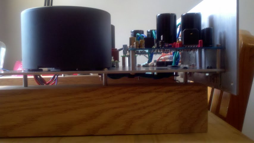

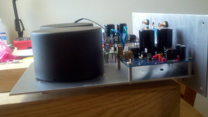

A few pics of the nearly finished build. The entire construction is made up of two main parts, the main chassis and the outer enclosure. The pics below are of the main chassis, the rear panel is attached so that the entire finished unit can be removed from the outer enclosure without the need to disrupt any wiring. I apologize for the fuzzy cell pics..I will try to get some shots of the outer enclosure tommorow.
Really nice! 🙂
Can't wait to see the complete build...

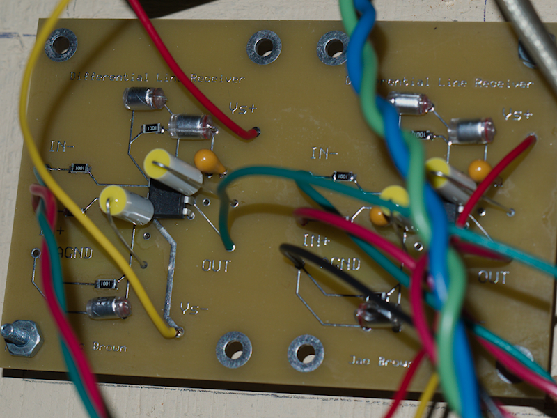

Can you feed a MyRef amp with a balanced signal through a balanced line receiver?
In theory, any single ended amp should be able to get a balanced signal this way, but I had a few questions.
1. The differential line receiver needs a few milliamps DC power. Can I supply it from the FE regulated voltage supply without problems?
2. The MyRef (an FE RC in this case) has a little bit unusual grounding scheme with audio ground and the speaker negative terminal separated by a 1 ohm resistor. If I connect the audio ground of the differential line receiver in parallel to the MyRef audio ground at the input cable connector, would any noise be introduced?
3. My first attempt of a differential line receiver uses an AD797 opamp which is notoriously fussy. Are there any oscillations or any other noise problems with my little board design?
4. What is the sound difference, if any, between balanced and single ended?
http://www.diyaudio.com/forums/attachment.php?attachmentid=338493&stc=1&d=1364250979
This is my little stereo differential line receiver. I've learned more since I designed it, so I would do things differently the next time, but it works. Questions 1 and 3 are answered with no problems. Question 2 is no problem either. Background noise is silent and music plays normally.
Now the big question. How does it sound. I need a little time before coming to any conclusions. First impression of the balanced connection is that it is even more detailed, but I am set up for quick changes between single ended and balanced and I need to do the back to back comparison.
When I implemented a balanced receiver if found the information from Rod Elliot at ESP very helpful (and detailed). I plumped for using the INA2134, which I perceived as sounding better than the SSM2141. However the recommendations on Rod's site seem to suggest that a THAT chip is much better. None-the-less I am very happy with the INA - but might try the THAT chip in the future.
