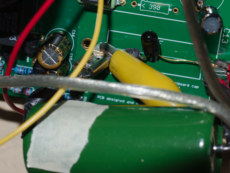

As for Bob's request for a picture of my bypass on the FE, it is pretty embarrassing. Just alligator clips across the fastons that I am still using for C13. As you can see, the K75 is really too long for the board. It's about 5 mm longer than the K71 which is at the limit. That is OK for me because C13 will be off the board when I get it in the box. At that point, it will be even more difficult to mount the bypass cap.

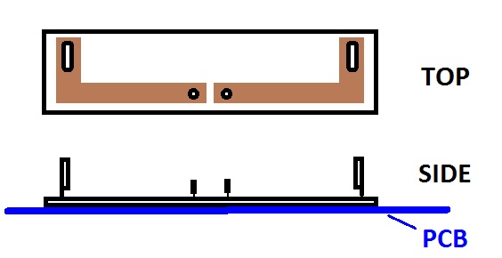

No need to be embarrassed. You spawned an idea that will be helpful in investigating the bypass tests. With some of my scraps - thin Plexiglas (could be perfboard), thin copper plate (could be wire) fastons and sockets - i'll make a rig to sit on the board for testing.
Something like.....
Thanks.
