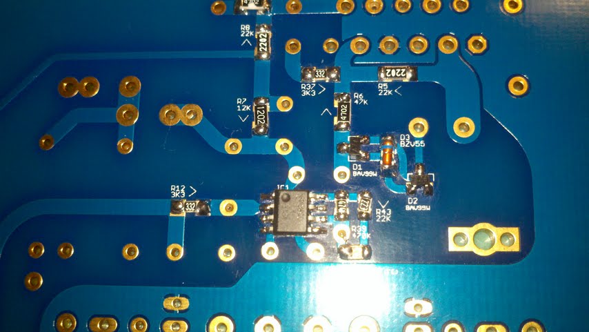

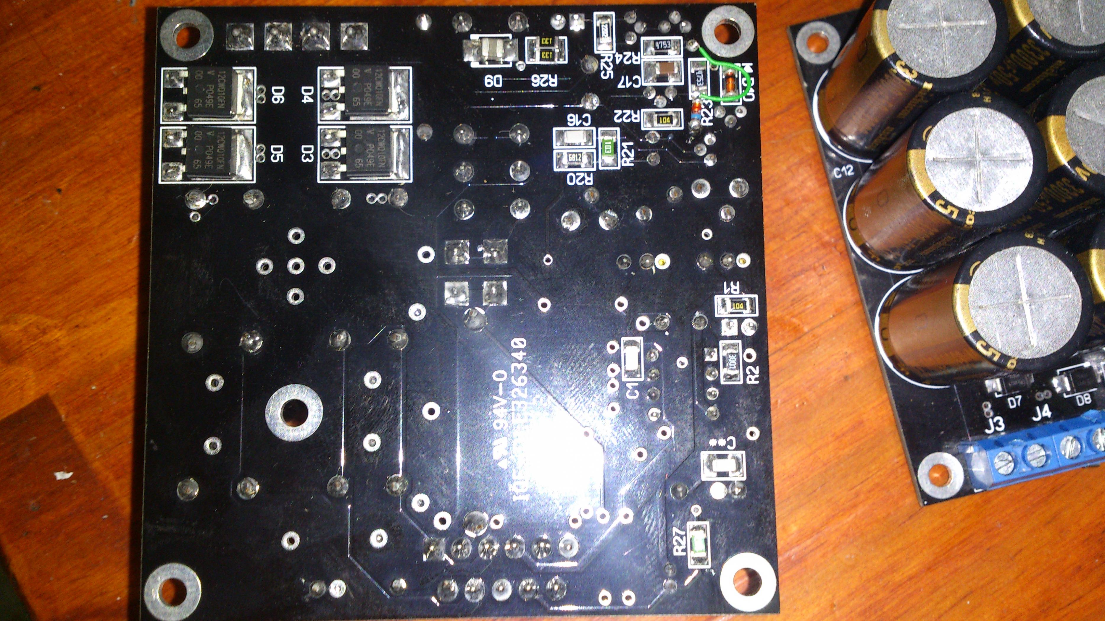

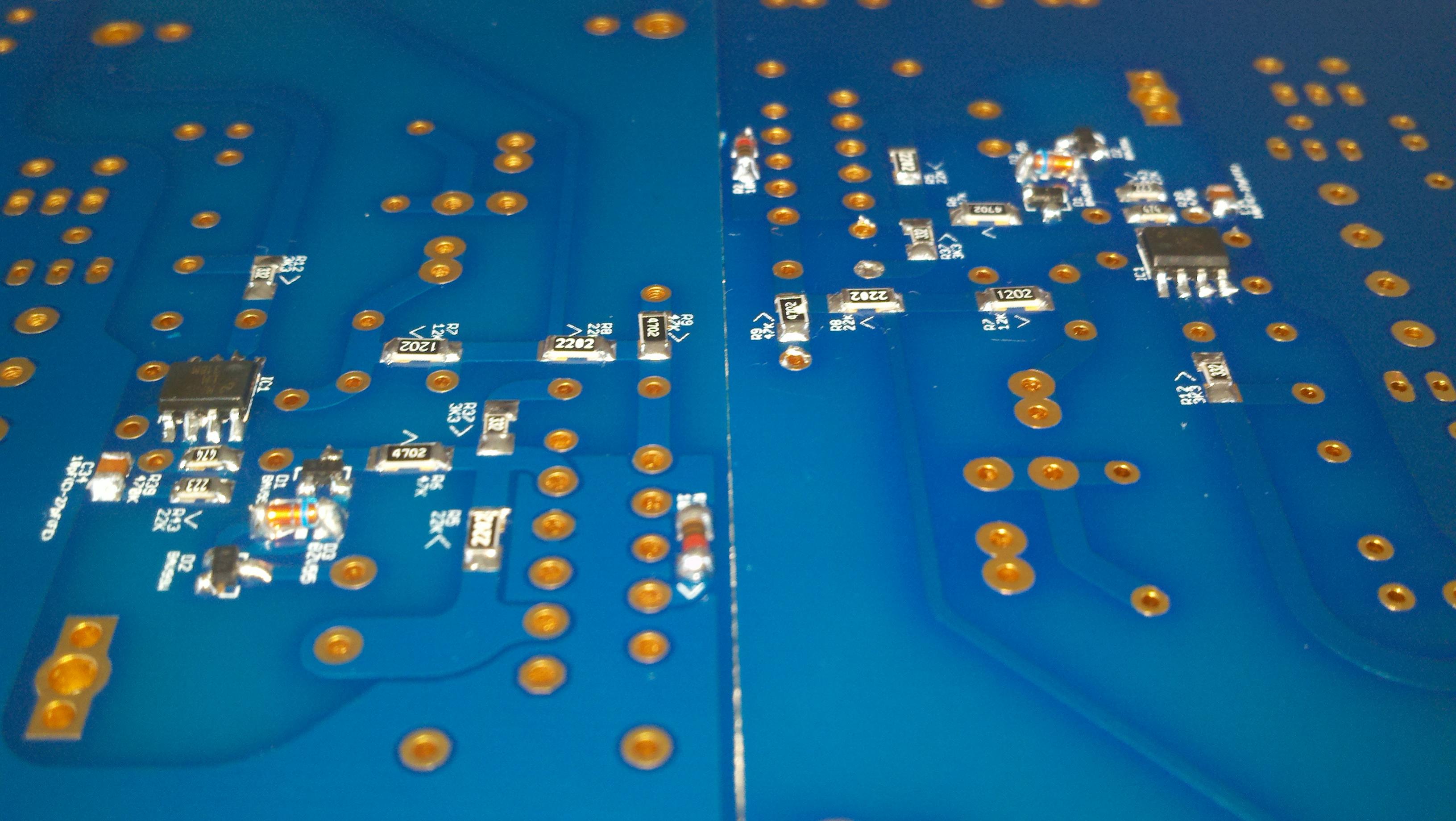

With some time off for the holidays I was finally able to get started on the FE boards! I spent a few hours yesterday soldering all of the SMD parts. Unfortunately I am pretty sure I have a solder bridge between two or more of the pins on one of the lm318. I have soldered a few SMDs before and I dont remember them giving me this much trouble.(though I did not have a quiet workspace where I could concentrate this time).
How resistant to heat are the lm318s? Can I rework them, or should I just order some replacements?
I am excited to finally be underway....and for the most part being done with the SMDs😀
Here is a pic....not really my best work but hopefully good enough for great sound!
You can rework them, but you must be fast, use solderwick and flux to remove excess solder.
Do the same also for quite all resistors, way too much solder (you should never see a bubble).
BTW having at hands a spare LM318 can be useful if you later discover they were heated too much.

Bob, thanks for the video. that looks easy! I may try that or I may try the chipquik and solder wick. Not sure, but the bridge is hidden under the chip where I cant get to it without pulling off the whole ic. I am worried about all of the heat that has been applied, will be applied while removing the chip and will be needed to re-solder it. It might be best to order a few more from mouser and for now move on to some of the other areas of the board. hopefully I have not forgotten how to solder and the through hole components go right the first time😀
PS..I also killed a 10pf cap at C34 so I removed them both and replaced them with the alternate 27pf that I ordered with the BOM. I wish I had ordered extra 318s🙁
Spares are a good idea. However, if you use the end of the wick instead of the side, and trim the wick after about 1/4" has absorbed solder, you can draw a lot out with minimum heat. Two - four passes may be required. I heat the wick and then move the iron/wick combo into the solder on the board/chip. Liberal liquid flux on both the board and the wick.
Don't use a lot of downward pressure as the wick can be very abrasive.

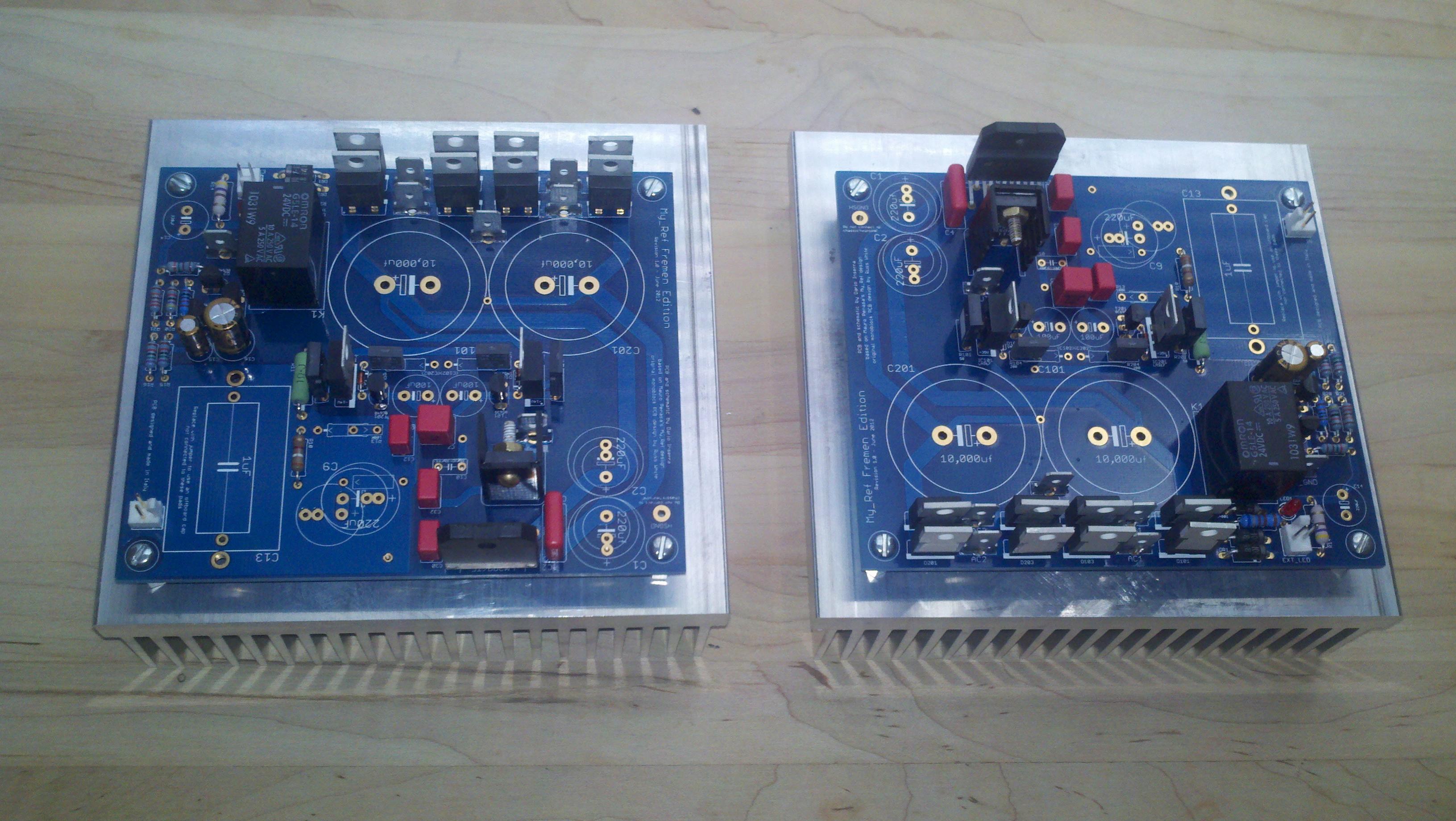

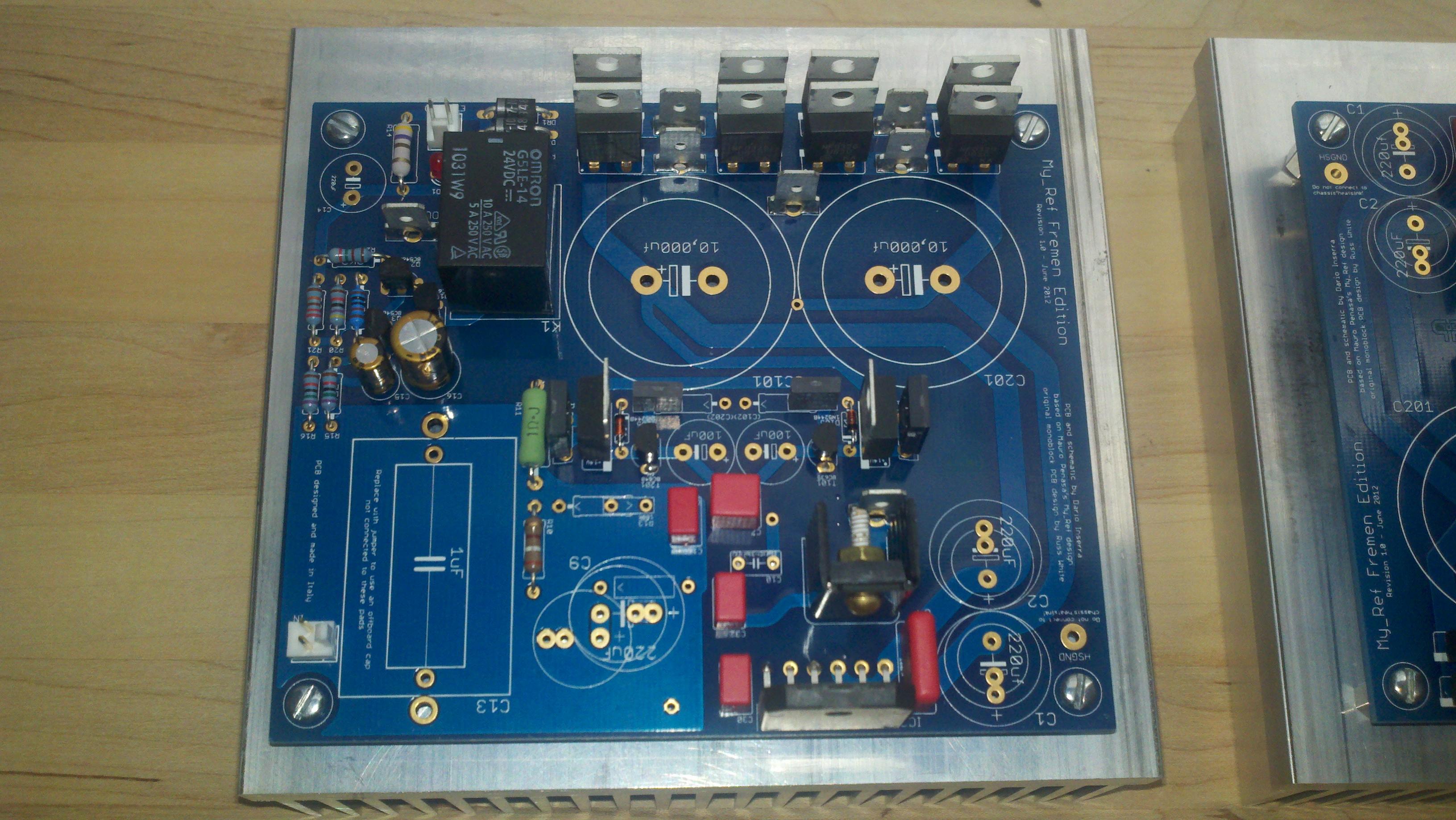

Well I finally have the majority of both of the boards populated with the exception of a few locations. I am expecting an order from mouser any day now with some replacement smd parts and the 220uf caps for c14 that I somehow omitted from my original order. Having said that I am going to replace most of the smd parts just to be on the safe side. It seems a few builders have had issues with that part of the process and now I feel like I have the hang of them😀 I also have to decide what orientation I want to use for c9 and r10. Has there been a consensus reached on the ideal configuration?
I am also a little confused by the different values recommended for c10 22pf or 33pf. I did a quick search but I didn't find much info about this location and the values; any explanation would be great, I am sure I missed it along the way.
Ps. You can see in the photo that I absent mindedly installed a resister in one of the possible r10 locations😀
From what I can remember everyone liked best the alternate config:
You'll probably desolder it... 😉

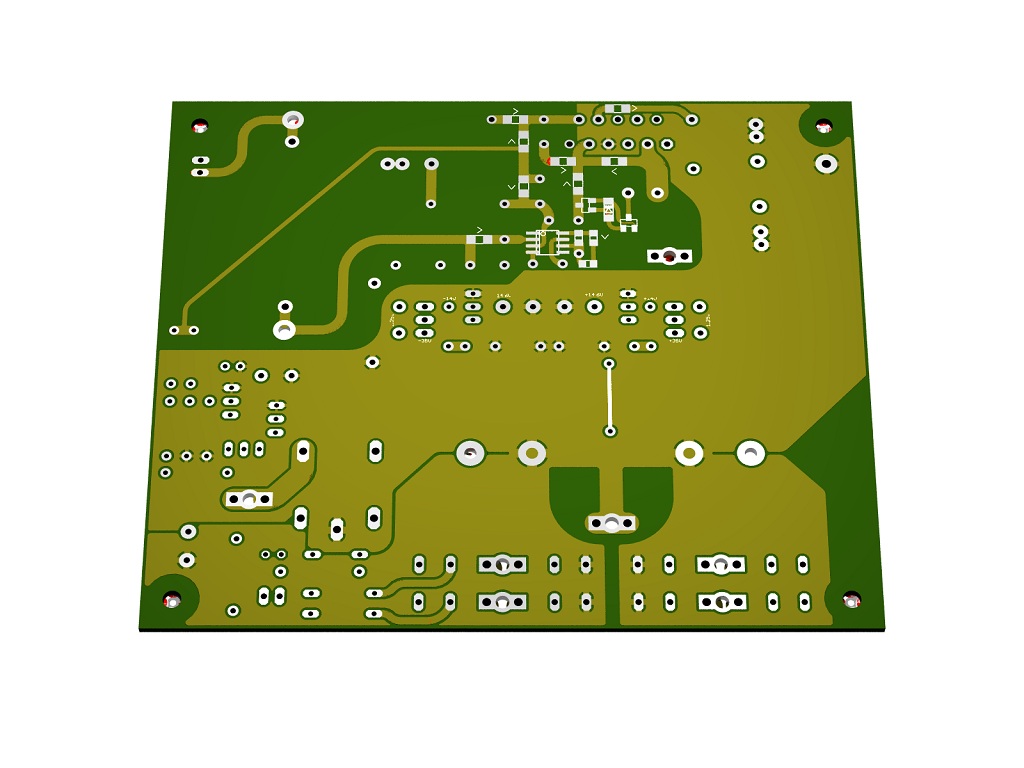

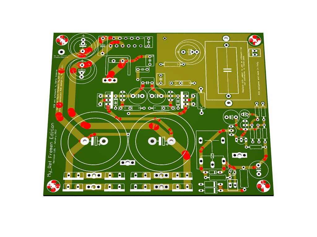

The Group Buy for the final version will probably start this February.
The final PCBs are quite identical to RC ones with the following differences:
- some holes are larger
- no more alternatives for C9/R10 arrangement
- some DMM readings are indicated on PCB

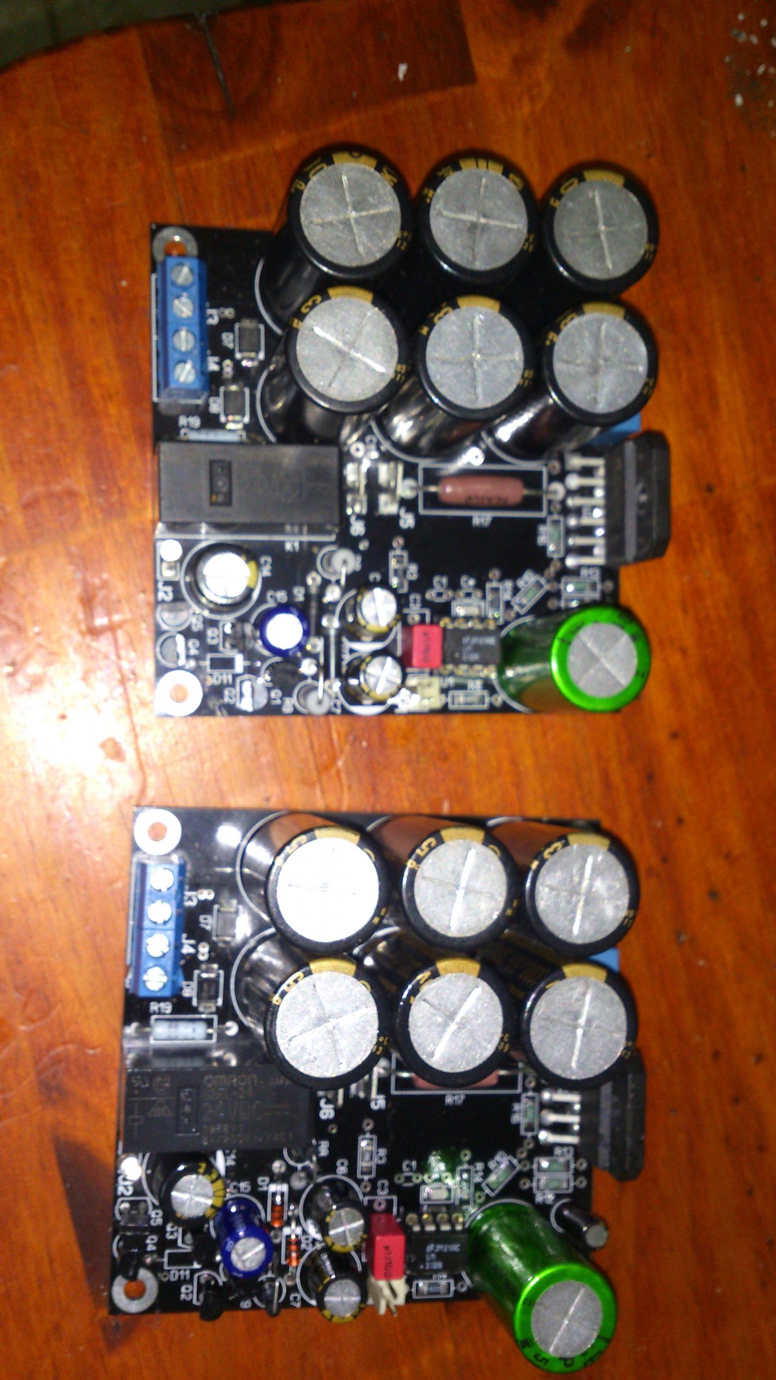

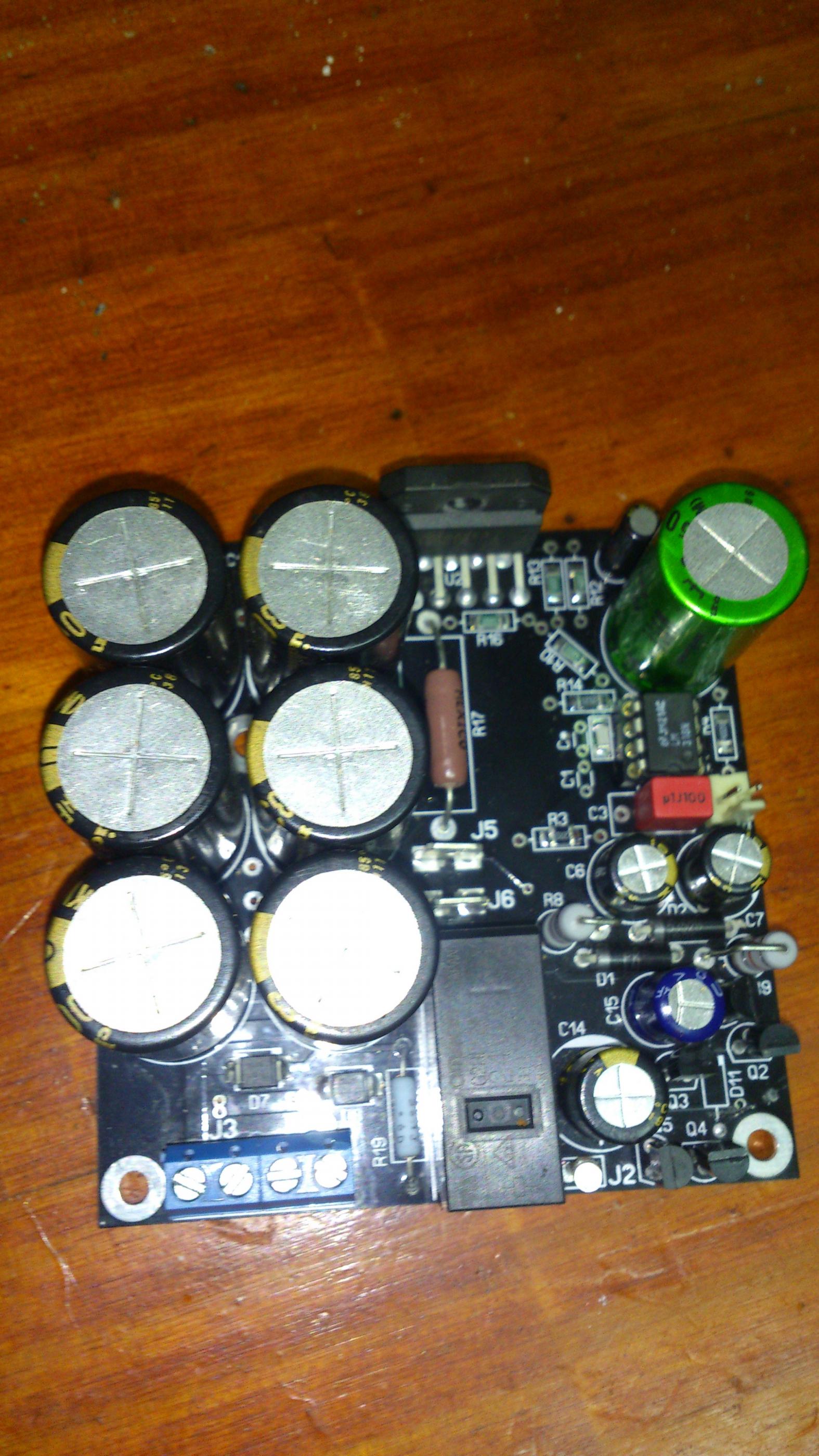

This is my design of this amplifier
Hi Svon,
interesting work but it seems a standard My_Ref, isn't it?
