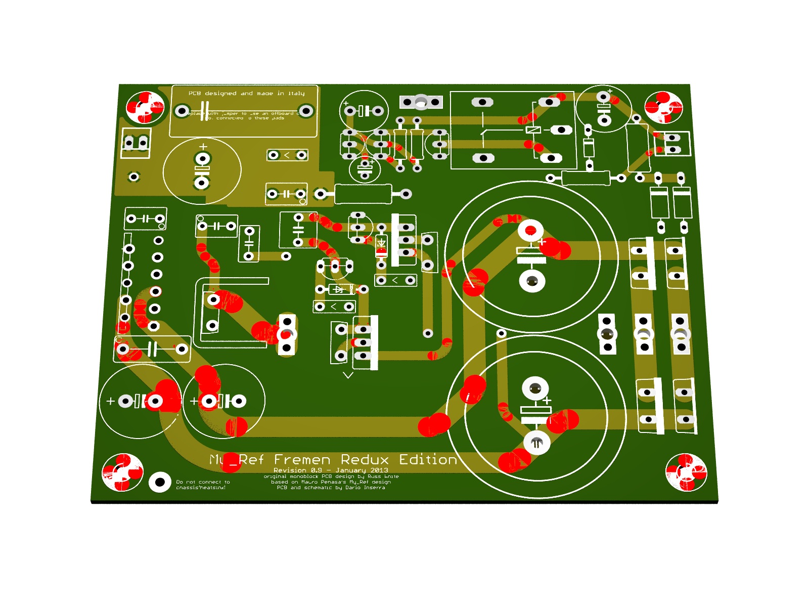

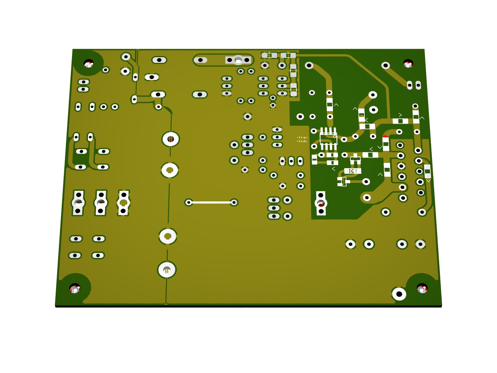

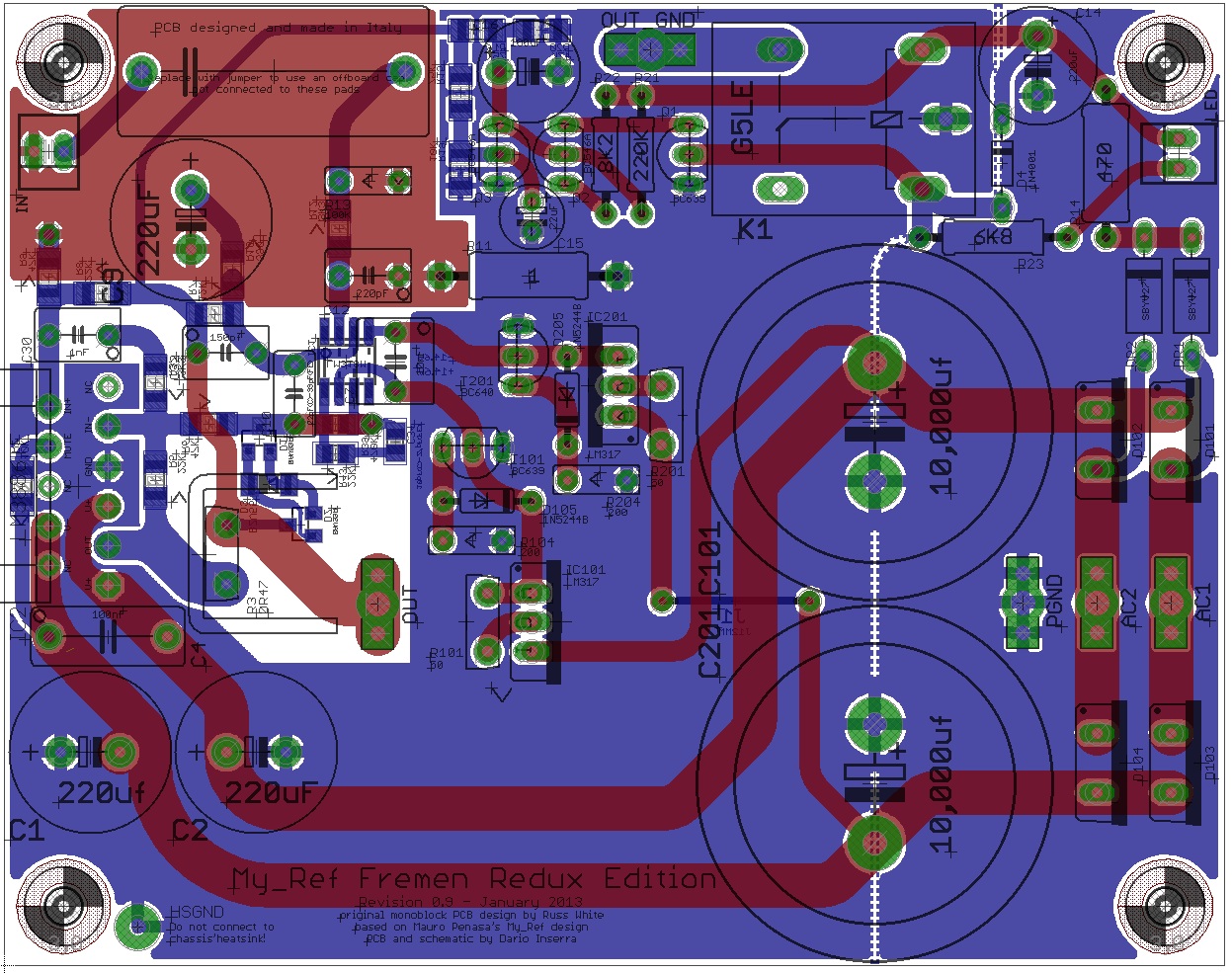

In these days I'm playing a bit with a reduced FE board:
attachment.php
attachment.php
attachment.php
This PCB differs from the standard FE one in the following:
  • smaller (same dimensions of TP board, it should be a near perfect replacement in actual builds, including drilling and heatsink mounting)
  • same input cap limitation of TP board (22.5mm lead spacing)
  • single bridge, a bit less performing but allow the use of a single transformer for two monoblocks.
  • Not as optimally spaced and optimized as Fremen Edition board.
I've designed it just for fun but maybe it could be interesting for some.
Any comment is welcome... ;)

Dario,
Very interesting. It looks like the big power supply caps are the same size. Is this correct? Personally, I find the single bridge interesting as it makes it easier to bi-amp and tri-amp speakers. The cost of transformers for multiple monoblocks is a bit higher, but they also take up a lot of space.
I have powered both channels of my FE using one transformer with circuits in parallel and without problems. The shorted input hum measured the same and it sounded the same, so even though monoblock is the recommended approach, I am comfortable with either the dual bridge or single bridge approach.
As for the smaller input cap, so far I have been using caps that are either too big (K75) or a very tight fit (K71). I don't mind the cap extending "off-board".
Very nice work. How much different from optimized do you see this board?
Jac
Hi Jac,
No, they're 30mm like in TP boards.
BTW the FE BOM uses 30mm caps so not a real difference.
Good to know ;)
Yes, not a big limitation.
Thanks :)
Particularly on the upper left corner area the layout is too much congested, the DC protection circuitry is probably too much near to the input cap.
If this is a problem in a real build... who knows... we should build it and, possibly, measure.

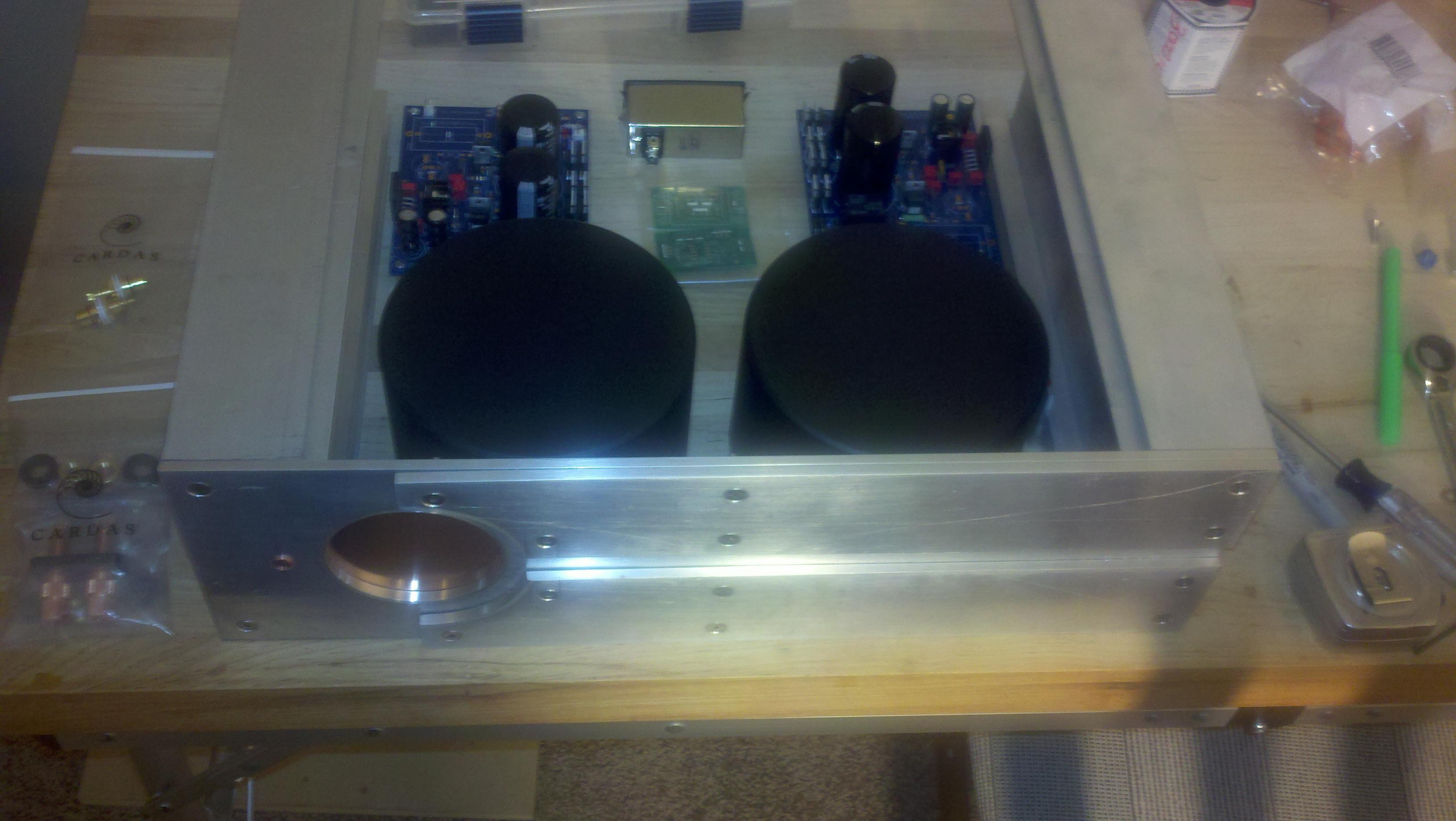

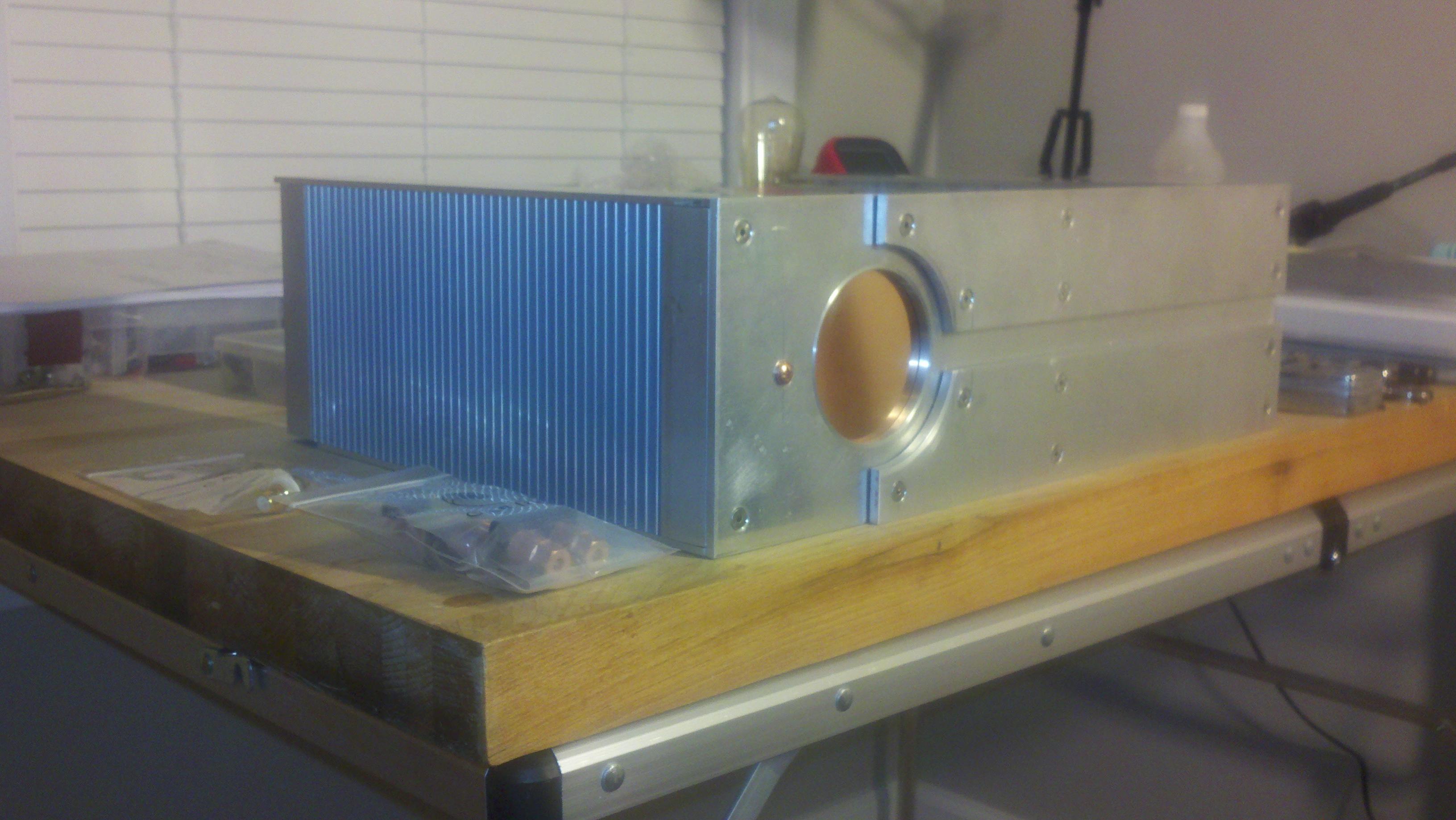

I am almost ready to finally power up these boards, but I am waiting for some rikens from parts connexion so I had a little spare time this week. I decided to do a little enclosure work. Most of what I have put together so far is from parts and pieces that I have laying around, except the copper. I had to run to the hardware store for it.
Here are a few blurry cellphone pics..let me know what you think
Wow! Impressive work!
If' you're asking about layout I think it's pretty good very similar to the one I'm using.
I would, BTW, consider a plain Furutech gold plated inlet in place of the filtered one I can see in pictures.
Thanks Dario, the layout just seems logical:D. As for the iec inlet, it is not the filtered type. It houses a power switch and a fuse all in one package. That is why it appears larger like the filtered inlets. I like having a switch at the inlet on the back of the device where little hands can't get to just for extra safety!
