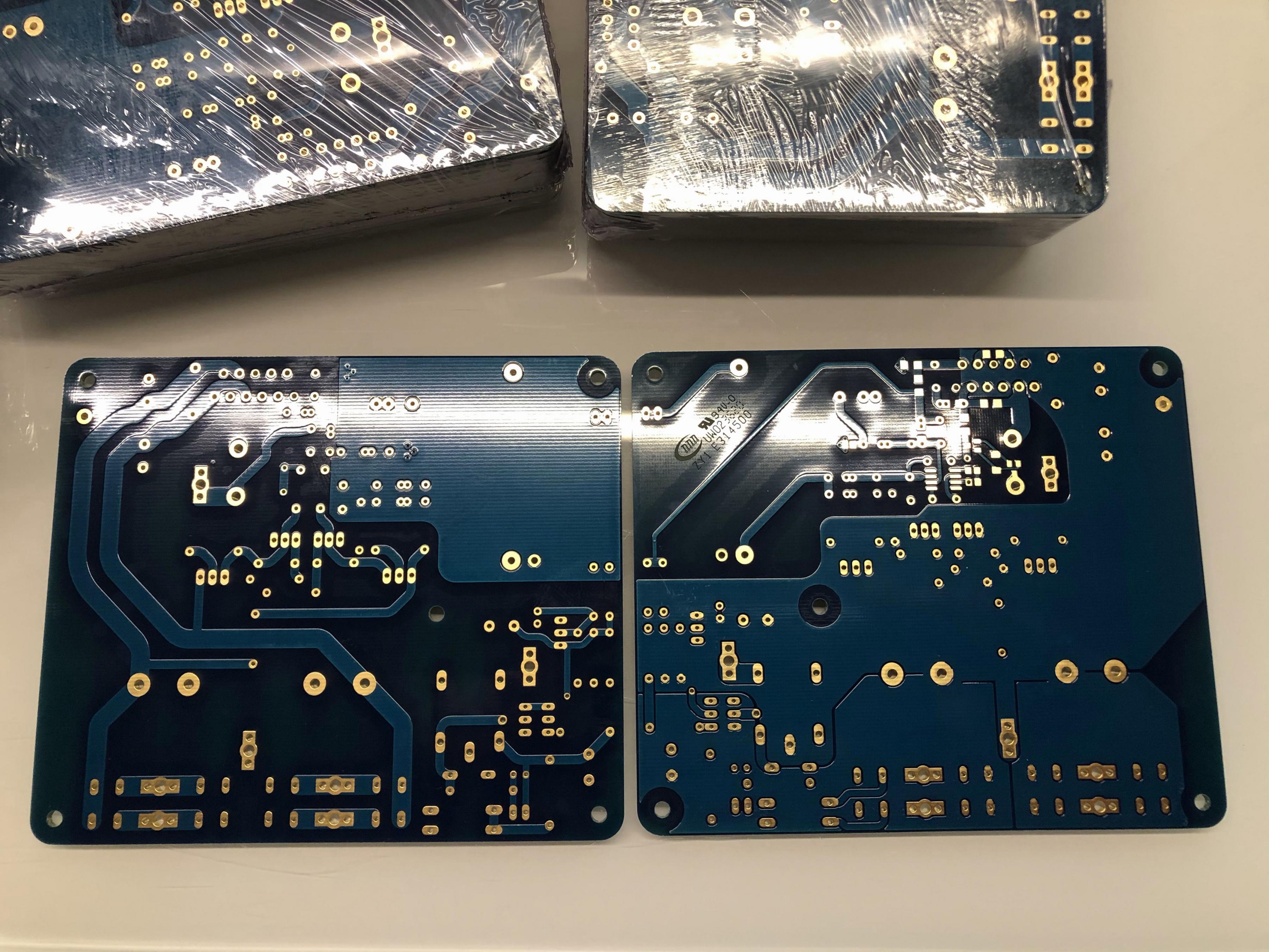

Yes they look really great, but the material thickness is really not that great.
I would have done the same thing and sent her back.
But visually a real treat...

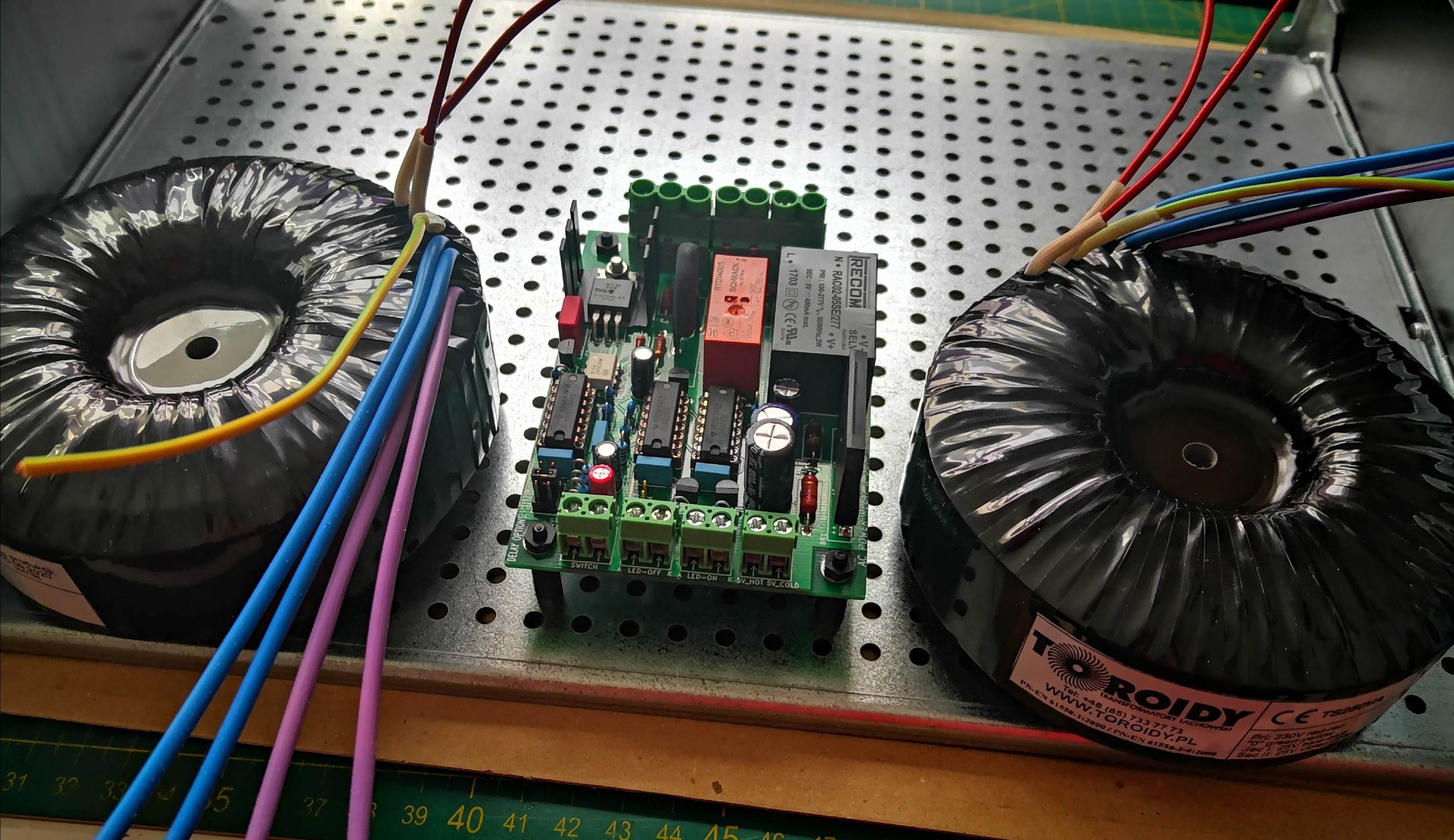

Will reuse a chassis and power transformer. May start on modifying the chassis.

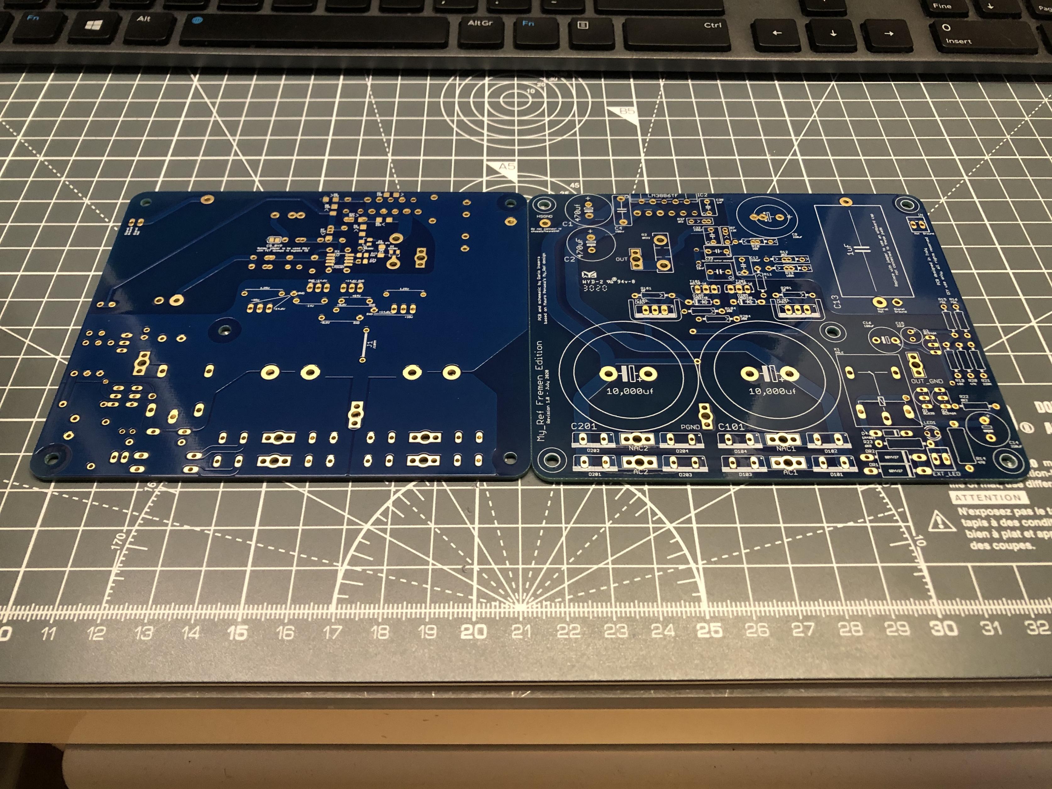

Boards arrived, again wrong...
This week the re-manufactured boards arrived, right tickness, better quality but
WITHOUT ANY SILKSCREEN 😡
I've asked the supplier to re-manufacture again and I'm waiting for an answer, I'll keep you updated.
I'm furious and really sorry.
