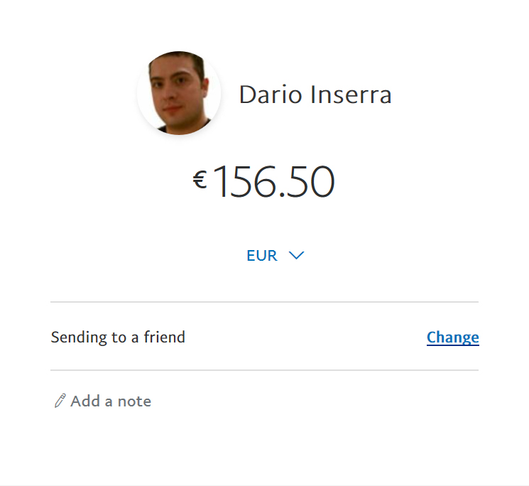

For me it goes straight to the billing statement once again. But what I do notice up above it is set to "Sending to a friend" and once I click on the "change" selection I can change it to the "Paying for an item or service" selection. But you do know there are fee's associated with that option on your behalf? I hope you've adjusted invoicing with the included fee's to the buyers?
Perfect, I'm happy you found the correct option. 🙂
Sending to a friend is a recent addition, all prices (boards, options and shipping) already includes PP fees.
Ok, I just wanted to make sure you included paypal fees since I know the other option doesn't include them, only fees associated with oversees/money conversion type transactions which would be on my behalf if so. Payment is sent, and you should have an address now. 😉

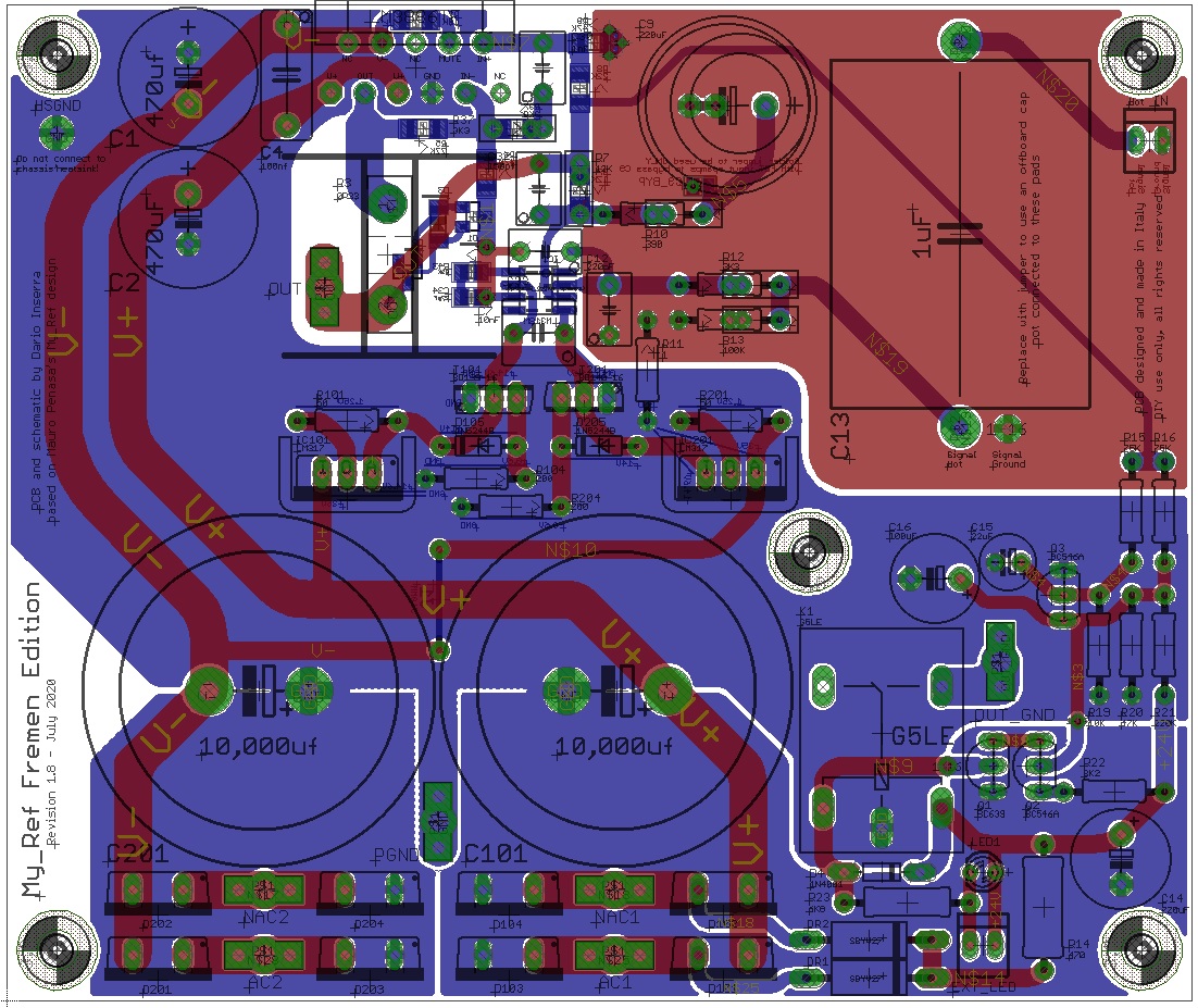

Some PCB porn

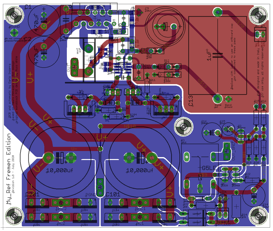

Still refining but so far:
Tom do you see something?
Changes so far from 1.72:
- C1, C2 13mm diameter, dropped 16mm support
- C4 moved to make place for R3
- Rearranged LM317 orientation to make place for R3
- R3 is TO-247 now to support manganin resistors
- R3 both orientation are supported and there is space for a Fischer FK 243 MI 247 O clip-on copper heatsink
- Dropped FE compensation, Evo A only
- C10 replaced with C33 negative feedback (other opamps support)
- C9 now support 18mm diameter caps (100V Cerafine for instance...)
- C13 now is 26*35 with normal pads, dropping the too big ones that supported first version of Audyn True Copper (blue ones)
- dropped snubber capacitors pads (a real snubber it's a RC network...)
- Something Tom asked for 😉
Great work, Dario.
It looks like it might be tight, but is it possible to include a hole for the old TO-220 R3 spacing? For example, I know that Pete is using the Ohmite TO-220. It's not a big thing if its not possible.
Jac
Good idea, that would give people more options if possible.
Speaking of C1 and C2, when did you make the change to the 470uF decoupling caps as the schematics I've been looking at has 220uF caps, and how much of an effect did they have on mid frequencies?

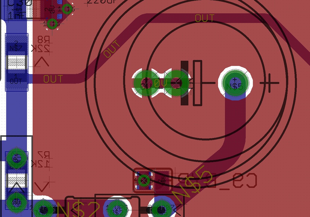

Maybe one thing..
When one is not using C9, because of the FET input opamps, normally it should be shorted out.
But.. At this moment R10 could be just directly connected to the top (red) ground plane.. If You would just create a clearence in the ground plane solder mask, somewhere beside the R10 pin.. Then a zero ohm resistance could be plced there or simply a solder blob / bridge, directly connecting R10 to that sensitive ground..

I've been looking and looking and apparently not terribly observant. Are we talking about the extra mounting hold in the middle?
Dario,
Please be aware of the new R3/heatsink position in relation to chip mounting hole. It was always problematic. I can't tell for sure, but the new orientation looks like it might be even worse. If the resistor could be moved slightly off-center, mounting 3886 to heatsink would be much easier.
If I remember correctly when BOM has been revised for 1.6.
Too much time passed I don't remember which difference made but it was introduced following other LM3886 designs and it did improve perceived performance.

Something like this?:Maybe one thing..
I see an extra hole..?
Yes 😀Are we talking about the extra mounting hold in the middle?
You're welcome 🙂Joseph detected the change, which I requested years ago.
Dario, you found a way to do it, and I thank you for this and all your efforts.
DonePlease invoice me for one pair of fancy R3's. I'll be happy to use them in this new build. I agree that the Caddocks have outstayed their welcome.
Following build guide suggested mounting method it's not problematic at all, even with the new bigger resistor and heatsink.Please be aware of the new R3/heatsink position in relation to chip mounting hole. It was always problematic. I can't tell for sure, but the new orientation looks like it might be even worse. If the resistor could be moved slightly off-center, mounting 3886 to heatsink would be much easier.
In any way this arrangement permits shorter return path for the feedback network and to not impair, as much as possible, current return from the LM3886.
