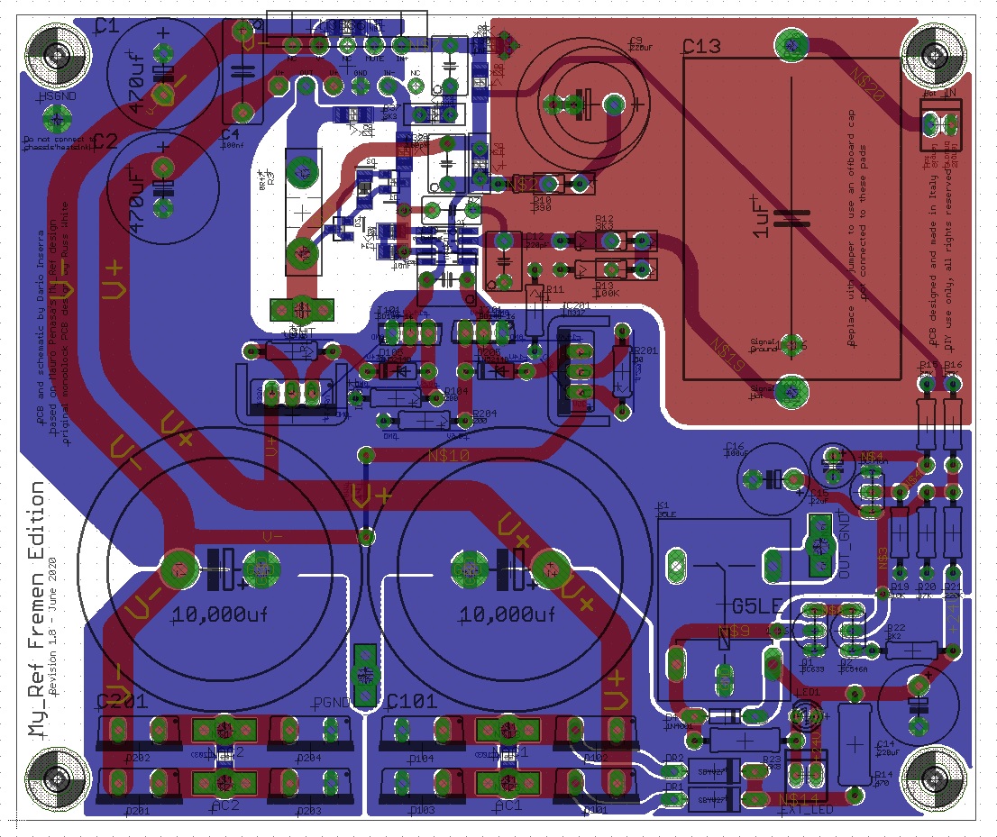

Nice, looks like that rearrangement will provide plenty of room for either orientation of a TO247 on R3.
The layout looks great, and another Mundorf component has been added.
What kind of heat sink do you want to use for the TO-247 case, and will there be a new material list?
Yes, a new BOM will be released in a few weeks.
Interest for Isabellenhuette resistors
The only TO-247 resistor available from Mouser is Caddock MP-9100 at around 12€ each, I will not include it in Mouser BOM they will need to be purchased separately.
Intended TO-247 resistors are manganin type like Isabellenhuette PBH, Powertron FPR2 and Mundorf MREU30.
In Europe Isabellenhuette are available from Buerklin, Reichelt, Distrelec and Mundorfs from hificollective and a number of other online shops.
In North America only Mundorf MREU30 seems available from PartsConnexion.
I can eventually include Isabellenhuette resistors for around 14€ per pair (additional shipping cost included, price calculated for a single pair, price will be lower for more participants, for instance 10 participants will lead to 10€/pair).

At $22 each for the Mundorf's from PartsConnexion it'd be far less costly to buy them at a higher volume for the Isabellenhuette resistors if you can get them that cheap over there. I'd be in for 8 (4 pair) of them for sure.

I see one R3 per board, so for a dual mono set up, two boards, I would need one pair of the Isabellenhuette resistors. Correct?
Right, you need two pieces of the resistor
