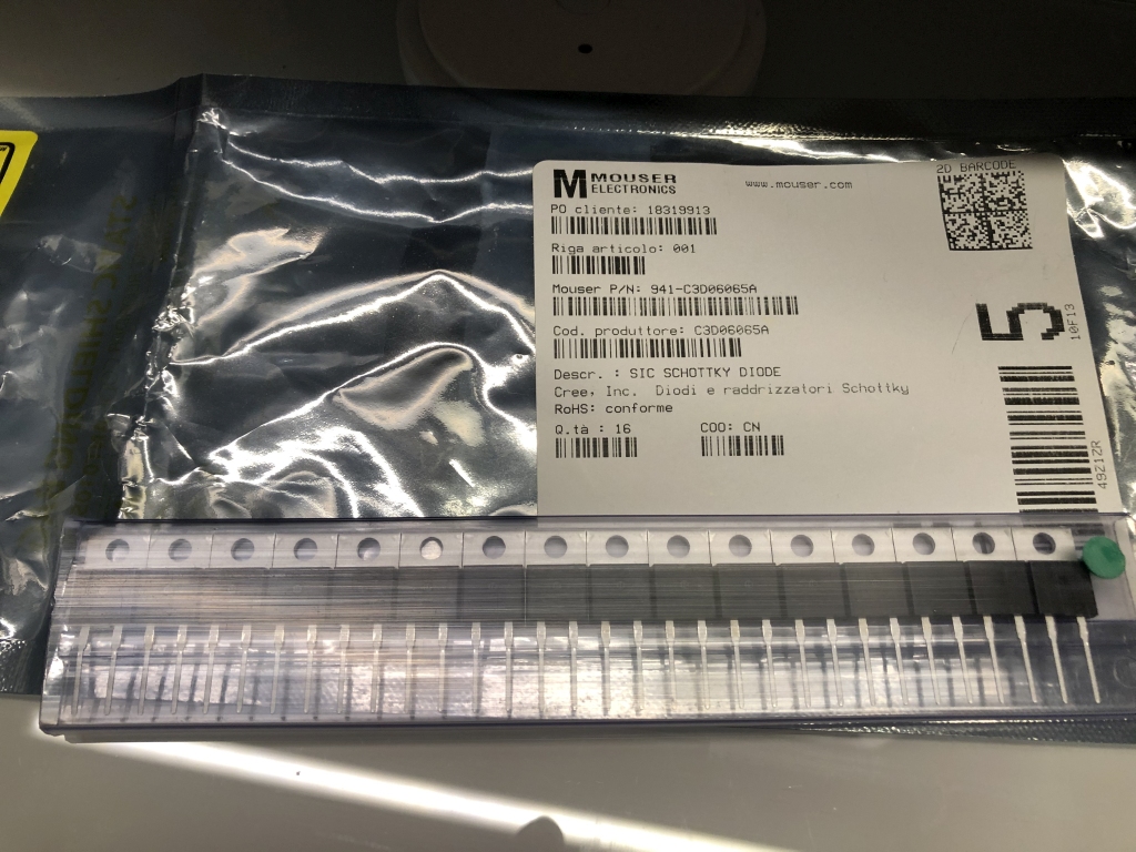

I saw mention of using Cree diodes in place of MUR820G. Did not see part number in BOM.
Which model has been tested?
These ones:
attachment.php
But, as you can imagine, I have yet to try them...
Others did and reported improved perceived sound quality.
