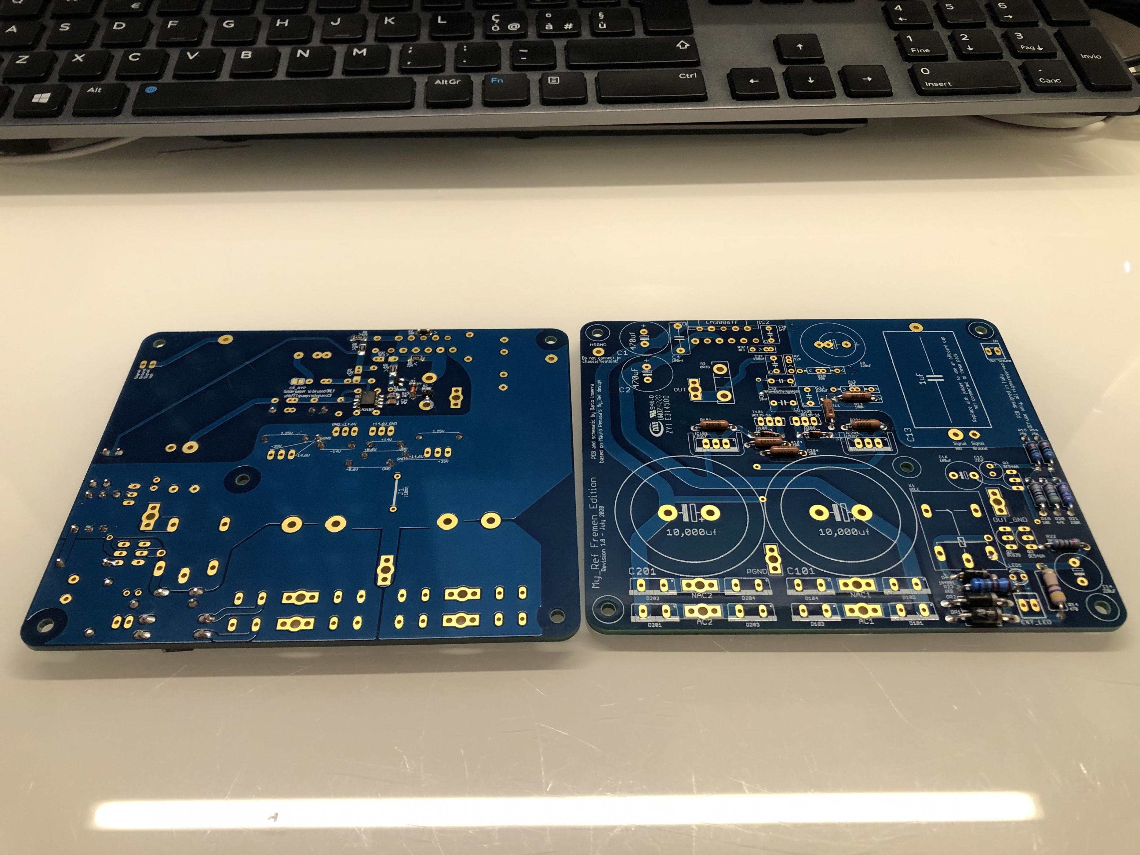

Boards up and running!

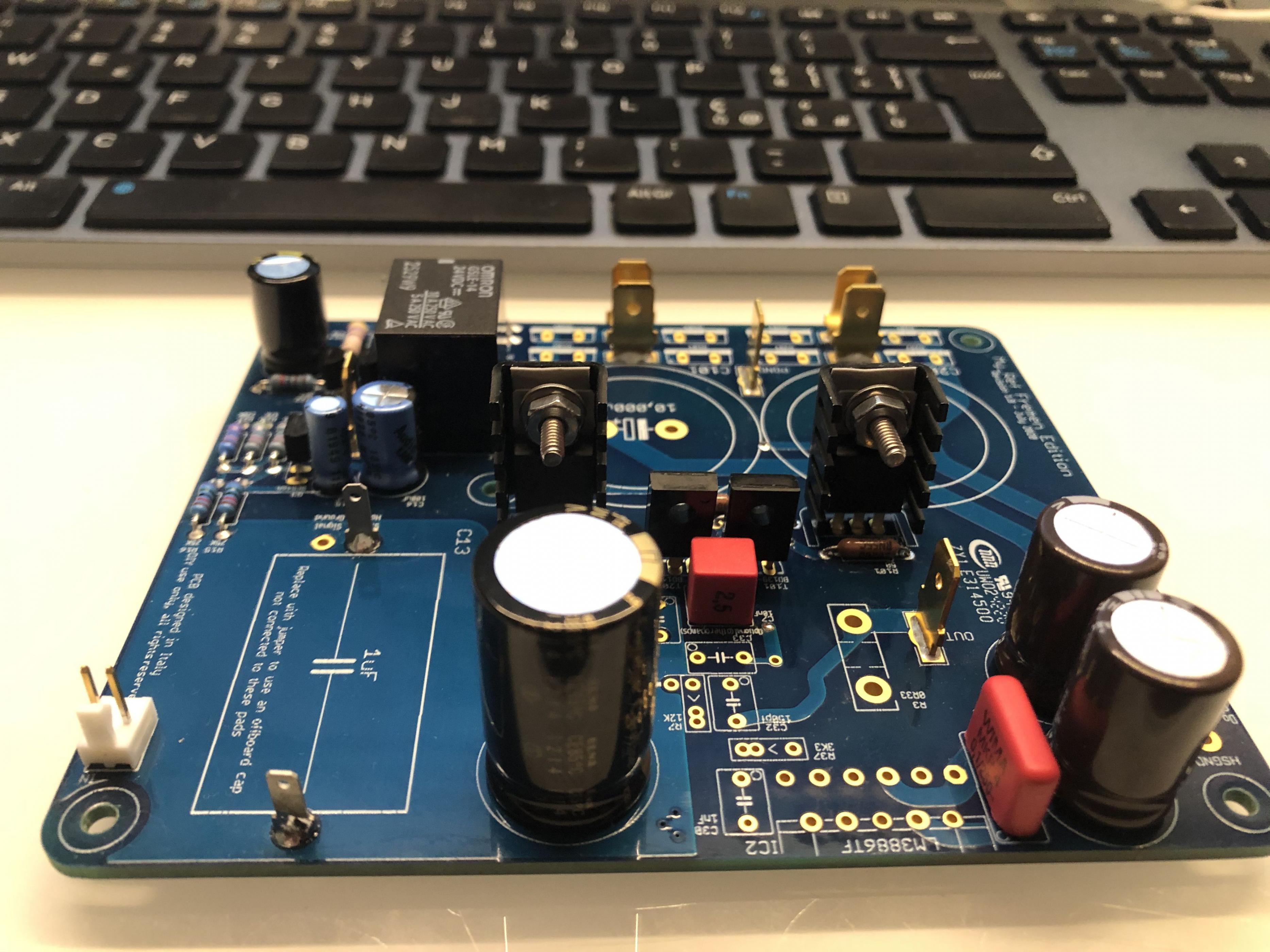

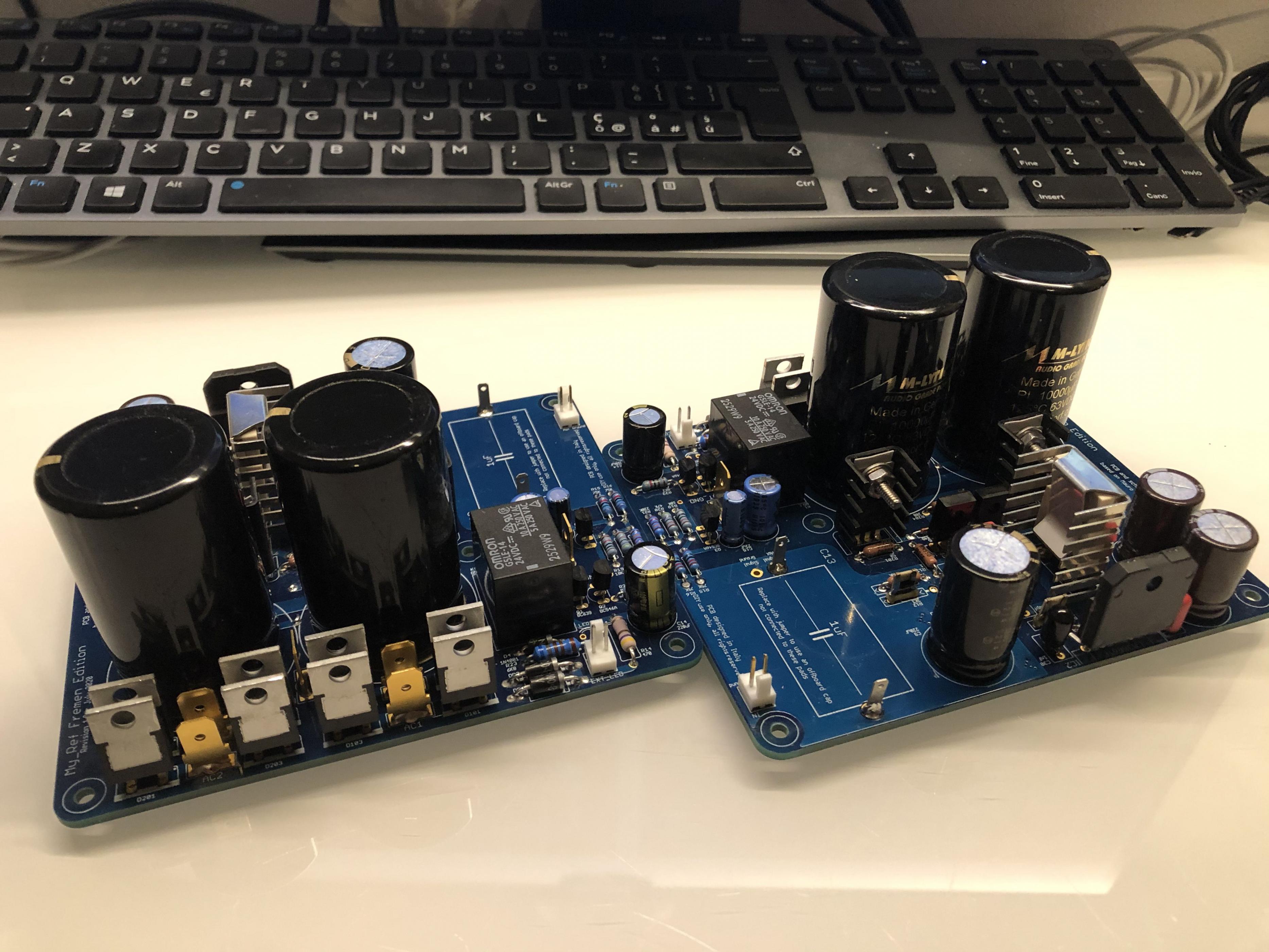

I've finally populated the test boards:
As usual they worked from first power-up 🙂

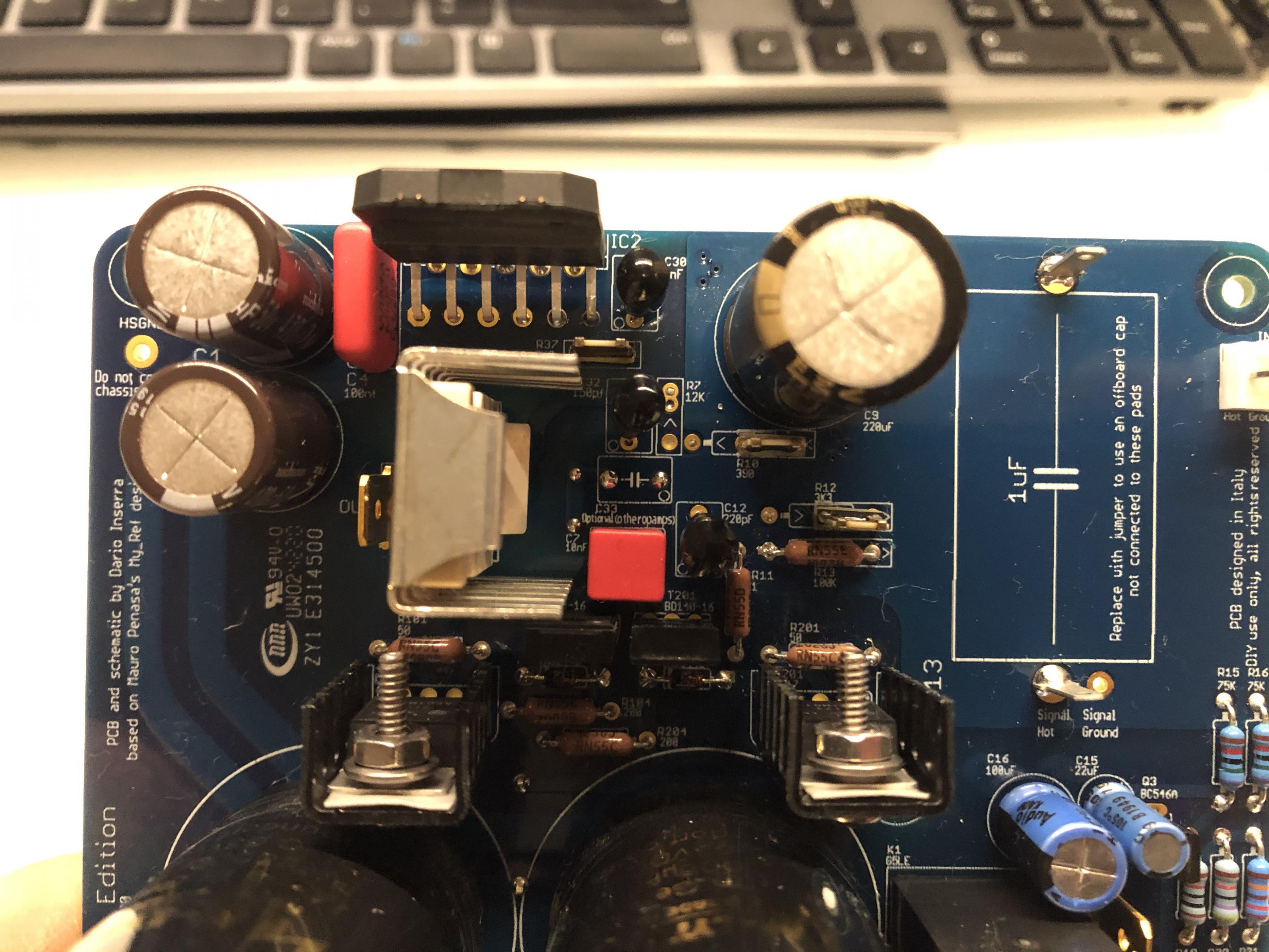

Sadly I've destroyed my R12 Z-Foil during transplant, so I'm listenting with a R12 Susumu... still sounds fantastic, though. 😉
Next week I'll pack bare boards and ship them, the week after I'll start shipping populated boards.

Sad about the Z Foil. No problem, but it looks like the OUT is pretty tight to the R3 Heat Sink. That is something that I didn't expect. I will definitely be using an insulated Faston.
