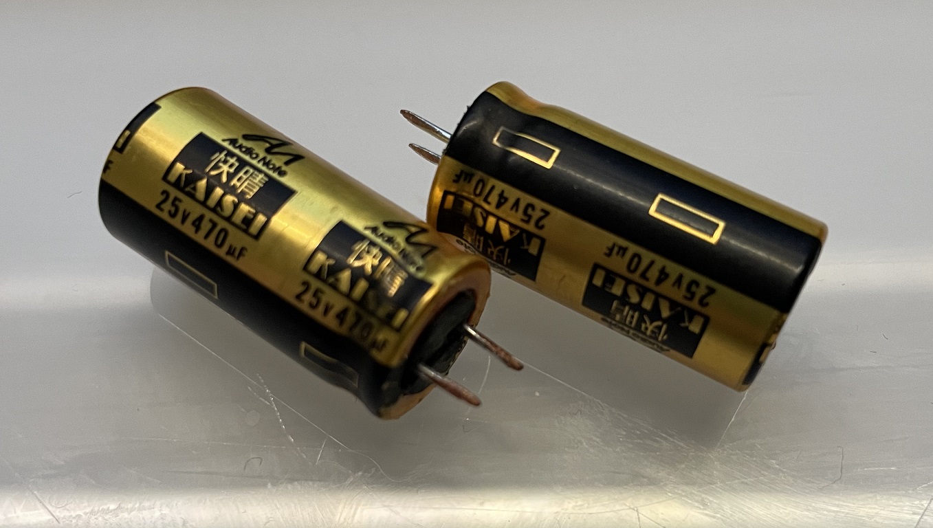

I didn't realize the Cerafine were no longer made, either. Has anyone tried the Audio Note Kaisei? Reviews suggest they are similar to Blackgate, but I don't know how they would sound in an FE.
Do you mean these ones?
attachment.php
I've tried them in 2016 when preparing the 1.6 BOM, if I remember correctly they sounded clear and refined but lacked bass.
