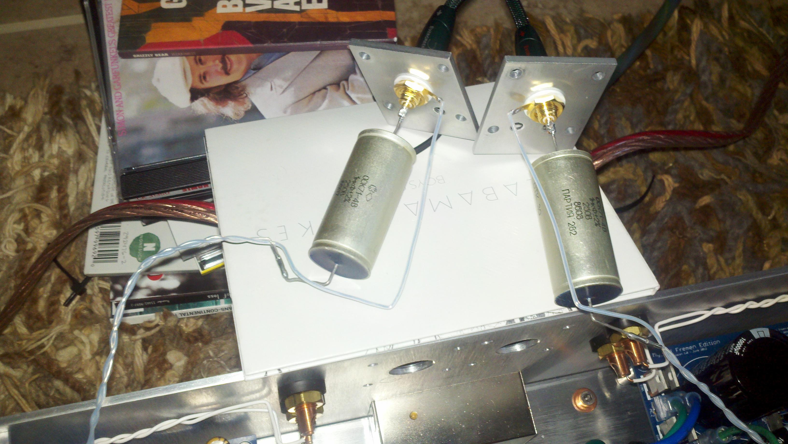

Bob, not to worry, all is not lost. I really dont think anything is wrong with the circuit, I think it is somthing I changed. Anyways I had the opportunity to try a few different "tests" today and here are the results.
The first ones were done while I still had the cheater in place or no safety earth.
I removed the caps and rcas from the chassis and connected everything outside of the case (as seen in the photo). The hum was still present.
I then removed the rods that support the caps. The hum became very faint and could only be heard with an ear to the speaker.
I noticed that if i touched the plate that the rca is mounted on it was audible through the speakers. (I should note that there is no continuity between the rca and the plate. I checked) I then re-installed the rca into the chassis again with no rods. The hum was like before, barely audible, but present.
I then removed the cheater and powered on the amp. The hum was present, louder than without the cheater but less than with the rods.
I then removed the rcas again and ran the caps outside the chassis. Same hum. When I touched the plates it was audible in both channels even though I was only touching one plate, and they were isolated from each other.
The most interesting fact is when I touched the body of the cap with my finger, the hum volume increased significantly. I really was not expecting this. Has anyone had any experience with these caps, and noticed anything like this? Is this normal for these and other caps? I was carefull not to over heat these while soldering and they still test right (they are still 1uf) Dario, or any others using these caps, did you notice any of this behaviour while these were mounted on the pcb?
It seem an interesting progress and seem to hint to some interaction between caps and environment.
It's passed a lot of time and I can't remember for sure if touching them produced hum but I think that I would have noted it.
BTW I remember of one post on one of the My_Ref C threads on Obbligatos having noise pickup problems (they have copper body).

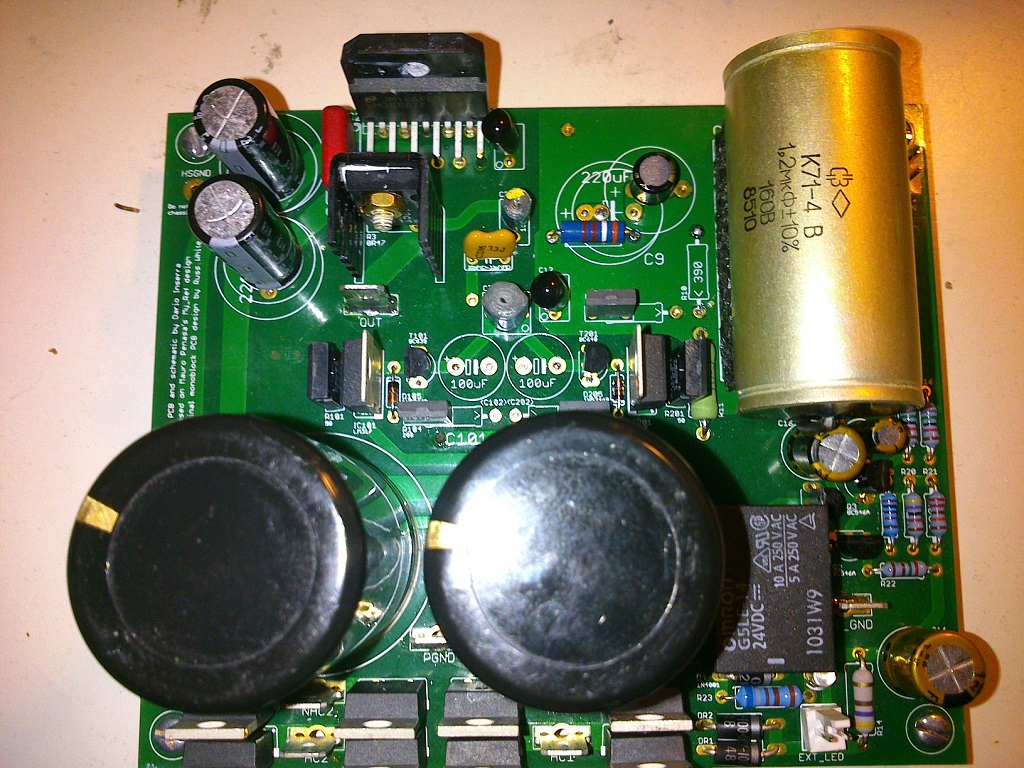

I've mounted K71s directly on PCB's pads bending leads and using a dense foam as support:
attachment.php
Bob, these are the only caps I have tried in this position. I will do some "shopping" tonite on partsconnexion etc. And see what's available. I am considering mounting these to the board to see if there is a difference.

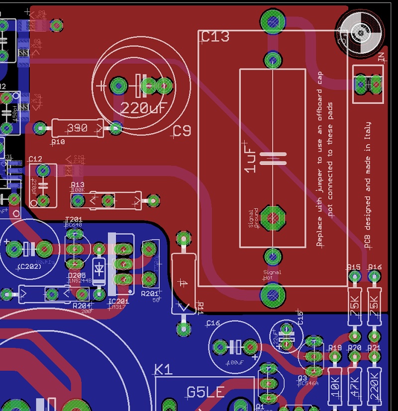

Is there somthing about the pcb that would cancel the effect these have?
Iirc the new true coppers are much larger and would need to be mounted off board . If the k71s are unusual and my c13 mounting system can be salvaged for other caps that would be great, if not oh well.:D
This is not specific to the FE, but I've noticed that NOS Siemens MKL input caps, which have a similar ungrounded/floating metal shield around the film/foil bundle, also pick up some hum from a finger or probe nearby. This happens mainly when the board is outside the cabinet for testing - when it's inside the aluminium cabinet, there's no trace of hum, probably due to Faraday shielding.
Just noticed that both old and new TCs have same behaviour.

I would like to know if they have changed size of 1,2 uF caps also. Have placed an order a few days ago but did not received the caps yet.
Anyway it is appreciated if you would update board layout to be more flexible in usage of different types of caps.
1543
I have received 1,2uF Audyn Copper caps from recent production yesterday. Size is 50 x 50 mm. To avoid them mounting offboard I have send them back and ordered tin foil caps instead. They are available for lower voltage ratings and have therefore smaller dimensions.
