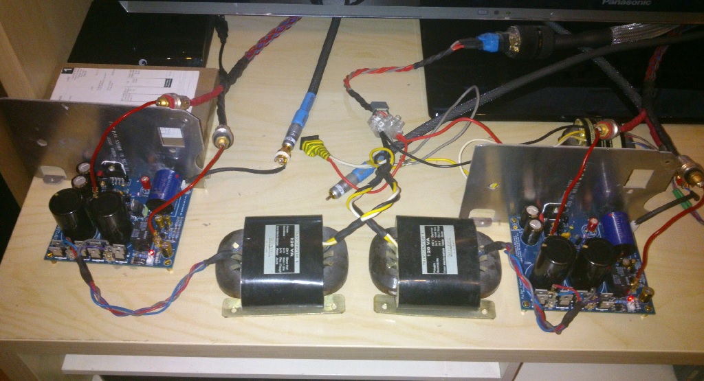

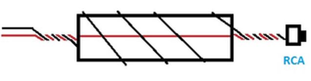

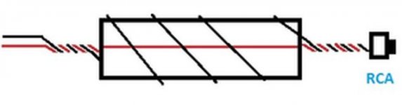

Andrew, it would seem the input caps "leak" and my thought was to isolate them from the ground by moving them away. Maybe I am going in the wrong direction here? Are you saying that I need to run the ground closer to the cap. Right now the wire runs are a fair distance away, would you suggest maybe even having the insulated ground connection contact the body of the cap? Thanks
I did some quick tests after work today with pgnd disconnected. I ran the grounds along the caps (taped to them) but had no change. I then split the wires around the cap so the signal ground was not close to the cap, again no change. I am not sure if the k71s have anything to do with the hum. What does the fact that there is no hum with inputs shorted and potentiometer all the way down tell me?

When you say no hum with the inputs shorted, are you shorting them at the input to the board or at the RCA? If you short them at the board and there is no hum, then I think it means that the noise of the hum is coming in between the RCAs and the board. That would seem to support the short run theory or some other antenna issue.
I have measured the voltage across the speaker outputs with the input shorted at the board and a couple of K71s on longish leads to fastons and measured less than 0.5 mV AC at the output. The actual readings are a flickering 0.1 mV, but the DVOM isn't that accurate that low. That combination also has no hum.
I'm starting to wonder if you have a individual K71 that is in some way contributing to this problem. I bought an 8 pack of K71s, so I have a couple of spare. I couldn't do it right away, but I would be Happy to lend you a pair if you find the source of the problem is the K71s. You might try any other pair of caps that are around 1 uF, just to see if it is K71 related.

The thing about it is both channels hum so I am hoping the same issue is causing this on each side.
Will, if you have a pair of RCA sockets please make two 'flying' leads (RCA on one side and molex on the other) and move them arount the chassis (branched, of course... 😉 )

Dario, great idea, I don't known why I didn't think of that before. The mounts for the caps are removable from the chassis with rcas intact. I will try that when I get home!
If shorted inputs equals no hum at all, then the hum is probably not generated by the amplifier. You most likely have a ground loop somewhere. The orientation of the hot or ground leads to the the input caps or the PCB or each other has nothing to do with it. Connect some other source to the amp to see if the hum goes away. What about taking the pot out of the circuit? Have you tried a different mains circuit? Is all equipment on the same mains outlet? Can you try a cheater plug for testing purposes only? (Do not permanently operate that way.) Have you tried different IC's? Does your previous power amp hum when connected the same way?
This amp, without a metal enclosure, will make ugly noises from mobile devices used nearby. Fully enclosed, no noise. Do you have the cover on the enclosure?

~0.5mVac on the out is a lot of hum................................I have measured the voltage across the speaker outputs with the input shorted at the board and a couple of K71s on longish leads to fastons and measured less than 0.5 mV AC at the output. The actual readings are a flickering 0.1 mV, but the DVOM isn't that accurate that low. That combination also has no hum........................
I expect even a stereo amplifier to have <0.3mVac for "normal" speakers and usually get ~0.1mVac.
In a monoblock there is NO reason to accept even 0.1mVac of hum on the output, I aim for a 0.0mVac reading on every monoblock with a shorted input cable 1m long. That should be an indication of Hum + Noise <0.05mVac as best as a low quality hand held DMM can manage.

Tom, I do have everything connected to one circuit. The ground is functional on this circuit. I have used the exact same setup with my integrated with no problems. It is an audiosector LM4780 dual mono build, nearly identical layout inside the enclosure. The audiosector boards do have a connection to ground in the enclosure.
I did use a strip with no ground pin while testing the FE in the shop and if I remember had no hum. Let me verify that.
...With the cheater in place and pgnd disconnected there is still hum.
How exactly does pgnd work? does it capture/redirect the signal at a certain frequency? What would I be gaining by not having it connected, less potential crosstalk between channels?
