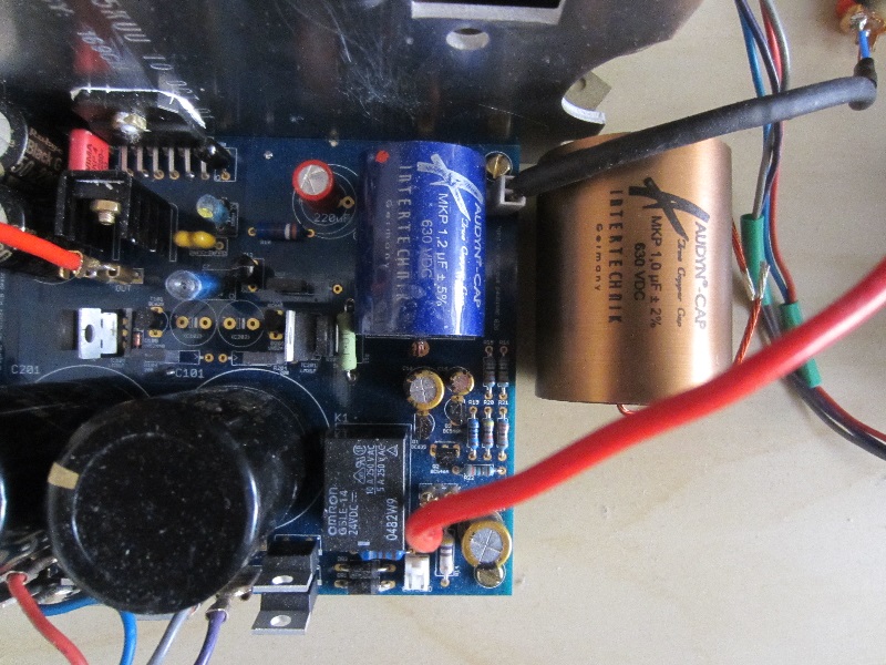

Change in Audyn True Copper
I've at hand a pair of recent production Audyn True Copper (1uF) and they're way bigger
So they must be mounted outboard now.
I'm thinking to update boards to allow slightly bigger caps like Audyn Cap Plus or Clarity Cap MR 400V and to add a bigger pad for ground input in case of outboard caps:
I would like to know if they have changed size of 1,2 uF caps also. Have placed an order a few days ago but did not received the caps yet.
Anyway it is appreciated if you would update board layout to be more flexible in usage of different types of caps.
I think this reflects the fact that Audyn caps are used mostly in speaker crossovers where there are fewer space restrictions. I made some of the pigtails Tom talked about but haven't installed them yet.
I got mine yesterday and was in fact wondering how would i fit them... any possible problem due to the length of the leads?
Anyhow this allows me to use the unenameled part of the lead, avoiding the use of the solder pot
Audiophonics.fr has got stock of audyn true copper 1uF for 25 e. Plus delivery
That's where i got mine from
The TC in pic came from Audiophonics too.
Just did some listening tests.
I would say the new ones have similar detail but I would say a somewhat different timbre, now passing the Isotek... let's hear after.
Tried the Audyn Cap Plus too, they're better than Vishay V-735 (the industrial cap in BOM), maybe, and cost less.
Not as goos as the TC, obvioulsy.
Dario,
Can you give the length and diameter of the new TCs?

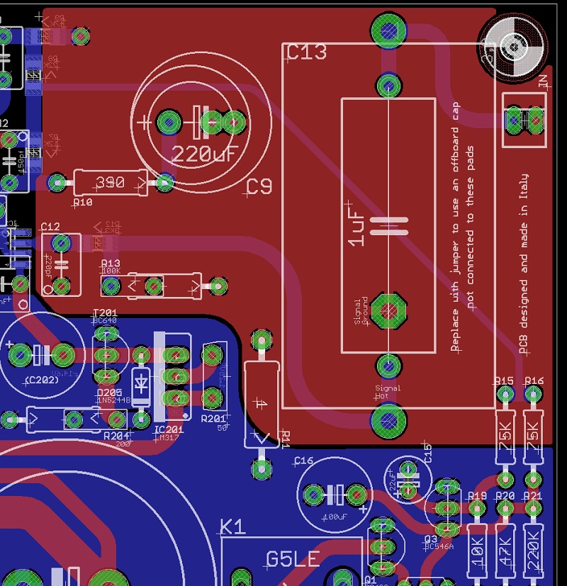

Also, regarding the board modification, I'm not sure I understand how you were imagining use of the new signal ground. Can you explain a bit more, please?
I've been thinking about a comment Andrew made recently. To paraphrase, the inductance loop between the signal and the return path needs to be as small a loop area as possible for the best high frequency sound. If you are using a bypass cap (as I am), it is the high frequency path and should be as close to the return path (ground plane, for example) as possible. If only one cap is used (Audyn TC and most others), then the cap and the return path should still have the smallest loop area possible. I think that is what you are trying to do for an off-board cap mounting, but I am not clear.
Jac
5cm x 4cm (old ones where 3.6cm x 2.6cm).
I suspect they're the old ones incapsulated in a tube filled with resin, maybe for better damping or whatever...
Simply it gives an alternate way of mounting offboard caps.
The original planned way was to connect the cap to RCA hot and then using a traditional wire with molex plug to the molex connector on board (C13 position shorted on board).
With the new signal ground (yet to be finalized, in this moment it's only an idea) pad it's possible to connet the cap directly to the PCB (no need to short C13 position) mantaining a small loop with the hot side of signal.
But as I'm writing it I'm thinking to leave it out, I still prefer the original way of connecting an outboard cap...
The new TC seem to have a slighlty different timbre, they sound really great but a bit more open (or less full if you want).
They're pretty fine.
Less refined and full than TC (old and new), though.
Sure. As usal the effect was not irrelevant...
Phew! I'm lucky I like them, then...
Dario,
Thanks for the measurements. Those things are big!
Now that I understand what you have in mind for the new signal ground, I like it. I had thought of doing something similar on an RC board using the ground end of the R10 connection that has been removed in the newer boards. I would encourage you to include the new signal ground because it is easy and doesn't negatively affect anything. The only suggestion would be to rotate the new signal ground away from the direct return line of a traditional C13 mounted on the board.
Alas, I have already purchased enough boards to cover all the projects I can think of at this point, so I'll have to work out my best solution on the existing boards.
Jac

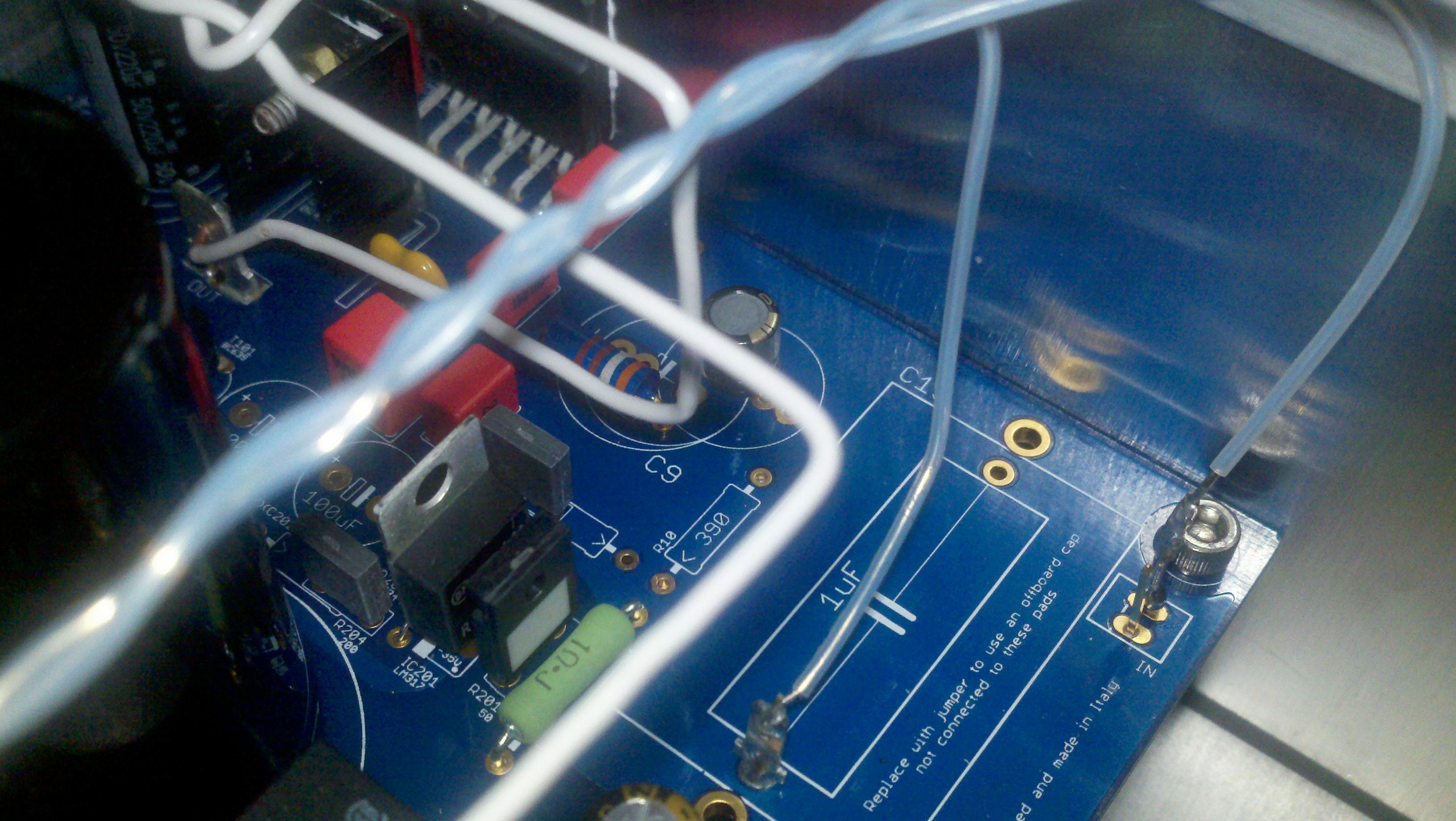

Dario, on the topic of offboard caps and Andrews comments. Right now my input ground is mounted at the standard location (the molex connector pad) but my input hot is connected at the furthest point from the ground and no jumper was used. What effect could this distance have? Do you think it is worth experimenting with a jumper?
