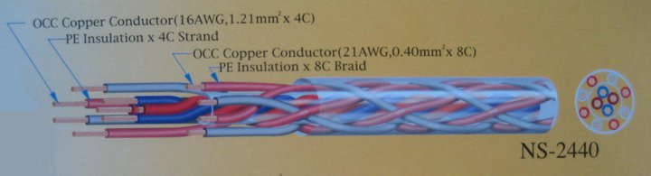

I'm using too a braided construction Neotech cable but capacitance is much lower than CAT5/6 speaker cables...
The NS-2440 has around 200pF/m Vs NS-1952 108pF/m
A braided CAT5 cable (16 conductor) should have around 700pF/m capacitance...

First, I wish I knew where the audio range capacitance of a CAT5 cable really is. 700 pF/m is higher than any quotation I've seen. The CAT5 spec is for less than 52 pF/m for the full CAT5 cable, but is only measured at 800 Hz. I have no idea what happens at higher frequency, but the cable is rated at a corner frequency of 57 kHz. Not bad.
My idea was to strip out either a single twisted pair or maybe 2 pair to use as a hook-up wire. Shouldn't that be a lot lower capacitance than a 16 conductor braided cable?

I think I'm missing something. Please explain where I am going wrong.
My fault, I assumed you were talking about speaker cable...
CAT5 wire will obviously work fine for internal signal wiring but it tends to be less detailed and 'alive' than good quality wire.
