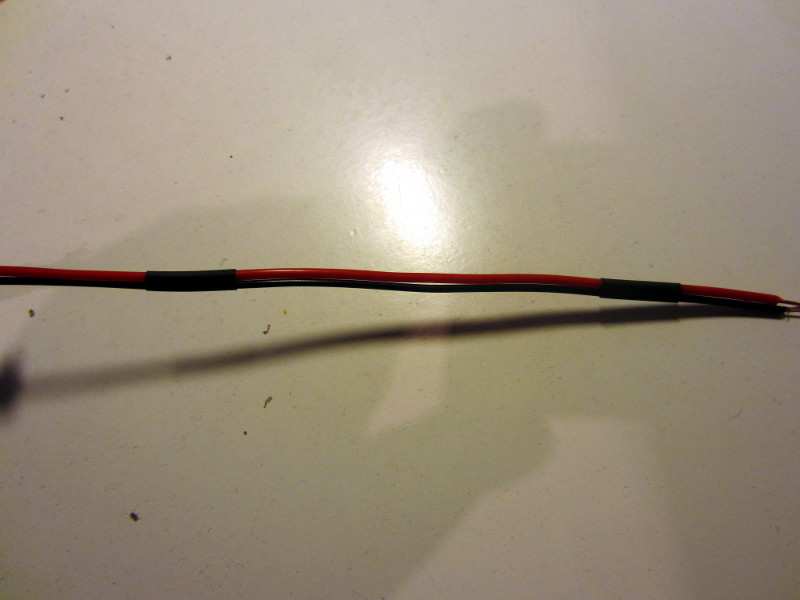

Just realised no way I am going to use maplin hook up wire with this build. What is your choice for component wiring ?

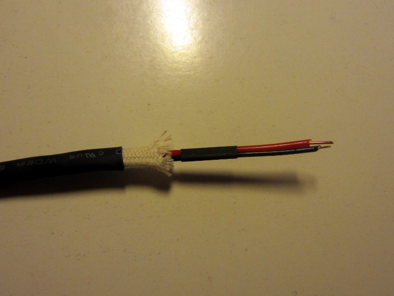

You can make a very good cable using this OCC wire.
Use 0.45mm for signal and 0.70mm for ground, run them parallel with cotton tubing and polyolefine heatshrink.
But buy it only if you're willng to determine correct direction, OCC wire is directional (the correct direction sound fuller, the wrong one dry and more reverberant).
Otherwise a balanced OFC cable will do a very fine job.

Asked question but only now I see cotton tubing and polyolefine heatsink.. need to figure out what and how now.
I like the idea of doing maximum diy within given build though.

But remember the bigger diameter conductor is ground, ignore colors on pics.
This sort of cables is partly inspired by a Eichman patent.
The cotton tubing and heatshring dampen (or are supposed to) vibrations.
