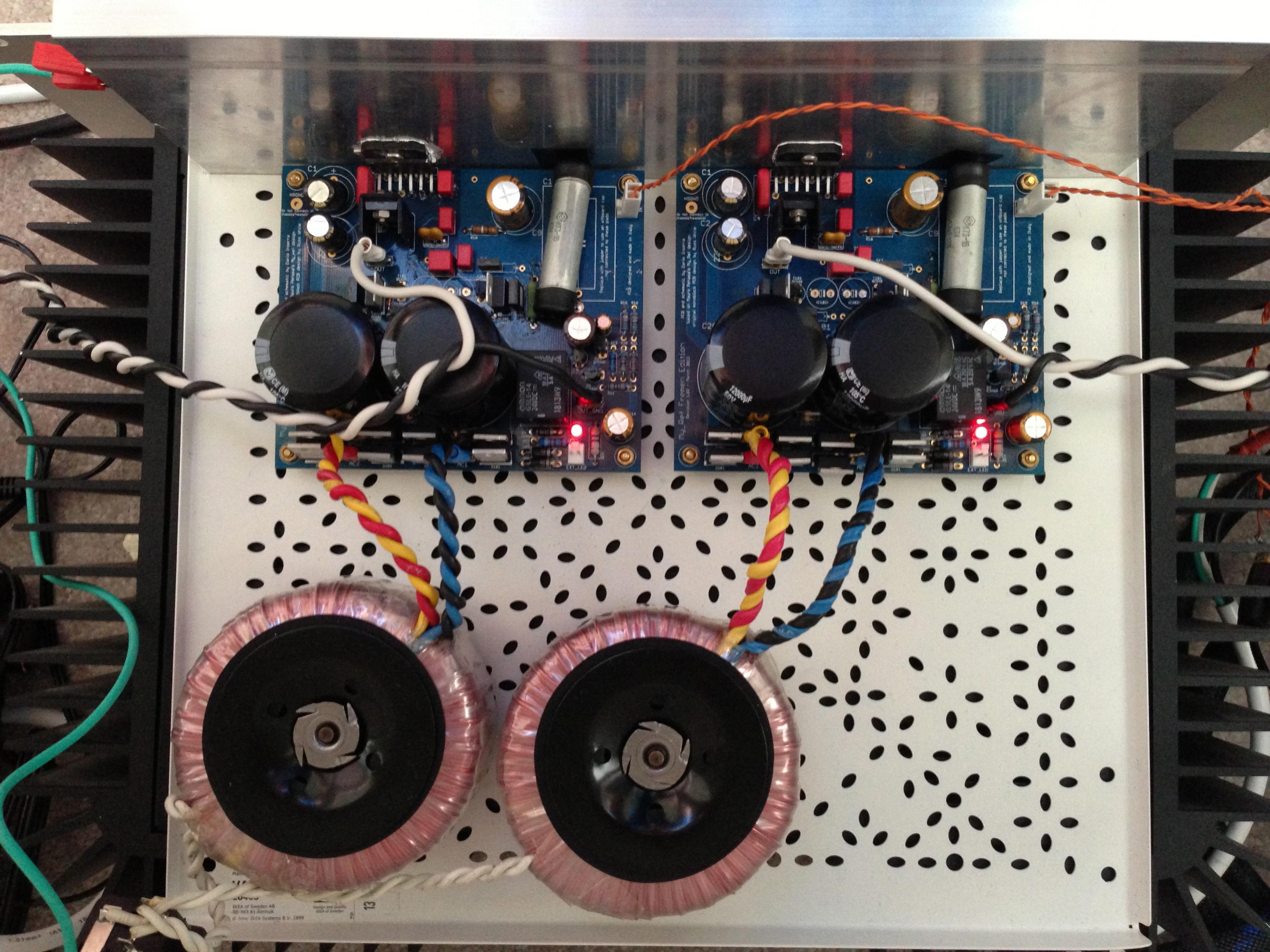

A big thank you going out to Dario, He just finished helping me troubleshoot my amps. I seemed to have swapped c30 (1pf) with c7 (10pf). The 10pf in C30 was extending the top end. It might be worth trying if you are using a full ranger and lacking sparkle.
I am very happy with these amps connected to my modified Klipsch CF-3's,
The sound is fast, airy and true. The top end is very revealing and will kill a bad recording.
Here is a photo of my amps running.
