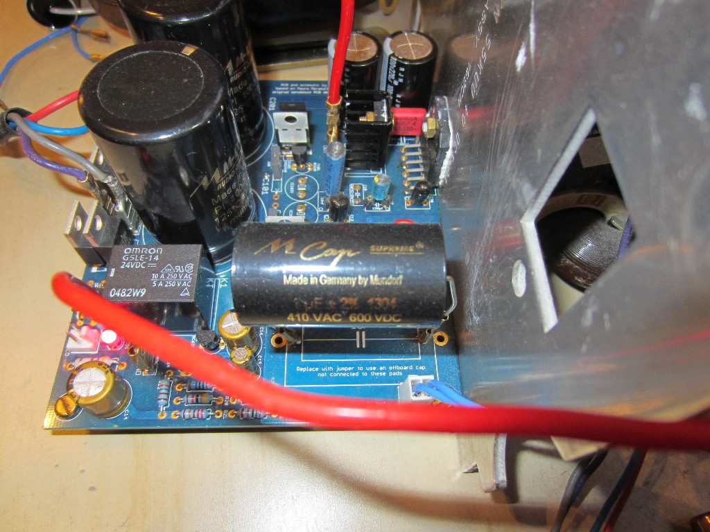

I want to amend some comments I made recently regarding R10.
I recently installed Mundorf Silver/Oil capacitors in my tweeter (ScanSpeak HDS) crossover circuit, and that has provided my system a new level of resolution and refinement. I now realize that my previous judgments were in error. After extended listening in room and careful listening at close range, it is apparent that the Shinkoh resistor I favored might not be the best for that position. I'm not sure yet that the Riken is the best either.
I can definitely hear more "ting" on cymbals and a bit brighter edge and more emphasis on highest frequencies from the Shinkoh. The Riken provides more ring or shimmer to cymbals with a softer edge and a slight rounding of high frequencies. Upper midrange of the Shinkoh is a bit sharp on brass and highest female vocals but better defined and more forward, while the Riken is sweeter and more musical with fine "inner" layering, but just a bit too smooth with some loss of definition and impact, slightly recessed. This is in direct contrast to what I previously believed. I prefer the more musical sound of the Riken overall, but I am not satisfied that it provides enough detail. I think this is the contradiction that plagues most stereo equipment. I'm not saying which is better -- more detailed or more musical. I cannot say anything about bass performance because of the system configuration.
These findings were first determined without knowing which resistor was in which amp. Amps were swapped between channels during the trial, and the difference clearly followed. Imagine my surprise when I removed the covers. I am not afraid to admit I was wrong. The search continues. Every part matters.

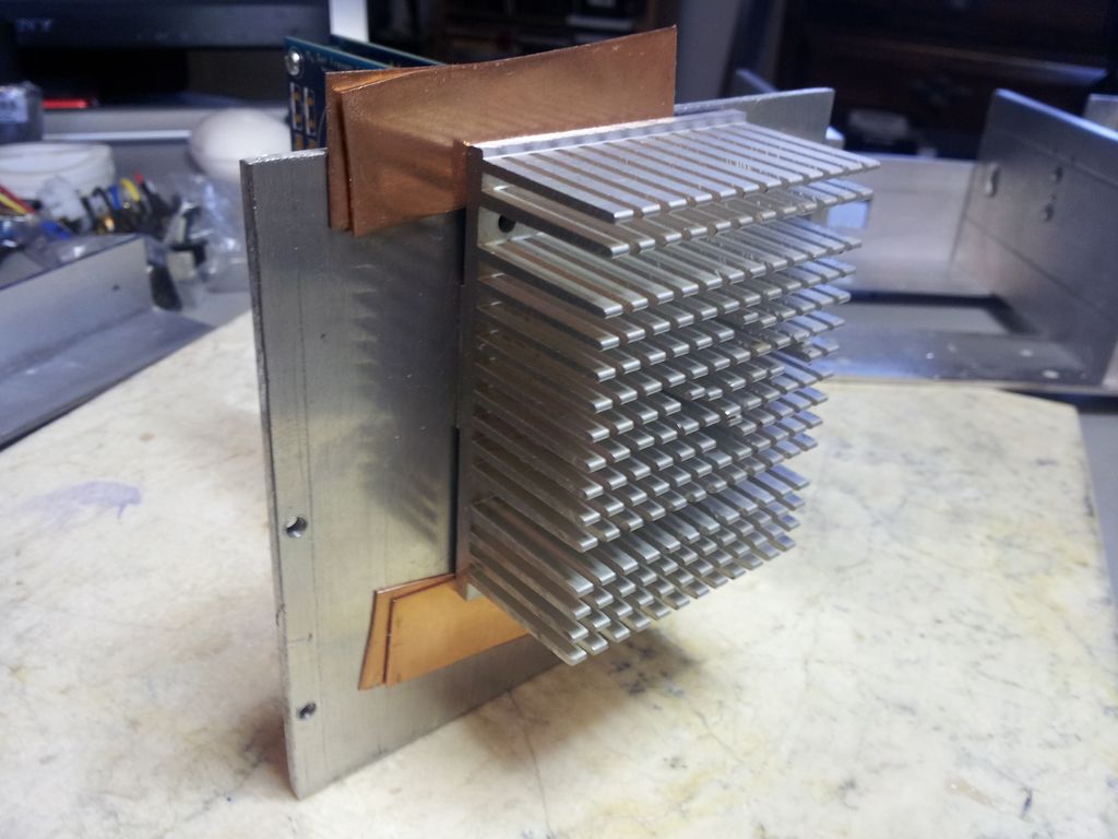

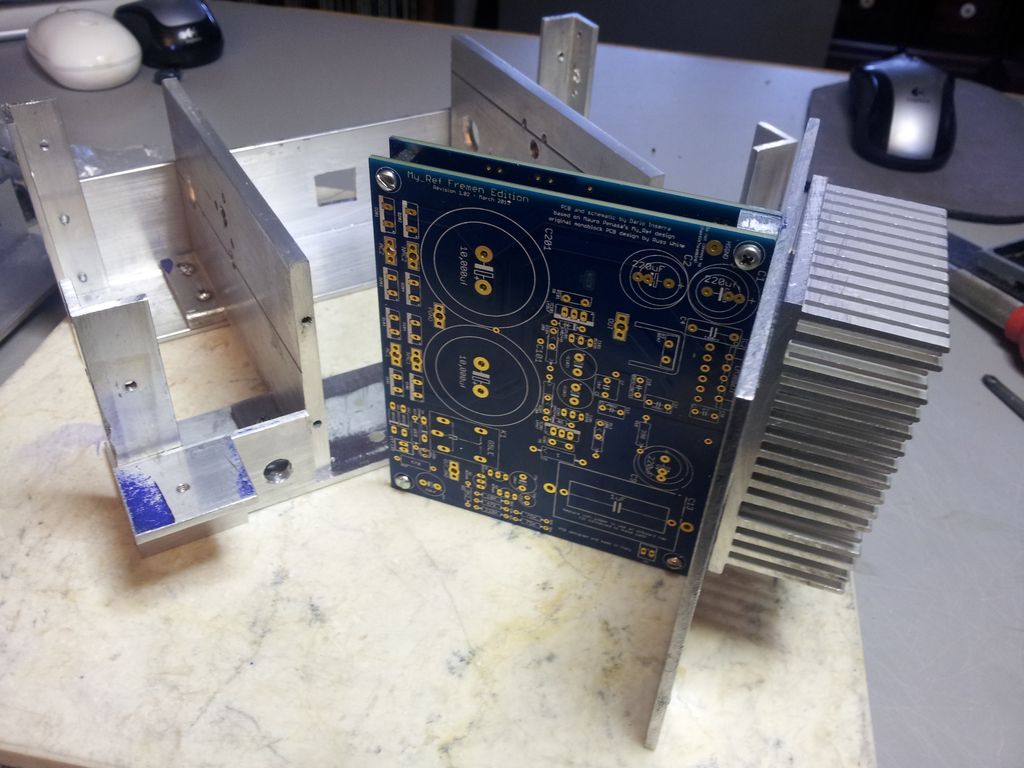

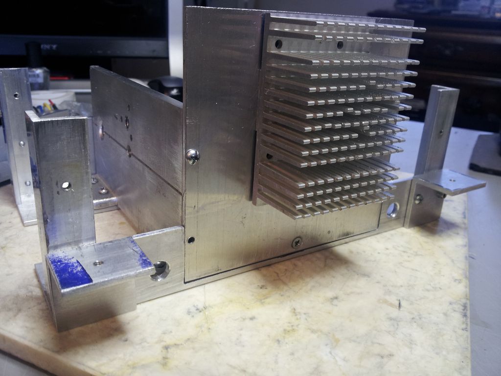

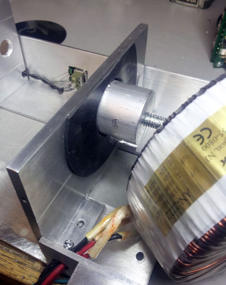

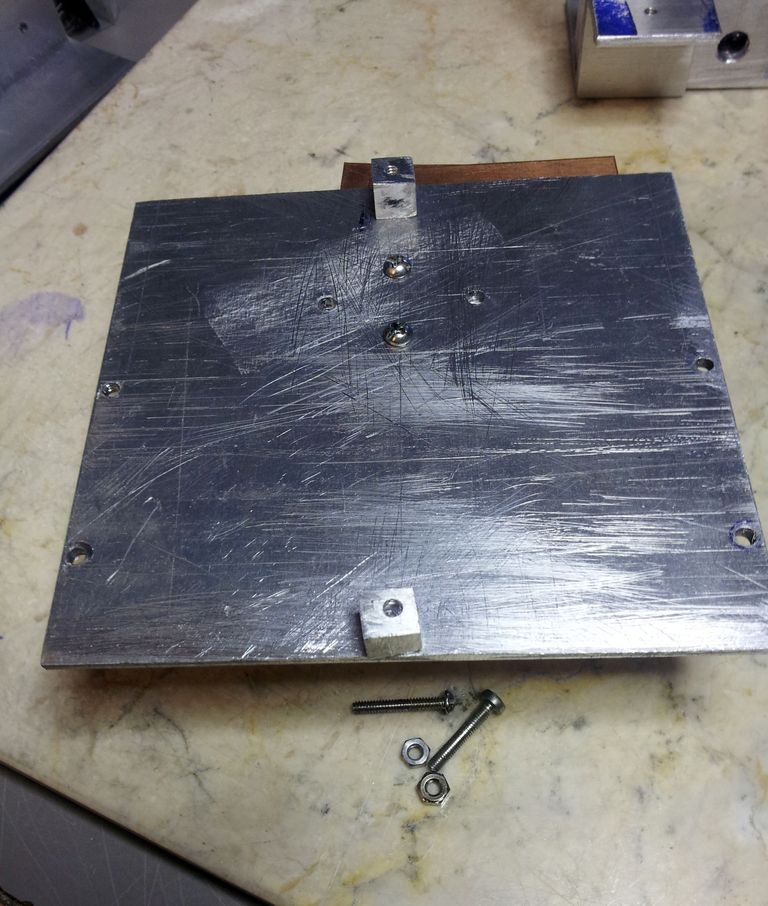

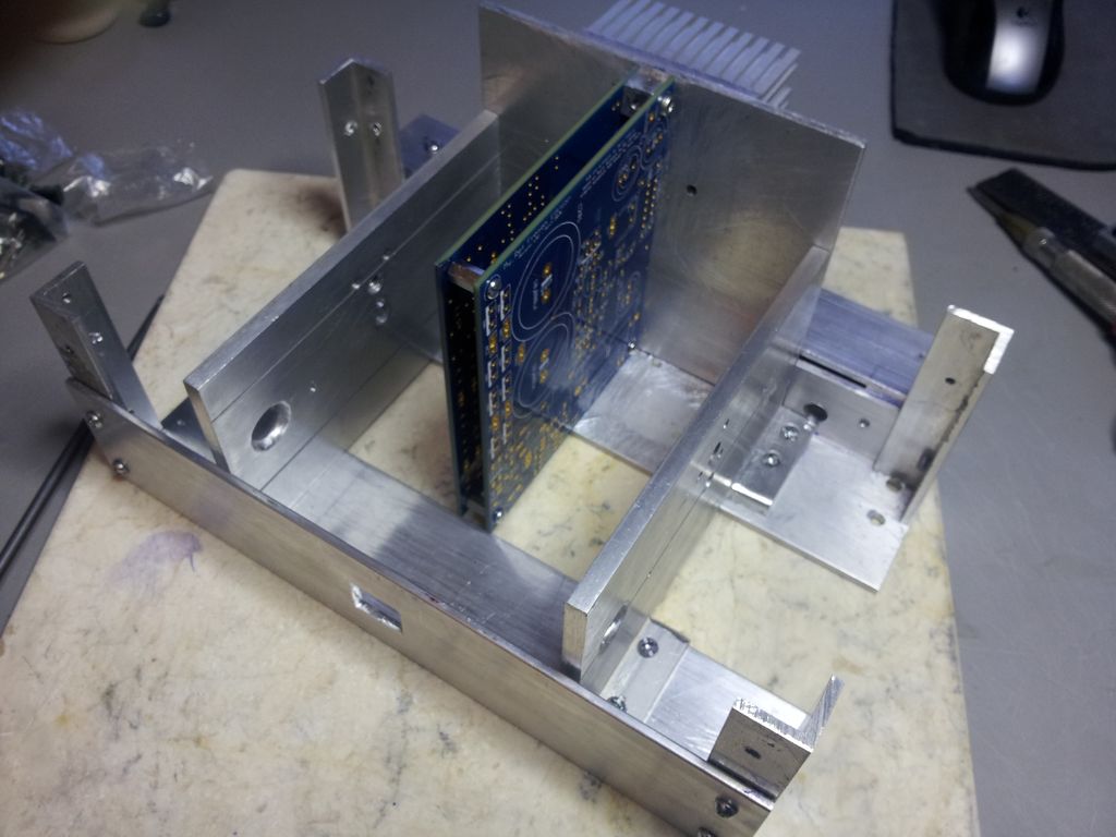

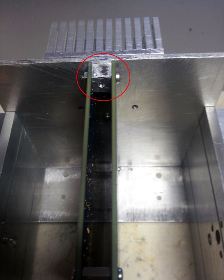

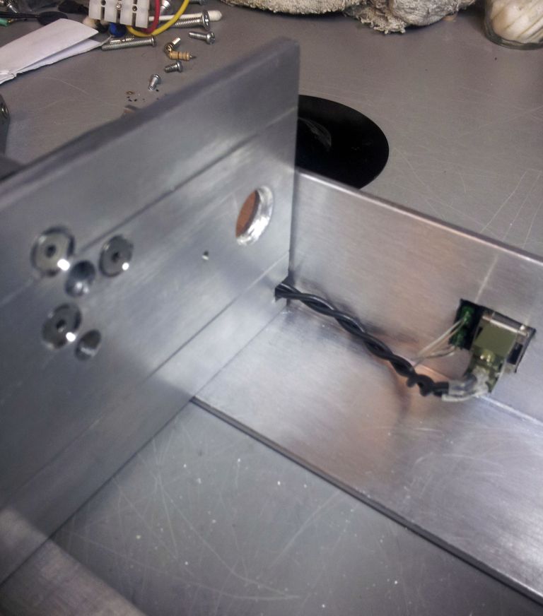

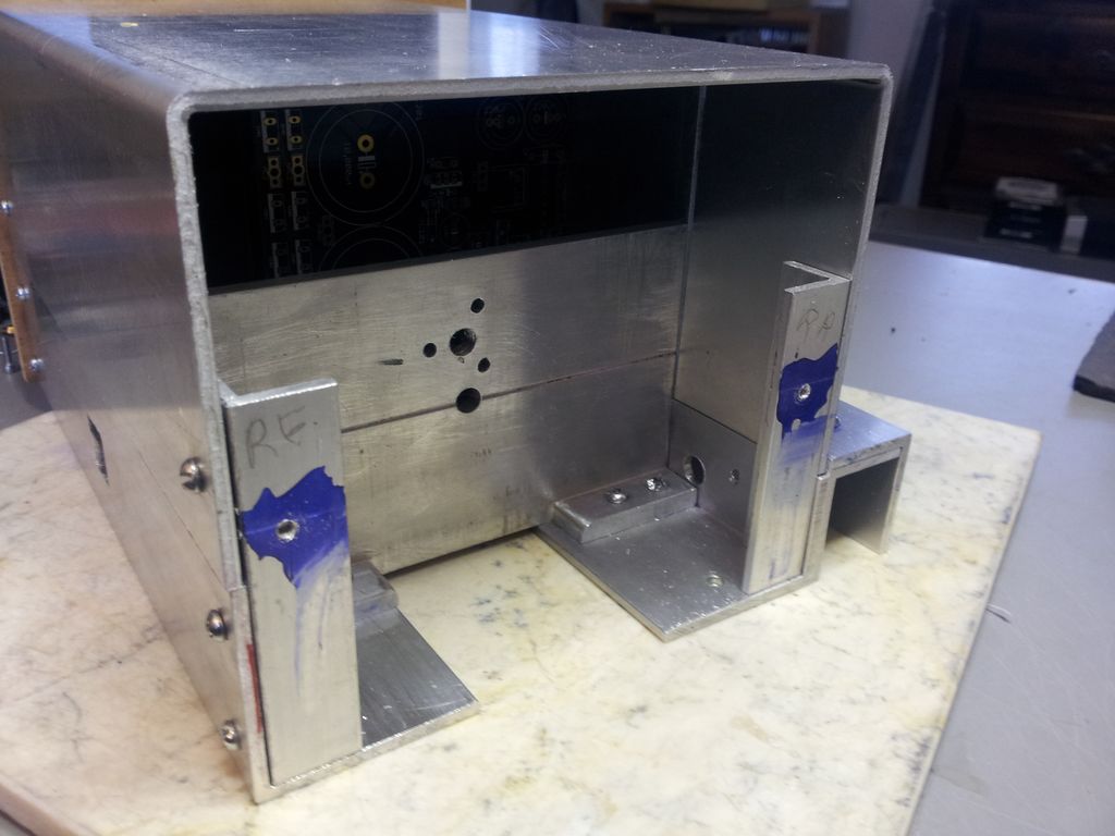

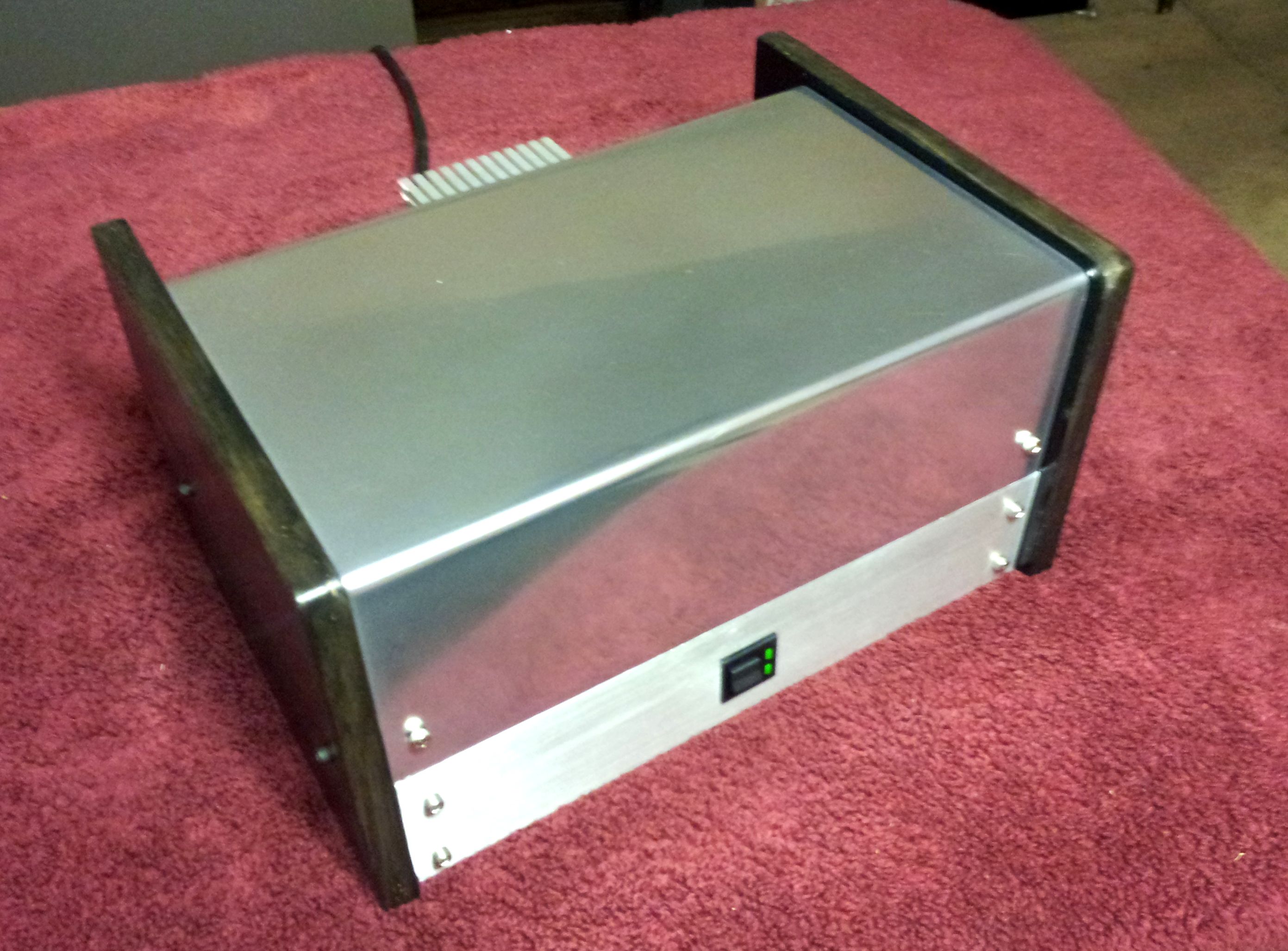

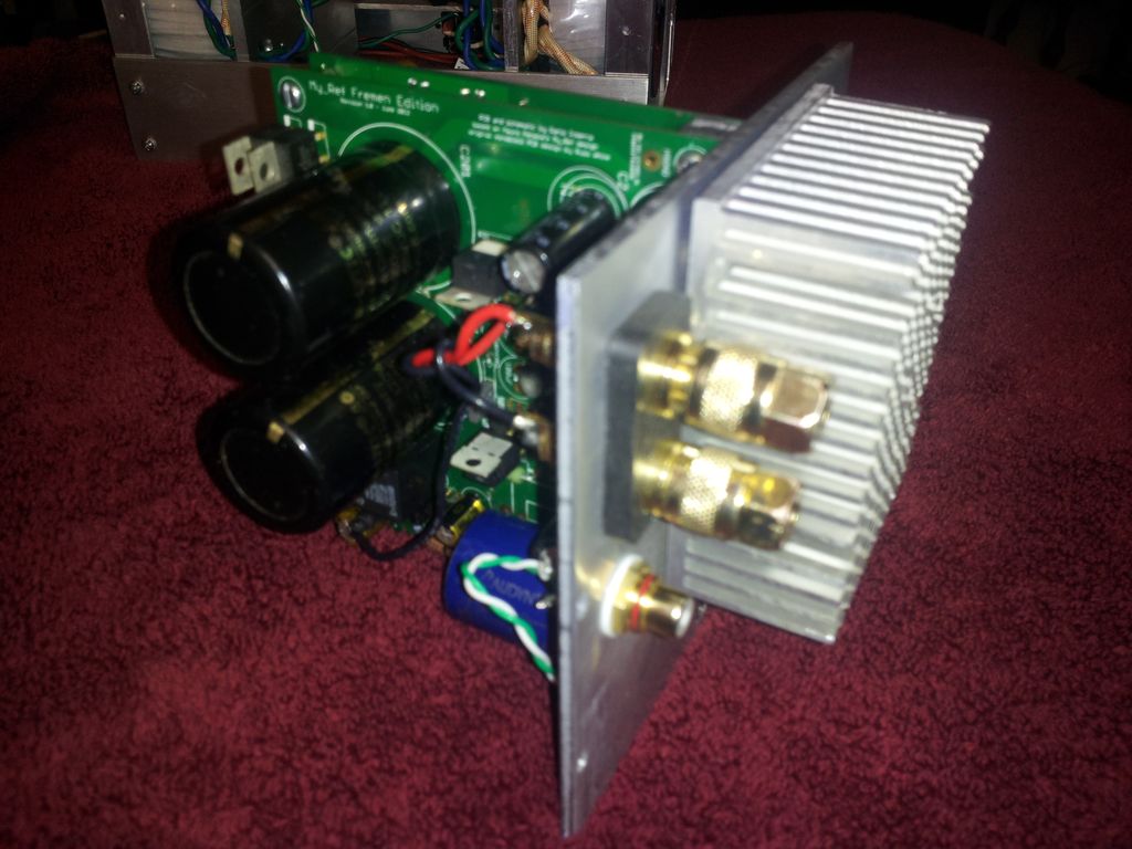

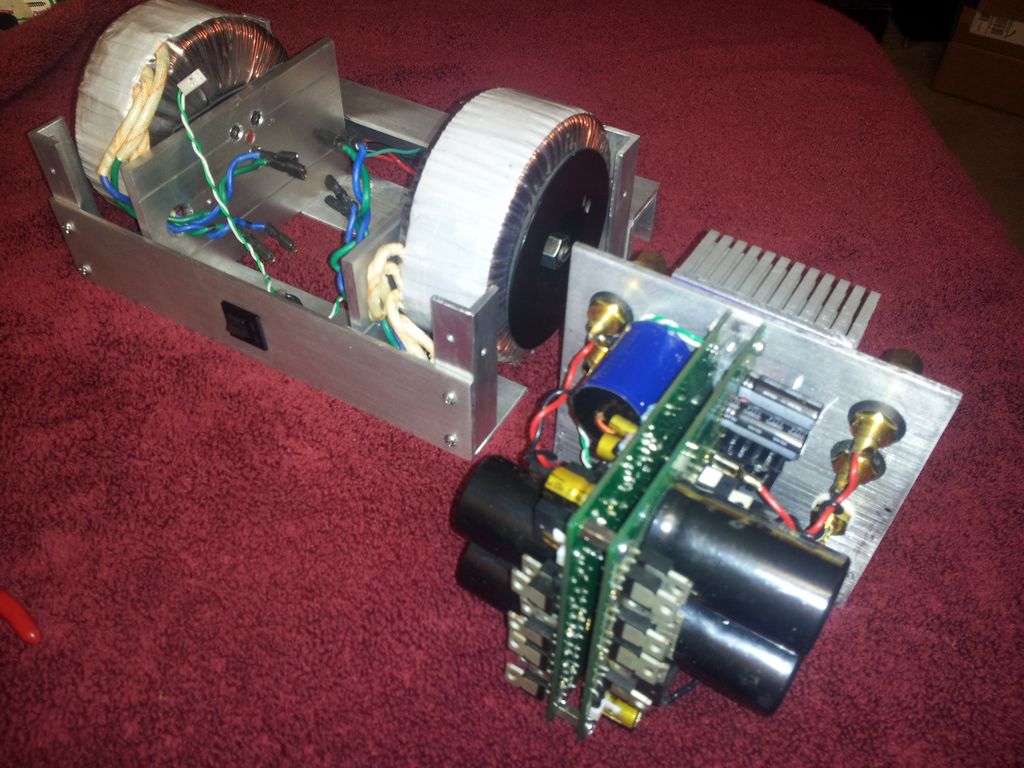

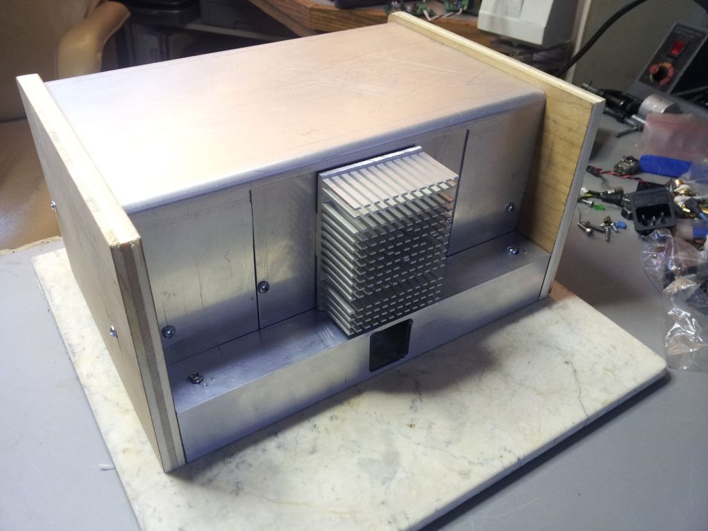

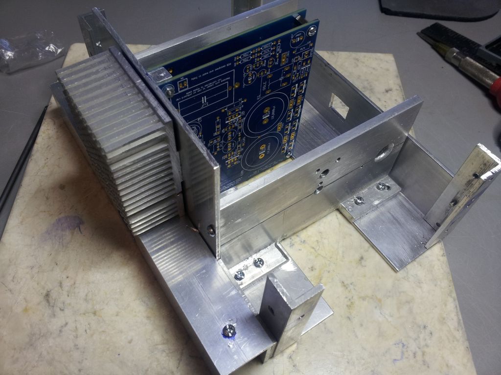

The Wooden Bucket recovery is complete. Added some new pieces and some parts from the first liquid cooled experiment. Sizing and placement was done around two FE final boards. The transformer brackets are from 3" X 3" X 1/4" aluminum angle with everything else 1/8"
The 5/16" trani retention bolt is again secured to a slice of solid round stock with three back anchored anti rotation screws. Two metal tabs now hold the PCB sandwich top and bottom. The LM3886 chips are on flat-head bolts from the back and a hex nut on the inside.
Copper strips were added to fill the gaps between the mounting plate and the heatsink.

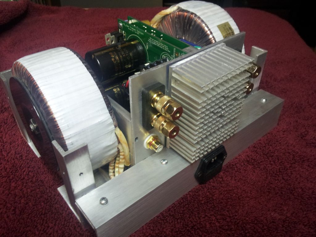

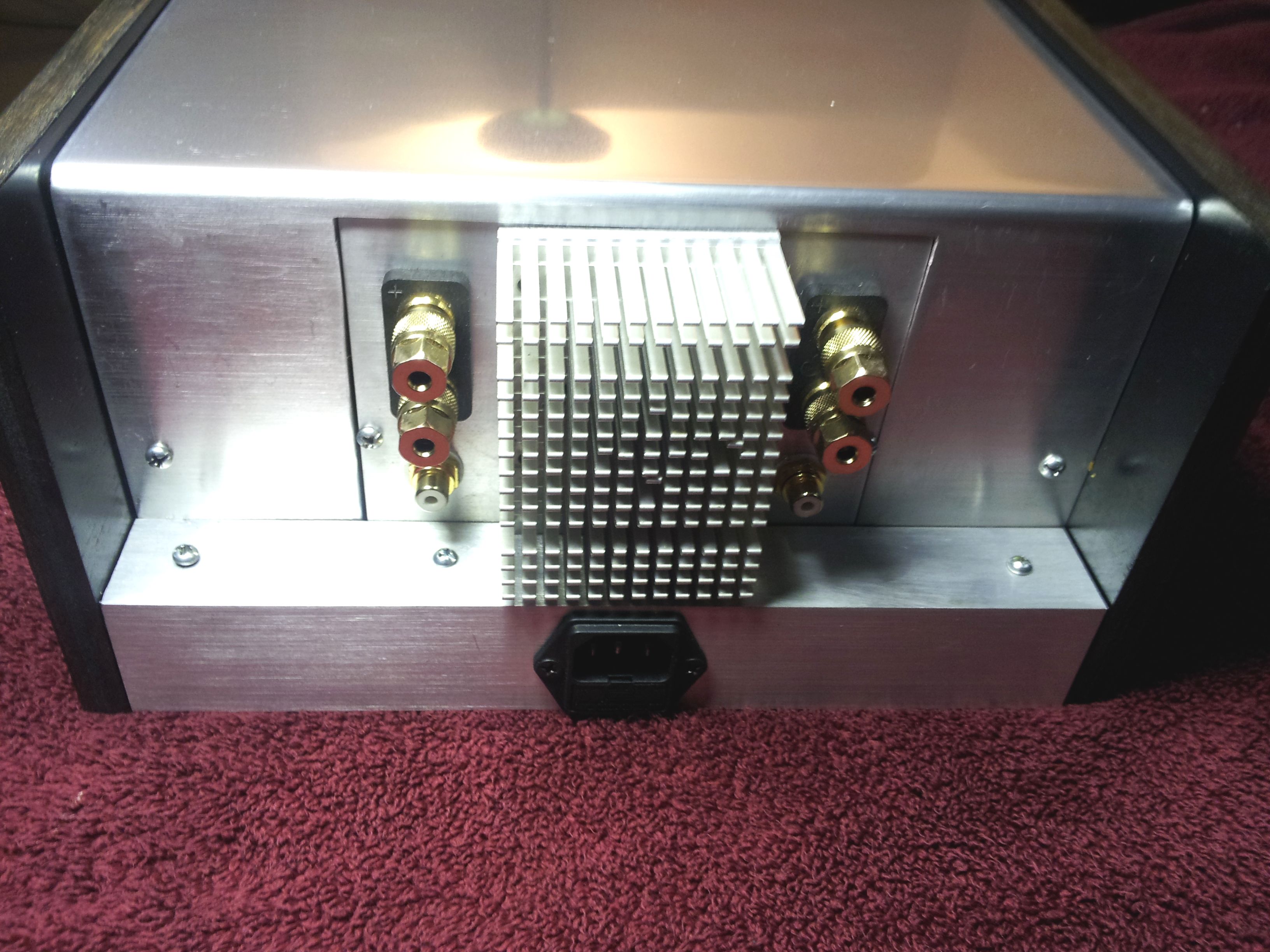

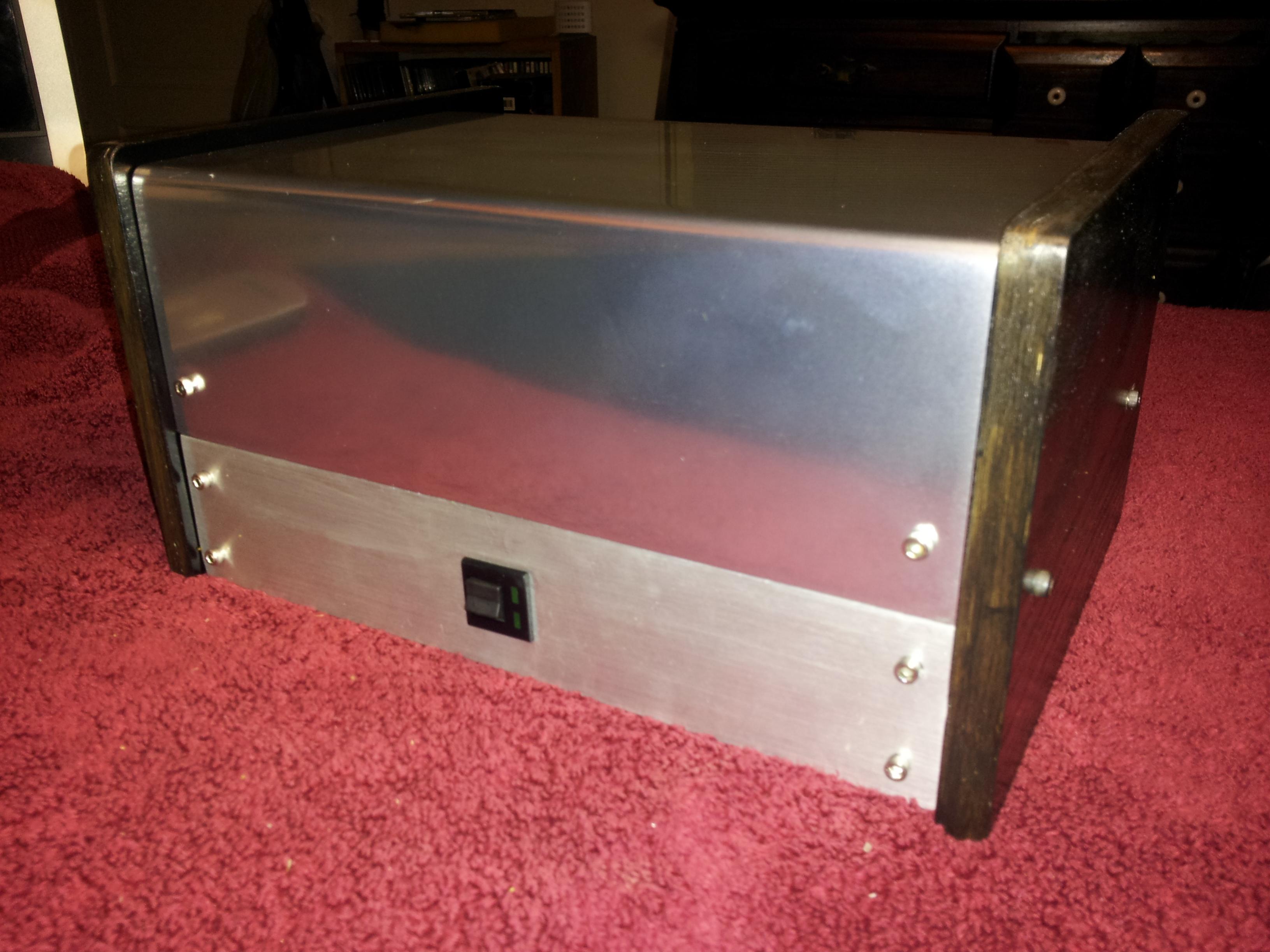

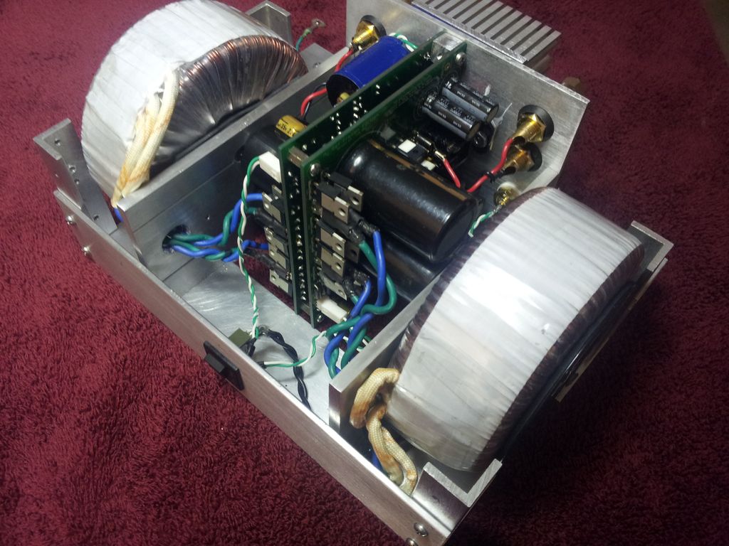

The amp module is a complete build needing only power and LED connections. Mains power is also a self-contained module.

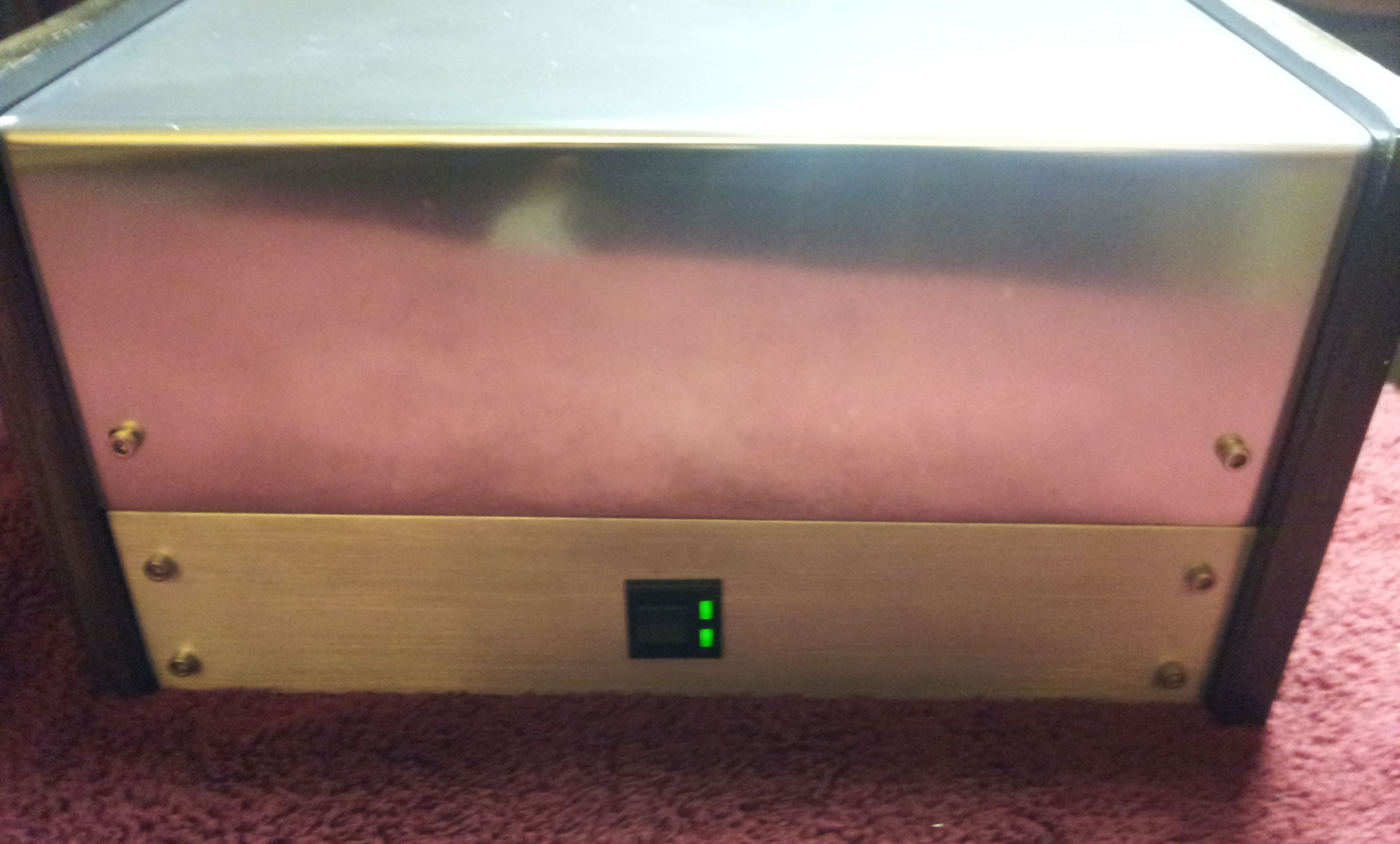

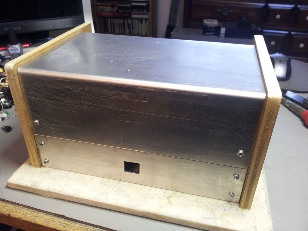

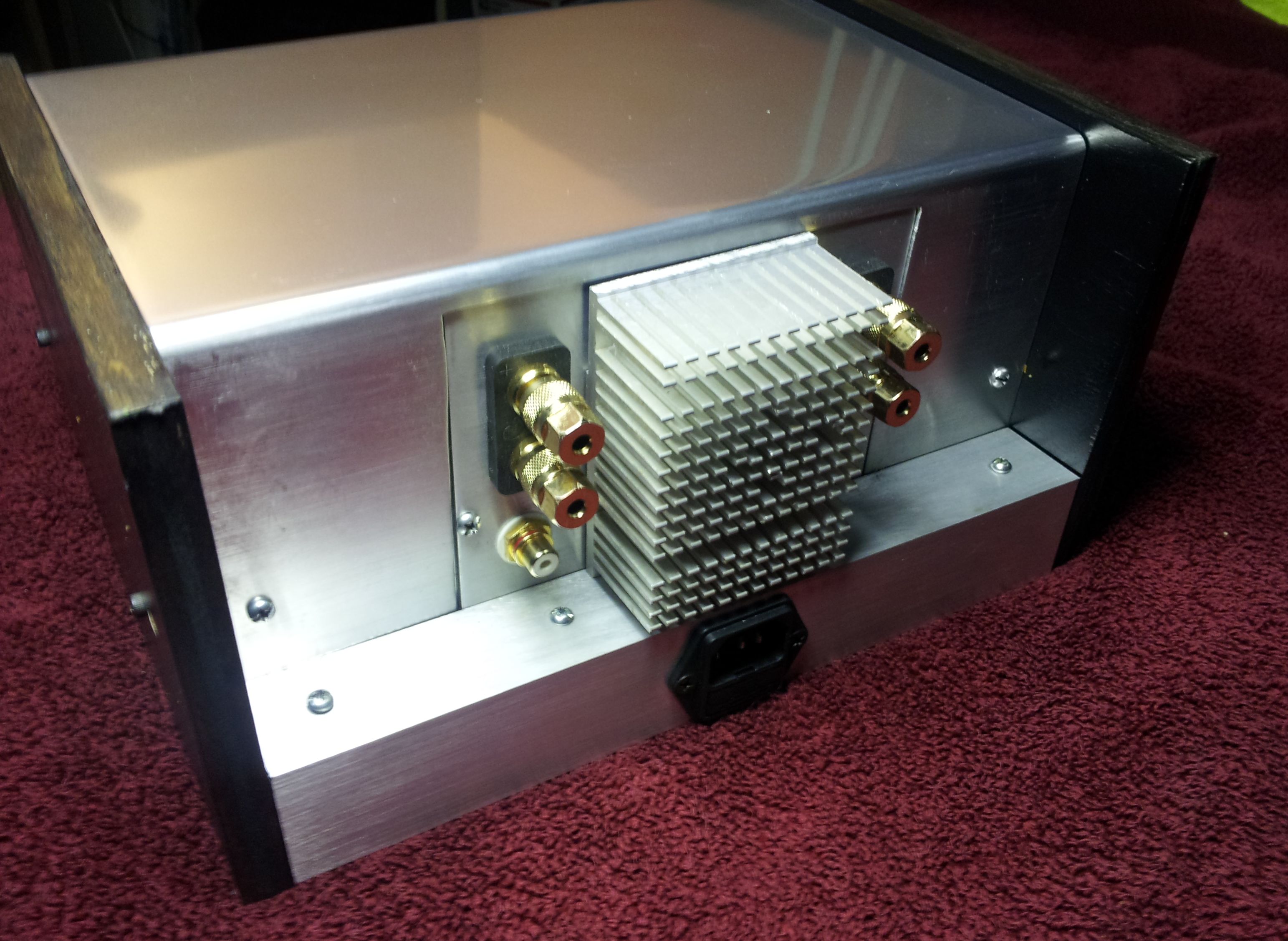

As I was trying to perfect my alumunum brushing skills it dawned on me I had the tools and compounds to do a smooth reflective surface. It was actually easier because impurities in the alumunim plate produced blotches at every grit size.
The sides are oak veneer on furnature grade plywood finished with rub-on stain and automotive wheel clear coat.
I couldn't stuff the 300 VA transformers in but the 200s will sound just fine. There are still some fit and finish adjustments (like bringing the back plates flush) but I think this one will make it to Denver and beyond.....😀
P.S. Might make aluminum sides at some later date.
Wow, its nice to see a finished product Bob! I really like the non traditional layout, it is quite efficient. What does the footprint of your amp measure configured like this?
Thanks, 10.5" W - 7.5 D - 5.5" H. Still fits in a USPS medium flat rate box.
Hahaha... I bet you're gonna get your monies worth out of that flat rate box!!!
But in all seriousness that looks great. I'd like to hear how it sounds..
