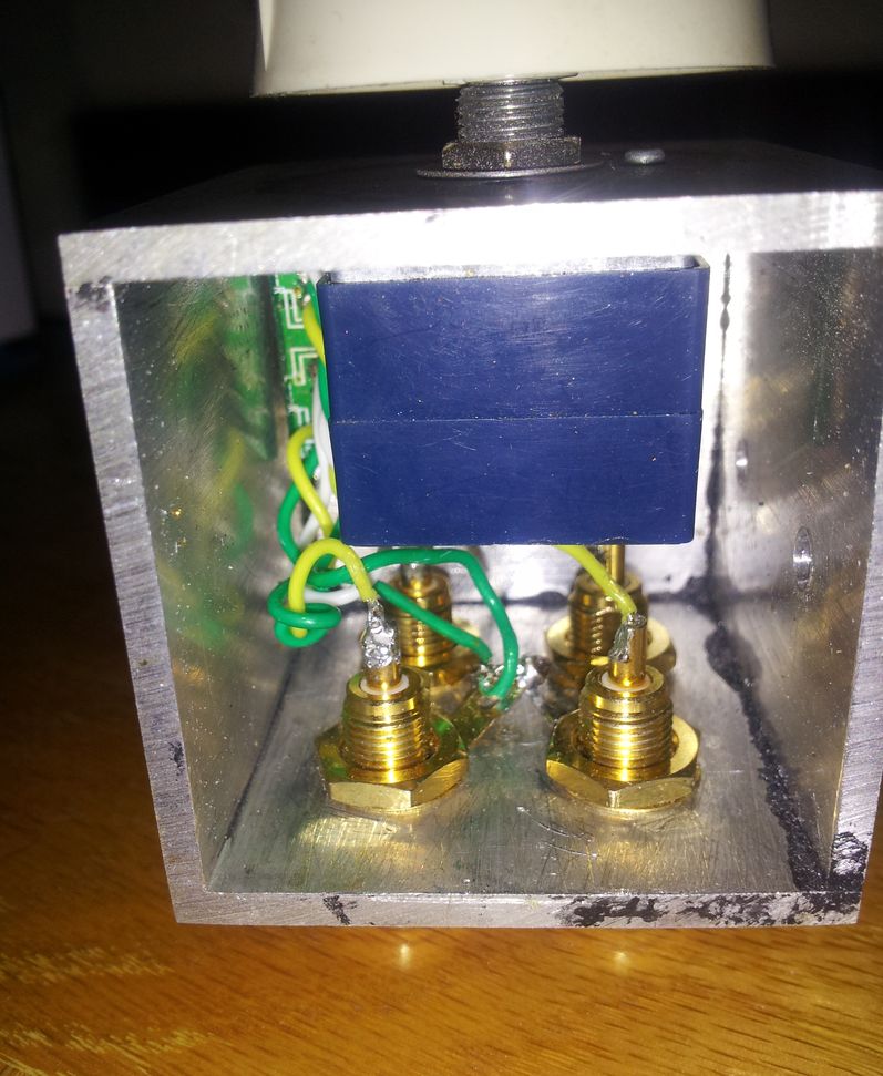

Funny you should mention the weather Bob, as we are about receive some freezing rain followed by several inches of snow this afternoon. So my plan is to do some more work on my amp while we are stuck inside. Over the last couple of days after confirming the hum in my amp is not in the amp but somewhere ahead in the chain I have been taking the amp apart to finalize construction. I pulled out my c 13 jumpers and soldered the jantzen caps directly to the boards, and did a few nonessential tweaks. Once back together I am going to nail down exactly what external component is causing hum. One thing I have been noticing about the simple pots people are using as a volume control is that the grounds for channels are connected whether it be by wire or ground plane on pot pcb. I have mine separated. I noticed on your volume control it looks like your simple pre has the pot mounted to a pcb. Does the pcb your using share a common ground? Does isolating them cause hum? Very curious.....
Not sure which you are talking about. I have both a JC-2 with a pot and a home-brew shielded Alps. JC-2 has a common ground plane. All the grounds (4) on the alps connect at a central star. At one time I was convinced the JC-2 common was the problem but that was not the case.

Yes the above right picture. It looks like the alps is attached to a pcb?
Yes it is, but in my case, functions more to facilitate connecting wires than any real circuit change. As I remember, having all socket grounds plus the case as a single element was essential to interference rejection. The PCB may yield different results in another application.

SoIL4x4 - You need to connect all signal returns together in your passive pre then connect them to chassis ground to avoid a pin 1 problem.
Also connect signal return to chassis ground in your My-Ref, same reason.

I have been trying different schemes for about three hours with no success...davy can you elaborate, what do you mean by pin 1 problem?
It's a term for an incorrectly connected signal return originally referring to a balanced connector (pin 1 is the signal ground in a balanced connector) but it's equally valid in a single ended connection (RCA). Have a read through the excellent article posted on here about system grounding, there's a lot of info but not all will be relevant to your setup.

No, while in other designs it's so, this is not the case... the MyRef signal return should not be connected to the chassis.
When PGND is connected to the chassis also signal return is, via the 1R resistor.

Will, as you built your amps was there a point the FEs were mounted on something non metalic - like the betas in post #1259. If so, was the hum present there also?

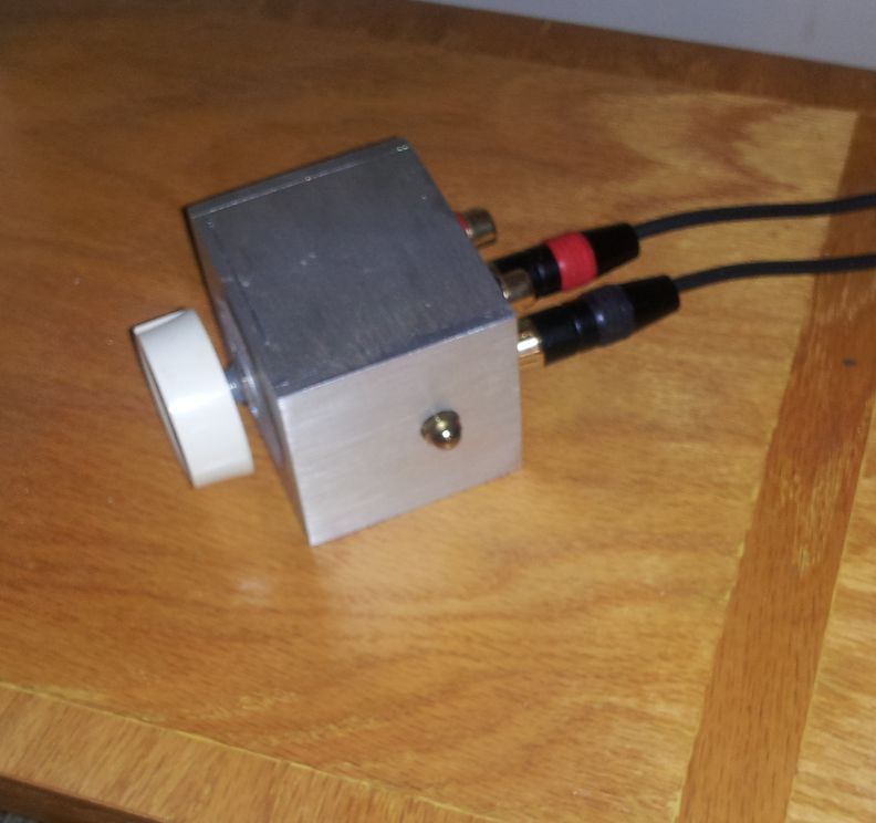

No, they have always been mounted to the metal enclosure. I am going to redo the passive with better isolated rcas tonight and some better wire. I think my grounding scheme is good at the passive. The hum is barely present, and that is with no pgnd connection in the amp. I think I am close. I have tried a different pot and cables...trying to rule out one element at a time. Looking at the cheap rcas I used in the passive I am a little suspicious. I have a few pairs of well insulated rcas to try. The good news is the amp is dead silent with my phone as the source, so I should be close.
