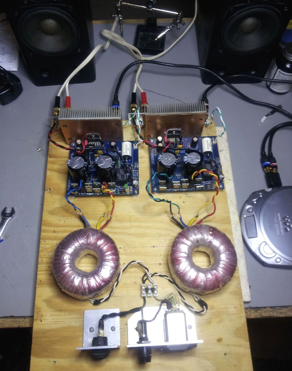

FWIW - Since I'm using the RC builds to size the new chassis, I did a temporary setup with the betas. Haven't been powered up for many many months but they still sound great. Had one loose input pin on one amp, but everything fell into place.
Trusty old Sonicaps at C13, Black Gate STD at C9 and two of the three year old original 125VA transformers from ApexJr. 😀
Another interesting (or not) hum story. With the setup in the photo I got horrible hum with no input. That was expected. For the first time I can remember, I got some hum from the Walkman and those interconnects/"Y" with nothing playing. Pushed the play button and the amps became silent - just music.
In the big system all that can be heard is the slight hiss that comes from the direct connected DAC when it isn't receiving digital data to lock to. No pot or pre this time - using PC for volume control.
Nothing really significant here except more confirmation of the influences of various connections/devices along the signal path.
