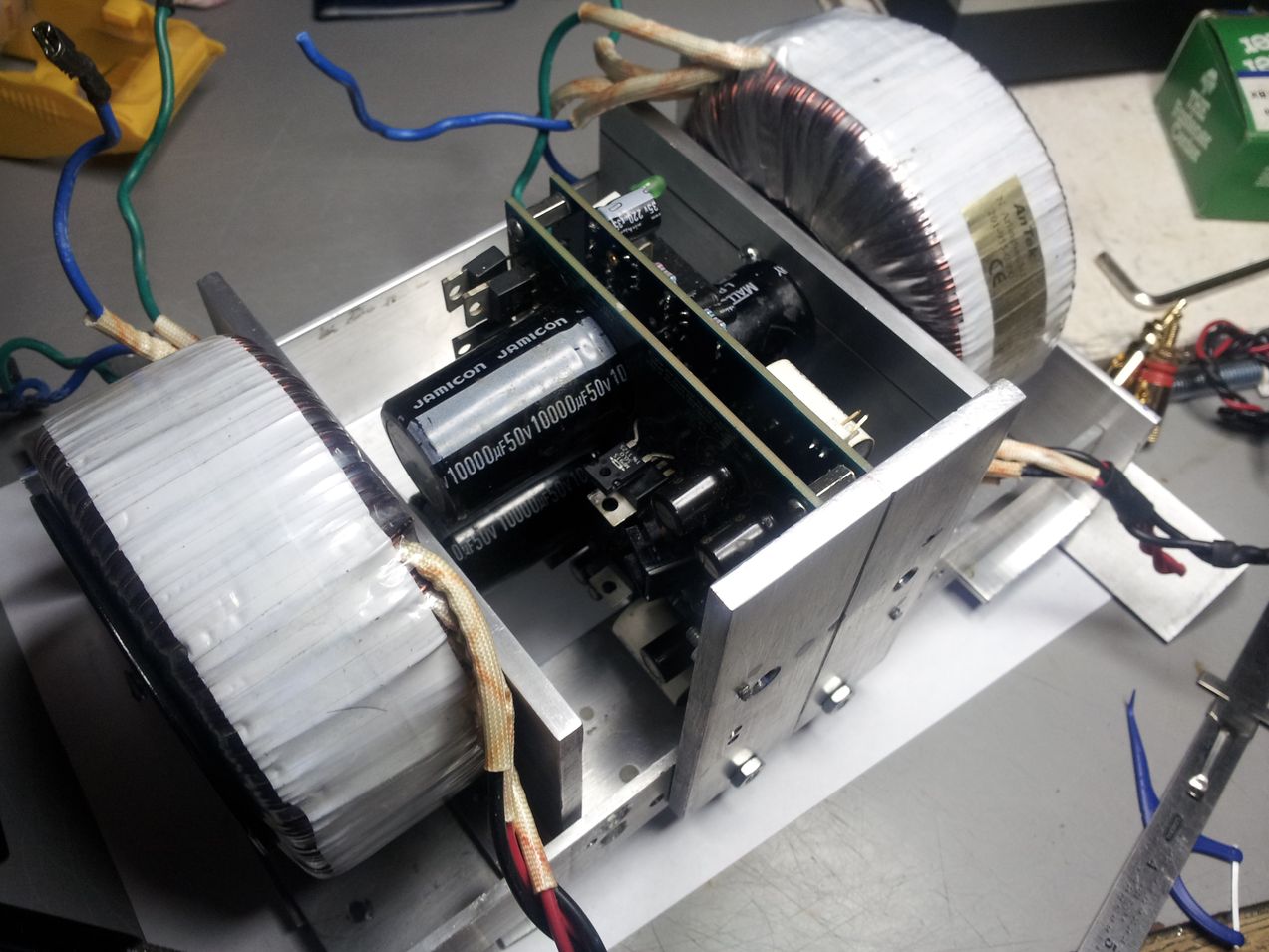

Input polarity's are ok.
I'm going to try making some short pseudo balanced inters to see if that helps.

Try unbolting your Transformers and moving it away from the chip, also twist the wires tighter. The switch power wire is also running very close to the chip.
Basically get all that AC as far away from the chip as you can.
The chip (LM3886) and the board are on the opposite side of the enclosure from the mains input and wiring, I moved the other wires so that the feed and return from the mains switch all run together across the front panel. I twisted the wires as much as they would reasonably allow but I might manage to force another couple of turns in them. I wonder if it's because of the close proximity of the transformer to the front panel. I even removed the feed from the board to the power switches inbuilt LED. None of this made any difference.

One thing I'm still unsure about is if I should connect the signal return to the chassis, or leave it insulated as it is now.

I tried some pseudo balanced interconnects, no change.
It looks like it's noise from the transformers getting into the circuit, not much else I can do with the enclosures I have but with the PGND connected it's very low so i'll just accept it and enjoy the music.

Did you try to simply rotate the transformers?
...... I wonder if it's because of the close proximity of the transformer to the front panel......
The "New & Improved" all metal mini chassis is almost done. There was no hum in the Old Wooden Bucket that failed, so we'll see if being super close is a problem.
Get some copper tape and wrap the outside of the transformer and take it to mains GND, and be careful to not contact the upper toroidal clamp.
That might actually be worth a try. Mind you the transformers have an inbuilt screen which appears to make no difference, however I think it's between the windings although I have been wrong in the past 😀
An external copper screen might work better.
Then again, I have not tried as Dario suggested, rotating the transformers. I thought since they are toroid's that sort of thing was not an issue. I might try lengthening the leads on them to allow me to rotate them

I tried moving the transformer but that made no difference.
When you rule out the complex, it must be something simple, and it was.
A dam noisy switch mode power supply for a modem on the same ring mains which feeds the HIFI, DOH!
Oh well, at least it wasn't my build at fault.
Bob your layout should be fine, the FE is not much bothered by having a transformer very close to the board.
Thanks everyone for helping me, I should have realised far sooner than this.
