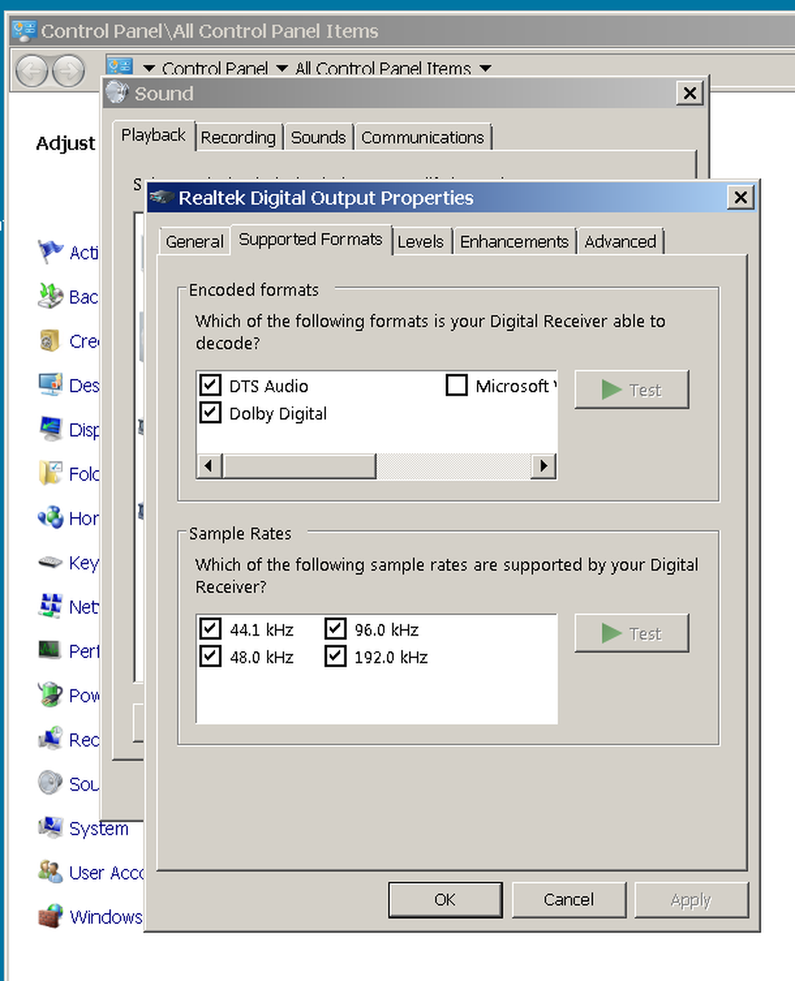

If you are going in that direction, let me suggest a setup.
1. If you are on a PC make sure all the formats are enabled in the sound section of the control panel.

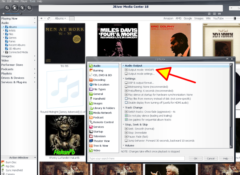

2. If you use JRiver you can select WASAPI to completely eliminate the Windows audio drivers. That cleans things up a bit and your JC-2 pot gets a full-strength straight-through feed.

Hi Bob, I tried WASAPI some time last year but I am using a PC/ Musical Fidelity V-Link/V-DAC set up for digital which does not work with WASAPI. It does give the best digital sound quality I've had to date though, it usually makes my turntable sound poor in comparison but I have to leave the PC volume at max for best results. I sold my Rega Apollo CDP after getting this set up working. I still have an old Philips CDR, somewhere in the house, probably the loft. Having boxes of CD's all over the place hacked me off and I had trouble finding CD's I wanted to hear.
