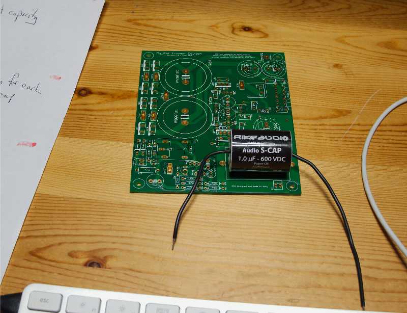

A little closer to home, at least to the world of FE's, I have some initial impressions of the Rike Audio S-Cap in C13. This is a German paper-in-oil aluminum cap that costs about the same as the Audyn True Copper and is rated in a similar range to the TC by Tony Gee at humblehomemadehifi. They are available at hificollective and I decided to try a pair while ordering some other things from hificollective.
When you first take the caps out of the box, they seem a little home made. The body looks like a small, plastic cup with a hole drilled in the bottom. The potting material is partially transparent and looks like 5 minute epoxy. The leads are not centered and the label looks like a stick-on mailing label that has been applied a little crooked by a real person. Of course, none of this should put you off because we really care about how they sound, not how they look.
The good news is that it appears to be a perfect fit for on board mounting on the FE board. Initial impressions of the sound quality are both unique in my experience and quite good. The first impression is that they sound very un-paper-in-oil like. You might even think they sound a touch bright on first hearing. I need to live with them for a longer time, but they seem very transparent and open with an excellent sound stage and good detail. The bass is clear and tight, but perhaps slightly less prominent than the TCs as I remember them. Overall, these seem to be worthy of your consideration. I will listen to them for a longer period and make a proper comparison with the K71-4 as a baseline and report back.

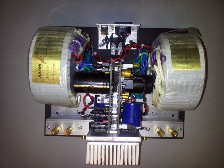

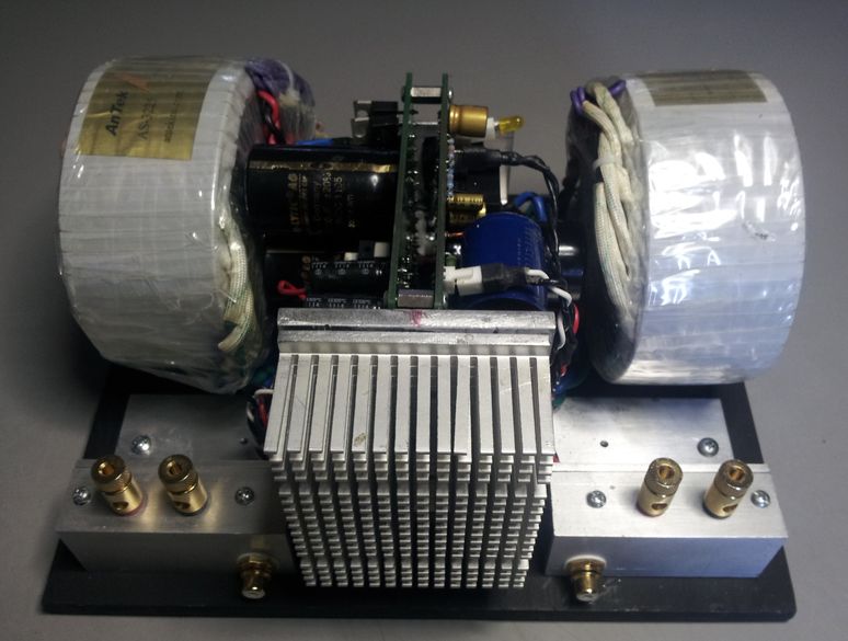

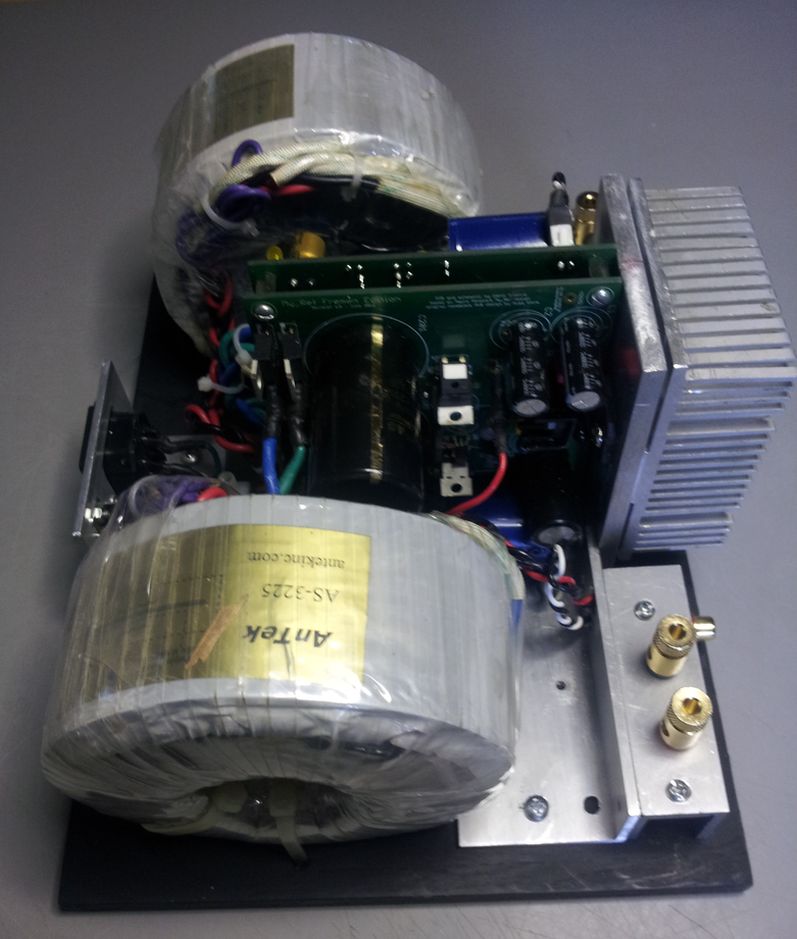

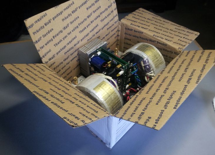

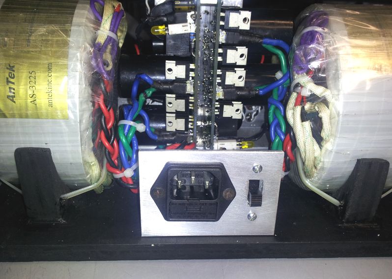

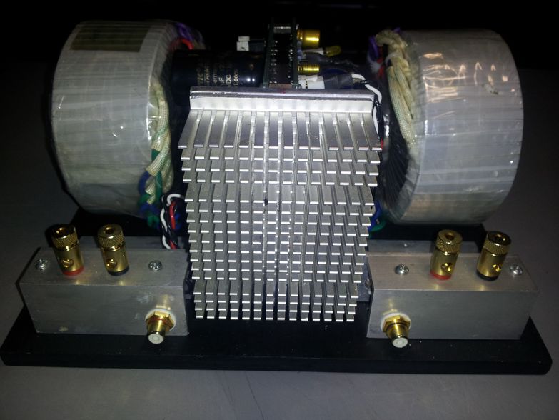

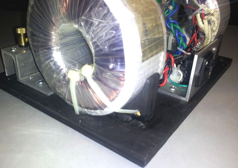

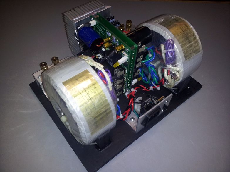

Hoping to ship out an FE build for a few people to audition this afternoon. The original plan was to send the amp minus the transformers. All the recipients didn't have optimum tranis so I decided to re-work the old liquid cooled chassis and create a "shipping container". The challenge was to fit everything into a standard USPS 11" x 8-1/2" x 5-1/2" - "flat Rate" box. It would have been relatively simple to mount the ApexJr 125 VA transformers, but though it's been months, I remember feeling the 300 VA units made a significant improvement in the body of the sound. Didn't want to take the time to do a comparison so just took on the 300 VA challenge. Just made it 🙂
The weight limit for flat rate is 70 pounds and this comes in at just over 17. The amp components are extremely secure. Three is a small bracket/hold down at the bottom front of the PCB modules. When I finish this post I'll build a removable plywood frame that spans from the amp base to the top of the box to eliminate any movement.

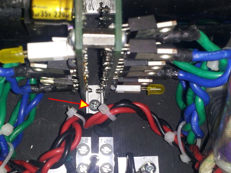

I was concerned about the field interference from the position/location of the transformers and had planed to weld up some shield boxes. Decided to test it as is and discovered dead silence. I still don't understand the "extra shield" on the Antek units. When they are connected to earth ground a horrible hum is created. I just left that connection open.
Don't know if it's self delusion, but I do perceive a slight advantage to the monoblock configuration this set came from. Now that I see how small the required space is - I'll translate this design to metal when the auditions are finished.
EDIT: A note of caution - The first test of this build produced the infamous temperature protection dropout. The cause was stripped threads on a LM3886 mounting bolt resulting in only the the top of the chip being against the HS. There is enough overhang from the PCB edege, but the assembly process still allowed a loose fit to develop. New screw, full chip to HS surface match - no trigger. So pay special attention as new builders put their amps together 😉
