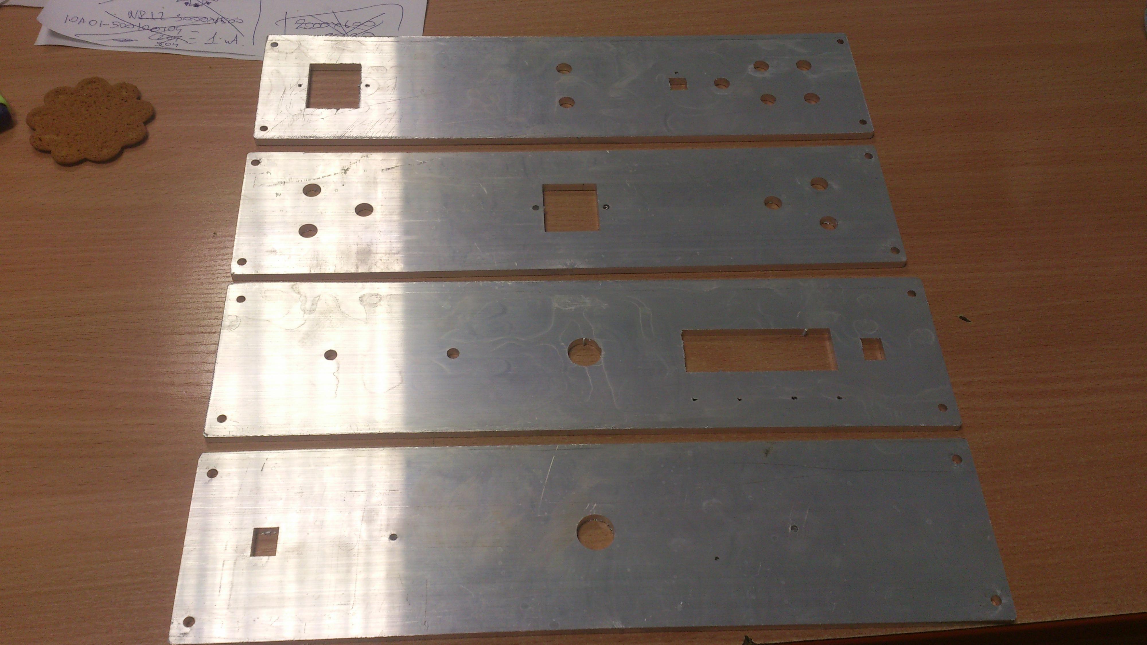

My equipment currently disassembled.
Did new front back panels weith laser cut and cnc.
Only problem- aluminiuum needs to be brushed for a better finish.
I have some links with suggestions how to do this but is any of you attempted anything similar ?

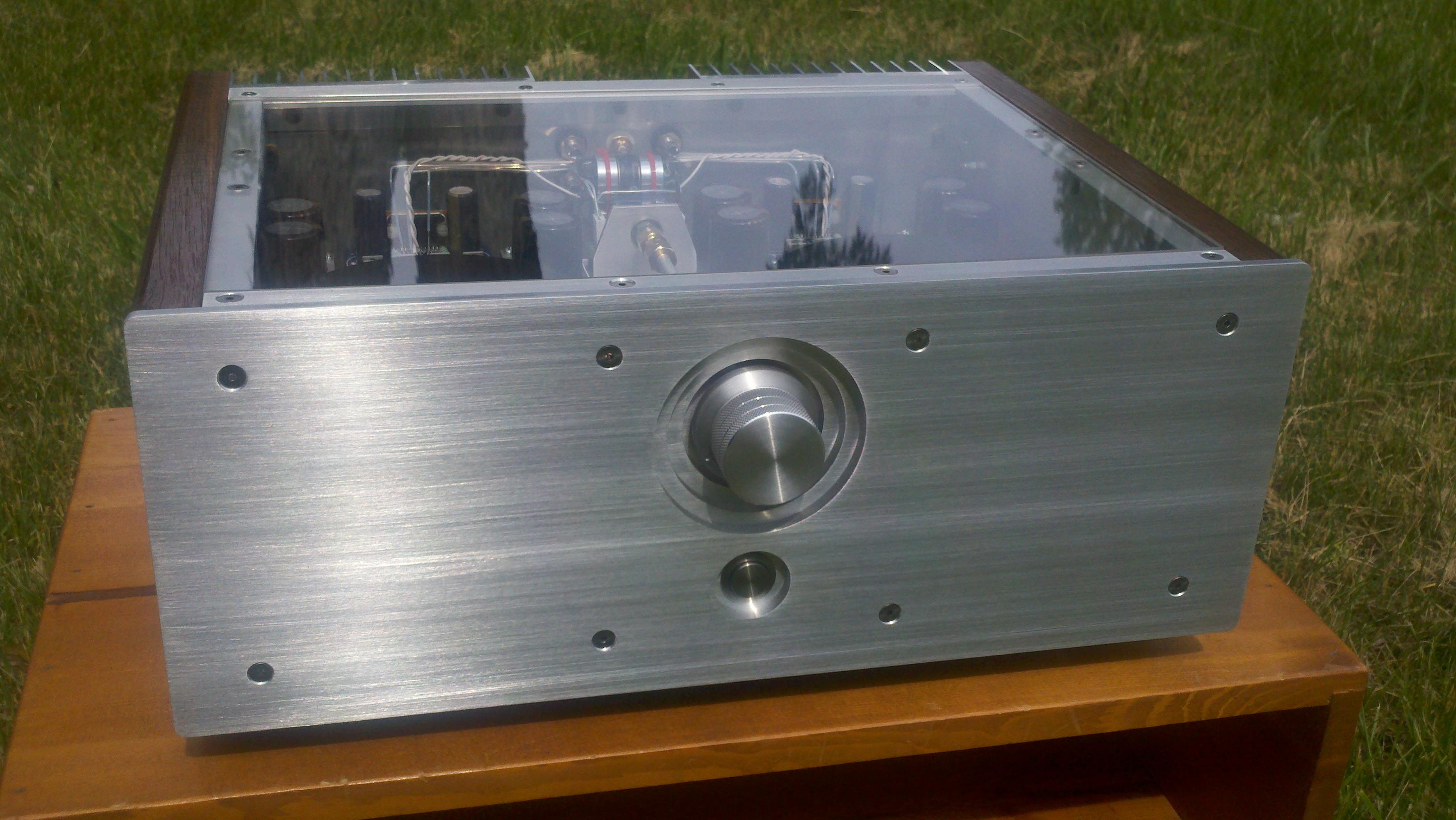

Voxx, your panels look great. Brushing them will take some time, but it will be worth it. I always use reclaimed drops for my builds so they usually have some deep scratches at the surface. To smooth these out I use a palm sander and some medium grit paper (250-320). I have used water with the sander, but I will leave that up to you. (your panels looks pretty clear so you may be able to skip the sander step) Then I attach the panels to a fixed surface leaving the finished side up to be sanded. I usually wrap a large piece of coarse grit sandpaper over a block of wood or somthing similar that is fairly hard. This worked better than a padded sanding block for me. You will also want a spray bottle full of water. Now spray the surface down with water and begin sanding. Sanding longways (horizontaly) looks better in my opinion. Keep sanding and sanding and sanding, then spray and sand some more. Be sure to start your stroke across the panels straight. There are a few tricks I used to ensure the strokes were straight on my first build. First I used a sheet of paper that was as wide as the panel so every inch of the panel was touched on every pass. Second was I put a section of 2x4 next to the long side of the paneland used it as a guide. Any movement that is not square will show up on the panel, but the good news is you can sand it out. Keep sanding and spraying until you are happy with the finish. Then wash off the surface with water, let it dry and use rubbing alcohol to clean any oils left behind. let this dry and wax with automobile wax. I use the micro type that comes in a spray bottle. I spray it on heavy wipe it around so it covers the whole surface and let it dry for awhile. Then I use a microfiber to polish the surface. I repeat this 5 or 6 times before I let the surface dry for a day or so. I have had great luck with the wax, so I have not expiremented with clear coat or anodizing. The wax method has held up to little kids handprints etc. it is easy to clean too.
hope this helps😀
hope this helps😀
