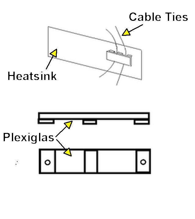

Only one thing worries me - caps still hung on the double sided tape...
I ll see my local hi fi shop if they want to compare it with their gear 🙂
Did you post a picture? If so, what was the post number?
Honestly I am on a smartphone so bit difficult to look up.
I use double tape and literally attach cqp to the heatsink.
I had idea to use clamp attached to heat sink. Or use two plastic rods fit into c13 holes and clamp at the top.

I was thinking that a couple of ’’ plastic ‘’ Cap clamp would do a nice job of holding those C13 in place.
Or
Some metal ones but insulate the cap body with some PTFE Mummy wrap or something similar. Drill and tap holes straight into the heat sink to make a secure fixing and jobs good.

Been doodling for a cap mount. If you get a small piece of Plexislas or Lexan it can be cut with a coping/hobby saw, or scored and split by bending over a sharp table edge. Drill a couple holes and as mentioned earlier, mount to heatsink with screws or glue. My favorite is GOOP. It's not very heat sensitive, has great grip and can be removed if needed. You can make the mounting bracket any size or shape you need.

Thank you Bob 🙂
It is a great idea to use plastics.
I ll think about it. I might thermoform some plexiglass or use simple pvc tube and put cap inside or do the way you showed me.
