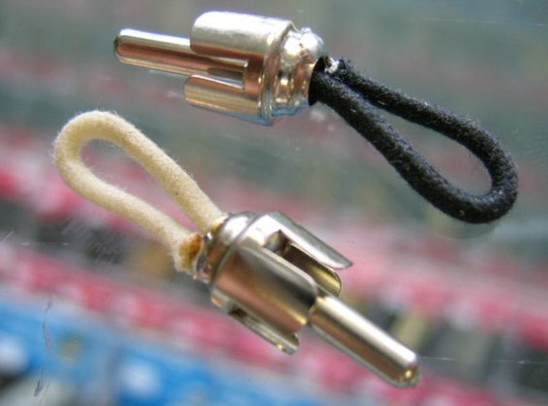

Welcome to the problem of electronic interference. Thats why we shield most of our cables. If you don't have any source of ground the circuit becomes an antenna. If you pull the ground off of your input when playing a signal it will put the amp into oscillation. Not pleasant.
Here is the basic idea. Just some sort of loop/connection between signal/hot post and ground/shell. Can be a wire or just a big blob of solder. Some use a resistor for special applications, but I don't think it is necessary for what you are trying to do.
