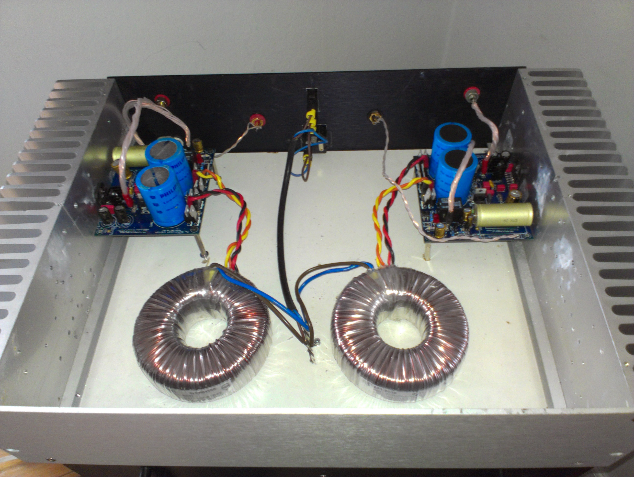

Hi all
I have just finished my my_ref , and it is sounding amazingly good. Too early to say anything definitive.
The reason for this post is that I am a little puzzeled over the big fuzz about C13.
Why not use the best capacitor ever made??
A short piece of wire!

The reason I build this amp was a freindly challenge by fellow member bcmbob as a response to my ravings about a Golmund Telos 250 clone in another thread:

Well I did excatly that, and I am glad I did.
My first impression is that this is the only other amp that can challenge the GM.
Not that it sounds like it, but it has some very nice features.
Actually to my ears and on my speakers it sounds more like a very good traditional tube amp. Very sweet and with a very big soundstage especially depth.
It cannot match the GM in shear power of course given its >250 Watt rating.
The My_Ref clips here on very demanding material.
It cannot match the exquisite highs of the GM and is a not as focused as the GM.
On the other hand it is so sweet and warm and has better depth and the room is easier to hear.
If you listen to a violin group in a symphony orchestra the GM separates the violins better than the My_Ref and the air is more prominent.
But the My_Ref gets the romantic character of wood and string even though it paints with a broader pensel.
Because of the good summerweather here, I am not using much time on listening inside, but I am very much looking foreward to hear a lot more music on these amazing amps. Looking at the schematic, I wouln´t have thought it could be this good.
I would call it a draw between the to champs at this point!

Wow! Incredible review
Which BOM did you use?
Can you post some pics?

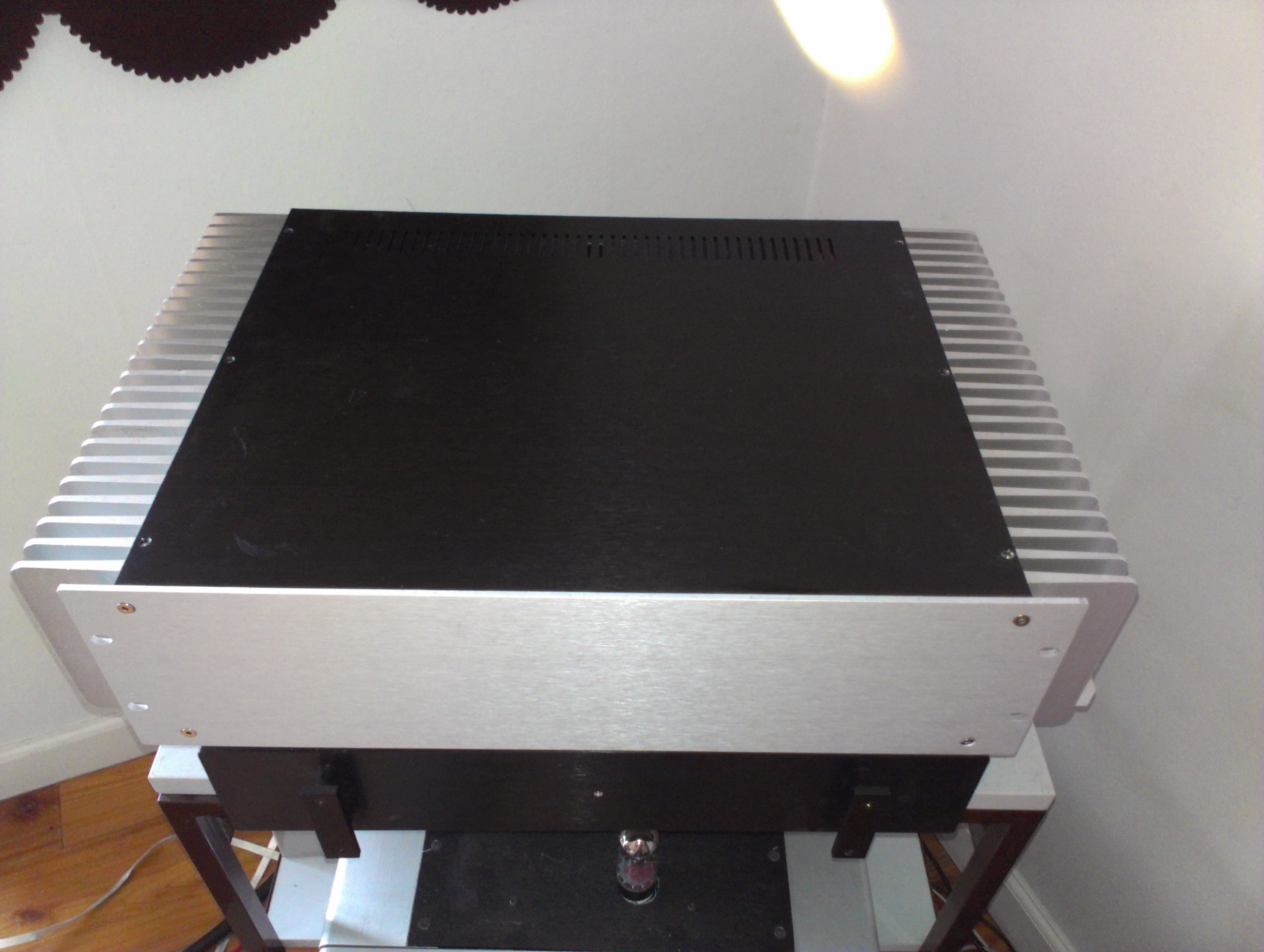

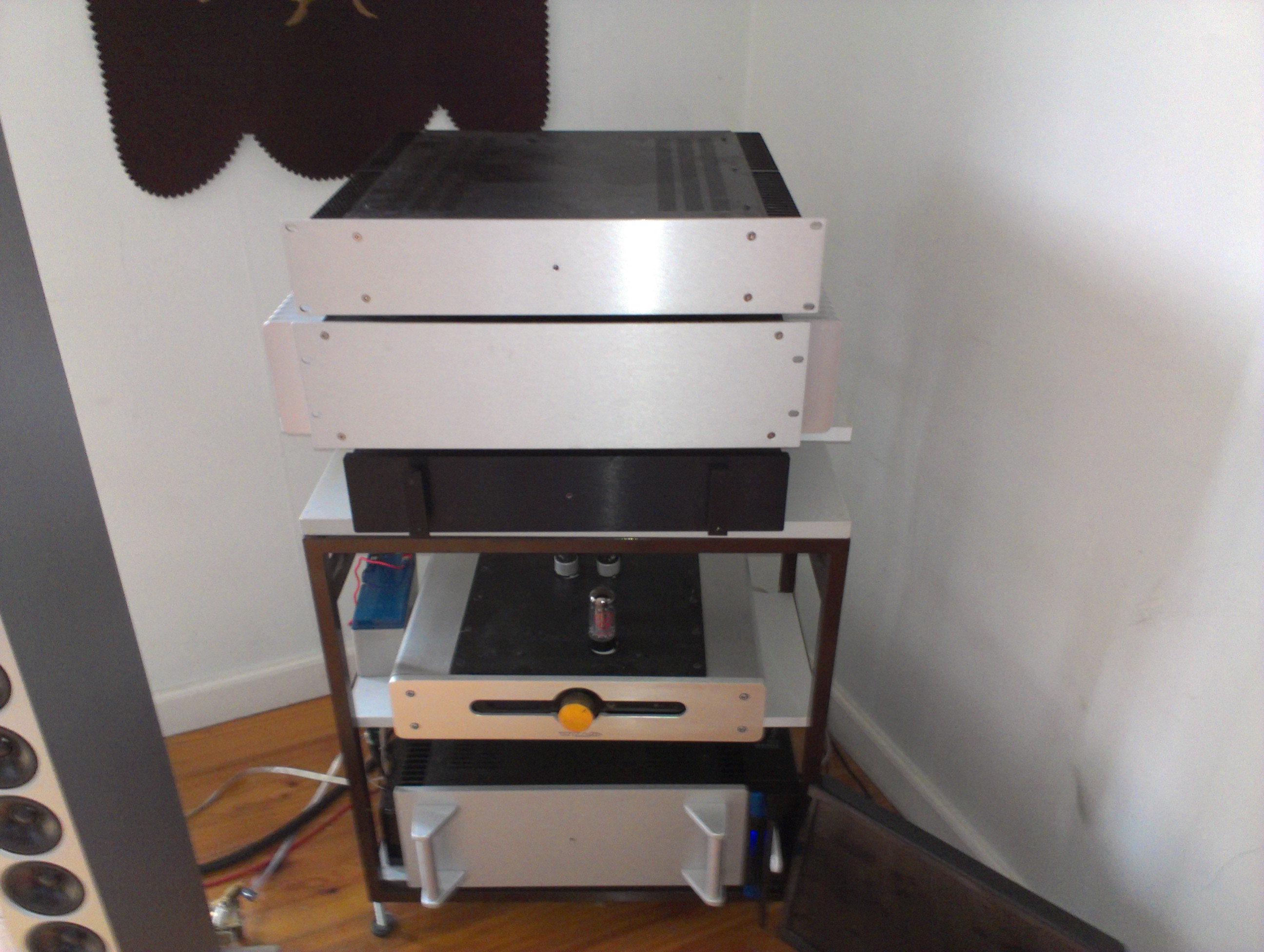

Well I have just reused a chassis that formerly housed the Pass F-5 so it is not its final home.
In the rack you see from below:
GM Telos 250
Aikido preamp with Marconi B65 metalbase tubes.
TDA1541a NOS DAC with audio widget USB to I2S converter.
My_ref_Fremen
Improved Bow Technolgies ZZ-1
I used mostly the Mouser bom and I will be looking for parts to upgrade.
What about K71-4 as C7? Or NOS phillips KP types?
Have you tried Silver Mica as C32 and C30?
GM Telos 250
My_ref_Fremen

Problem, guys
Been away for some time.
Last week I slammed the door on the tv stand and suddenly heard weird high pitching noise.
Switched off unit (I am using b1 for now, till ldr based pre is ready). Disconnected everything.
Few days ago I got back and just turned on amp with small test speaker - hum on both channels.
Today I rewired signal with teflon isolated wire, but hum is still on.
I have checked dc with cheap mm (tomorrow will bring fluke and test it with another). Put mm on 200m, showed right channel 0.4 and fluctuating, goes down to 0 and up to 0.4. Switched off, mm peaked at 13 .
Left channel is on and goes about 0.5 and 0.4 ( 4 or 5 mv ? ) and on turn off peak at 30...
did not expect anything like that, wanted to finish up with on off switch and grounding and close box and forget... but it seems it is not the end...
