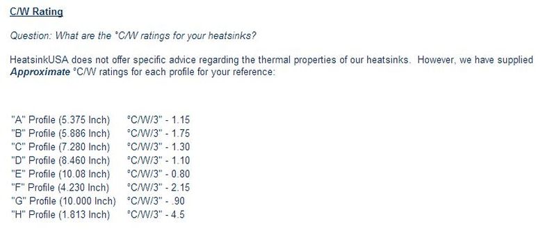

Twist secondaries
National show in detail how to calculate the heatsink size.
But they assume that the device is @ the maximum allowable junction temperature.
This high a junction temperature will trigger the temp compensated protections built into the chipamp.
I always recommend that you double the size as given by the National datasheet.
If they tell you that at 25degrees C for one chip operating from +-38Vdc into a 8r0 resistor should be 3.6C/W, then use a 1.8C/W for each chipamp.
If you put two chips on a common sink then that becomes 0.9C/W sink.
Look up the heatsink section and use the charts to determine your sink requirement for your operational conditions.
If the sink is internal to the chassis, it will run in air that is hotter than the room's ambient air temperature. Sometimes very considerably hotter.
James,
Without knowing the details, those heatsinks sound like they would work.
As Andrew says, there is a lot of info on the National website. In addition to the charts he is recommending, I remember that they have a spreadsheet for the 3886. You put in your power supply and load and it calculates the power out and required heatsink transfer rate, deg C/W. In general, that is a good guideline for a MyRef.
That said, MyRef works a little differently than the standard chipamp with the voltage gain in the 318. I think it is fair to say that the MyRef is a little lower heatsink requirement and that a heatsink designed to work on the chipamp will be fine on the MyRef.
