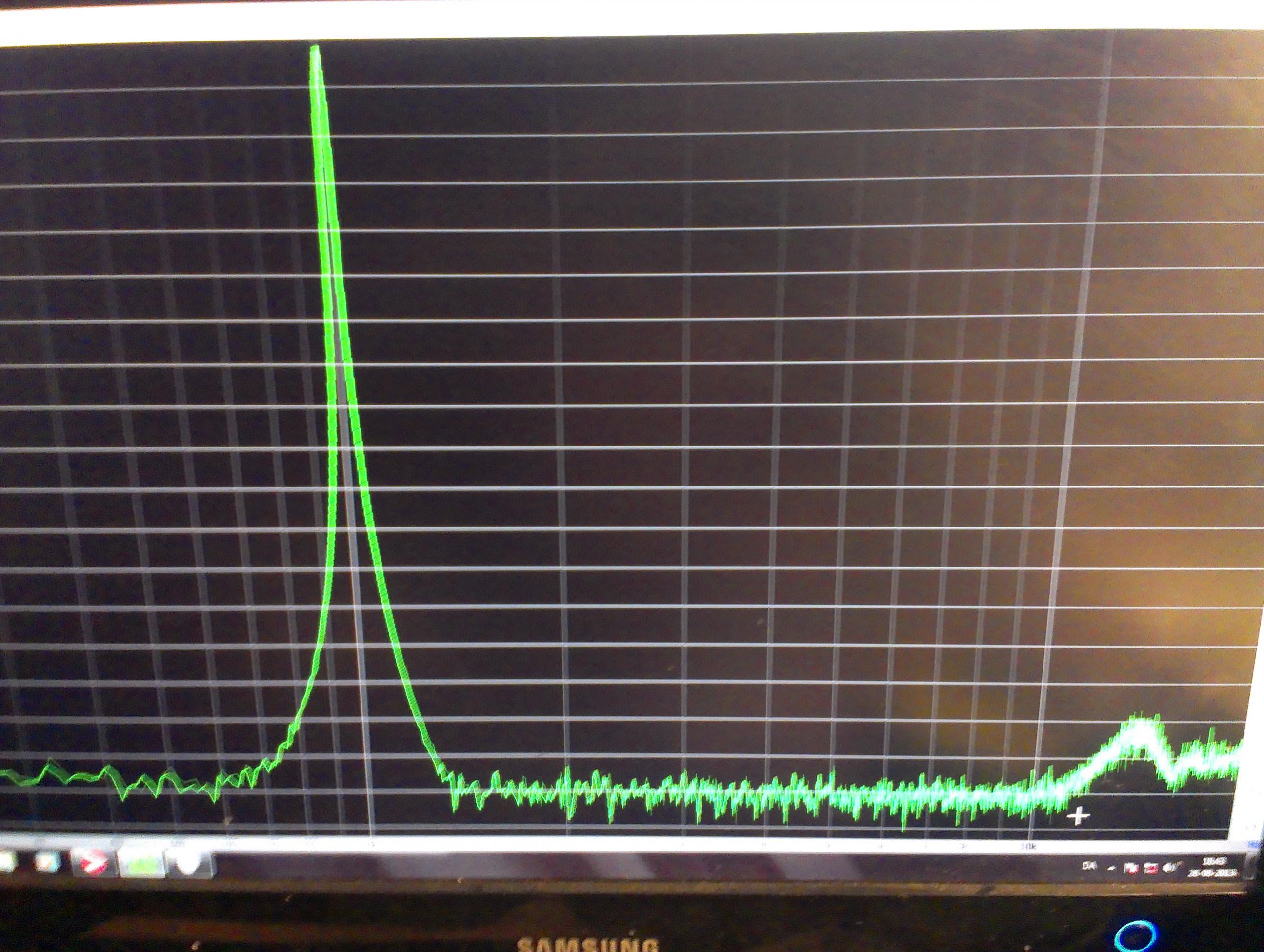

Measurements
Just a short notice from me.
I just had My-Ref on the measuring table.
Also here incredible results.
There are 6 dB pr. division.
Output from My-Ref JUST under clipping.
The noisefloor is around -108dB.
Actually no trace of harmonic distortion products😀😱
