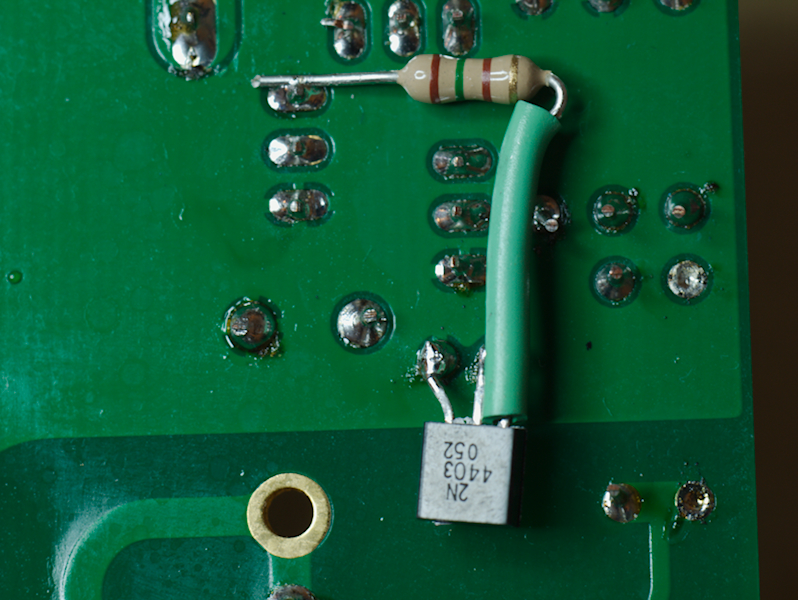

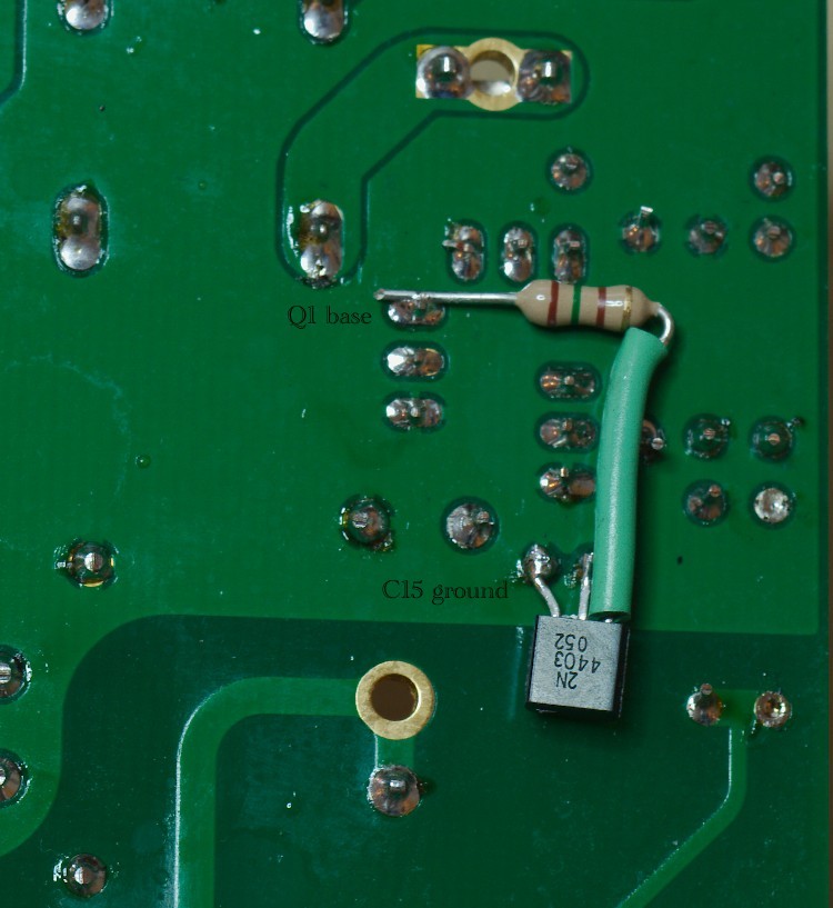

Speaker Protection Modification
Since we didn't get any comments from experienced circuit designers on the speaker DC protection circuit modification that I proposed, I'm hoping that a few of you will try building the modification. This also works, with a different physical layout on other My_Ref boards. Hopefully, some of you guys that have built more than one FE pair will give it a try to give people confidence.
Here are the details.
The current speaker protection kicks open the relay at about +5.5 V DC. The negative voltage side kicks out at a higher voltage that seems to depend on the transformer, the better the transformer, the higher DC allowed or the worse the protection.
The modified circuit causes the relay to open at approximately 1.7 V DC, positive or negative. It does this by specifically adding a transistor circuit to handle the negative voltage side and by adjusting a voltage divider.
If you build this modification, you don't change anything in the signal path, but improve your speaker protection by making it more sensitive.
Just in case your are curious, the original circuit and the modified circuit has been calculated, simulated, and tested in hardware. The voltage numbers above are from building that part of the circuit on a board and testing it by itself. I don't recommend back feeding DC into a working amplifier.
BOM
1 each per board
PNP transistor - I used a 2n4403 because it is easily available (In stock at Mouser)(US builders can buy a 15 pack of PNP transistors for about $3 at Radio Shack. It includes 5 of the 2N4403).
150 Ohm resistor - 1/4 watt - axial lead - any type or tolerance (180R would also be OK)
47k Ohm resistor - 1/4 watt - axial lead - any type or tolerance (Note: a 39k or even 33k would work OK. They would slightly increase the relay opening voltage. For example, 33k would open at 2.2 V DC)
DIRECTIONS
Find and remove R16 (75k). It is no longer needed.
Find and remove R19 (10k). Replace it with the 47k resistor.
Locate C15 (22 uF electrolytic) on the bottom of the board. Bend the lead of the 150 Ohm resistor about 90 degrees and test fit the 2N4403 and the 150R resistor so that the leads can reach the terminals shown in the photo.
After trimming the leads on the 150R, solder it to the emitter of the 2N4403. Insulate the emitter/resistor lead so that it doesn't short other pads on the board. I used shink tube, but tape will work as well.
Solder the collector of the 2N4403 to the ground connection of C15.
Solder the base of the 2N4403 to the plus terminal of C15.
Solder the free end of the 150R resistor to either the base of Q1 or the emitter of Q2.
Trim leads and you are done. I would be happy to answer any questions.

Jac,
A fascinating and valuable modification for those who have amps directly coupled to drivers. I have turned these amps off and on more than a thousand times over the years and never heard anything from the speakers, so I guess xover caps are protecting them. With active xovers before the amp, your mod would be essential.

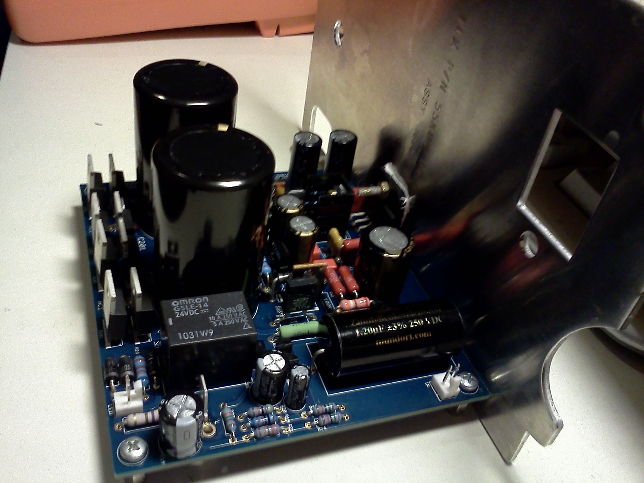

I am in contact with Parts Connexion about availability of Mundorf MLGO caps for C9, with a group buy in mind if others are interested.
The other candidate I am considering is a Jensen Axial electrolytic. It could be fit onto the FE board with a little care and an "outboard" connection to R10.

Tom E,
Here is a thought that is probably outside of your zone of interest, certainly one that leaves the traditional My_Ref path, but one that I have thought about from time to time.
Let's say that the goal is to get a better cap in C9 position, hopefully one that is naturally non-polar like a film cap.
The way this works is that R7 and R10 provide the gain setting for the FE. C9 and R10 form a high pass filter that increases in impedance at low frequencies and reduces the gain of the LM318 op amp for better stability at low frequency. As long as R x C of that filter remain constant, the filter's corner frequency remains the same. In the case of C9 and R10, that corner frequency is 1.86 Hz.
If I want to keep the gain the same, R7/R10 needs to stay about 30:1. That means I can theoretically increase R7 and R10 and decrease C9 without changing the base circuit. For example, if I change R10 from 390 to 3.9k, then R7 becomes 120k, and C9 becomes 22 uF. That is at least possible for a film cap.
Let's say that I don't need 1.8 Hz, but could live with 5 Hz for the filter. Using R10 of 3.9k, C9 becomes 8 uF. That looks better still. I can imagine taking this further, maybe a 10 Hz filter and 4 uF for C9. This is also possible, but may introduce some phase shift in the bass area.
Maybe I don't need the full gain of 30:1 or 29.7 dB. Let's say I have an active pre-amp or really efficient speakers and can afford to give up 3 dB of gain. If I leave R7 at 120k and make R10 at 5.6k, I have a gain of 26.6 dB. If I use 10 Hz corner frequency, my C9 only needs to be 2.7 uF. At 2.7 uF there are lots of choices from small bi-polar lytics to lots of film caps.
Of course, this is oversimplified. I'm sure that you would want to tweak C10 and C32. I can't predict what other affects on sound would be. At the very least, we are risking more noise from R7 at 120k. But in the end, the advantages offered by replacing an electrolytic with a film cap might be worth any tradeoffs.
Just a thought.
Jac

Jac,
Your understanding of this circuit and your ability to describe it in terms that we can understand are exemplary. Thank you for that last post, and all the others you've contributed here.
I doubt that I'll start tweaking values of components that seem to work so well now, but you raise very interesting points of real value.
My skill level is low enough that I can only handle plugging in different parts until I find one that sounds best. That might be crude and sometimes expensive, but I'm satisfied with where it's gotten us so far.
You and Dario are far more adventurous than I am. I enjoy tinkering with flavorings for your recipes.
