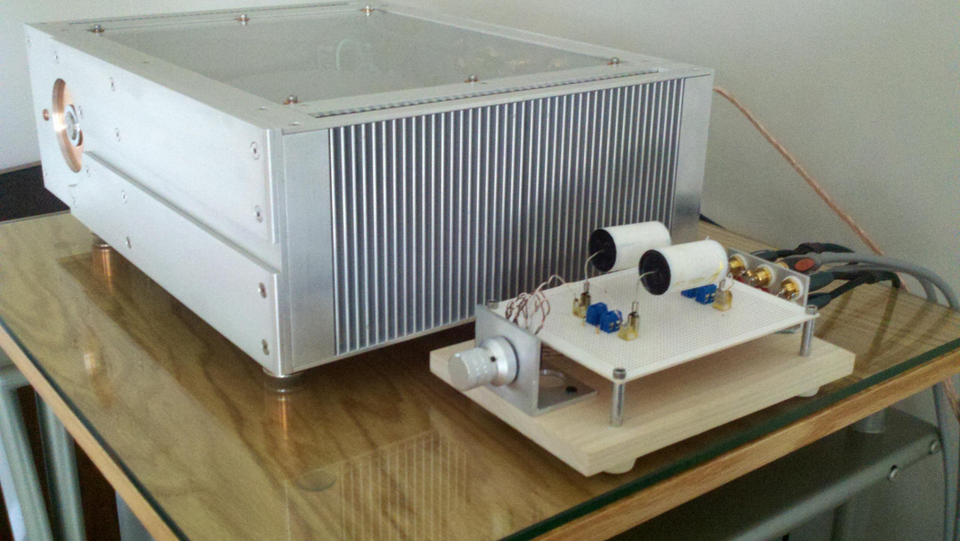

As promised some pages back I have rewired the inside of my FE to be A/C coupled and completed a C13/volume control test rig. Right now I am using the audyn plus caps that Bob has so generously lent me. I am going to compaire these head to head with the K71-4 and see which ones "let more sound through". This setup should allow me to swap the caps faster which will hopefully reduce ear fatigue.
So far I have noticed that the shorter the interconnect between the coupling caps and the amplifier the better the sound, especially for vocals. I also used the blue pc screw terminals at first but the fastons are more convenient and sound much better. I dont think the sound will be as good as having the C13 caps inside the amp enclosure or even in position on the board, but my hope is to test a few different caps and see which ones allow the most natural sound to come into, and out of, the amp:D

So far I have noticed that the shorter the interconnect between the coupling caps and the amplifier the better the sound, especially for vocals.(...) I also used the blue pc screw terminals at first but the fastons are more convenient and sound much better.
Really interesting...and nice confirmation on insisting on using an onboard cap and fastons. ;)
I'll read your findings with interest.
Will,
First of all and once again, you did a beautiful job with the enclosure. Nice!
I look forward to your comments as you experiment. Observations like screw terminals compared to fastons are very interesting. I would have guessed the other way round. Keep up the good work.

first of all, thank you Jac. I really enjoy the construction process and the challenges it presents. This amp was a departure from my other components in a design sense. I wanted the enclosure to be servicable and to seperate as many of the A/C components from the amp as possible. I will post more detailed photos as I take them;)
Now for some initial thoughts on C13. I will say that my impressions of the differences between the audyn plus caps and the K71-4 are preliminary, but I do have some thoughts.
First, my setup is as follows. Sony DVP NC85H DVD player as a source not high end, but it does the job. I have thought about a DAC, but I have not done enough research to decide if it would make a difference. A quick search told me it has a 24bit DAC built in, maybe a 32bit would be audible, others with experience let me know. TKD pot based volume control with C13 caps. FE with standard build. audioquest evergreen inter connects. Basic speaker cables connected to ESS AMT monitors circa early 70s (Mint, seriously). 35 year old holes in my head:D
My first plunge into the subjective yet revealing test was with a modern recording. Minnesota, wi by bon iver which for those who dont know is full of detail throughout, high mid and low. the K71-4 reveal quite a bit of the mechanics of the music. string noise, etc make you feel like your in the studio. the vocals are "in the room" and the highs are sharp but not piercing. the mids and bass are accurate and detailed. Overall the sound seems warm and enjoyable.
The same tune with the audyn plus instantly has different characteristics. Most notable is the bass. The bass is full deep and tight. It really brings the AMTs to life on the low end (an aspect that has always been just ok).
There is a warmer tone to the sound, but it does lose a bit of the high frequency detail and much of the background detail. However I am reluctant to say that even though I really like to hear the "mechanical" sounds of the music, the warmth and musicallity of these caps is really pleasing.
Next up was Miles Davis, Kind of blue (remastered edition). Many of the same observations of the previous recording rang true. The K71s had a sense of being "in the club" but there is an amount of hiss from the recording that reminds you of your location. the Audyns mask much of that hiss, but again sound warm and pleasing.
Both of these caps have their benefits and drawbacks, but tonight my preference is with the audyns. (tonight....preliminary:D)
One observation that remains is that with both of these caps this amp is so detailed and enjoyable it makes great recordings sound amazing and bad ones, well....revealed.
P.S. swapping the caps and listening to the same song four or five times is a bit tedious, but quite interesting.
