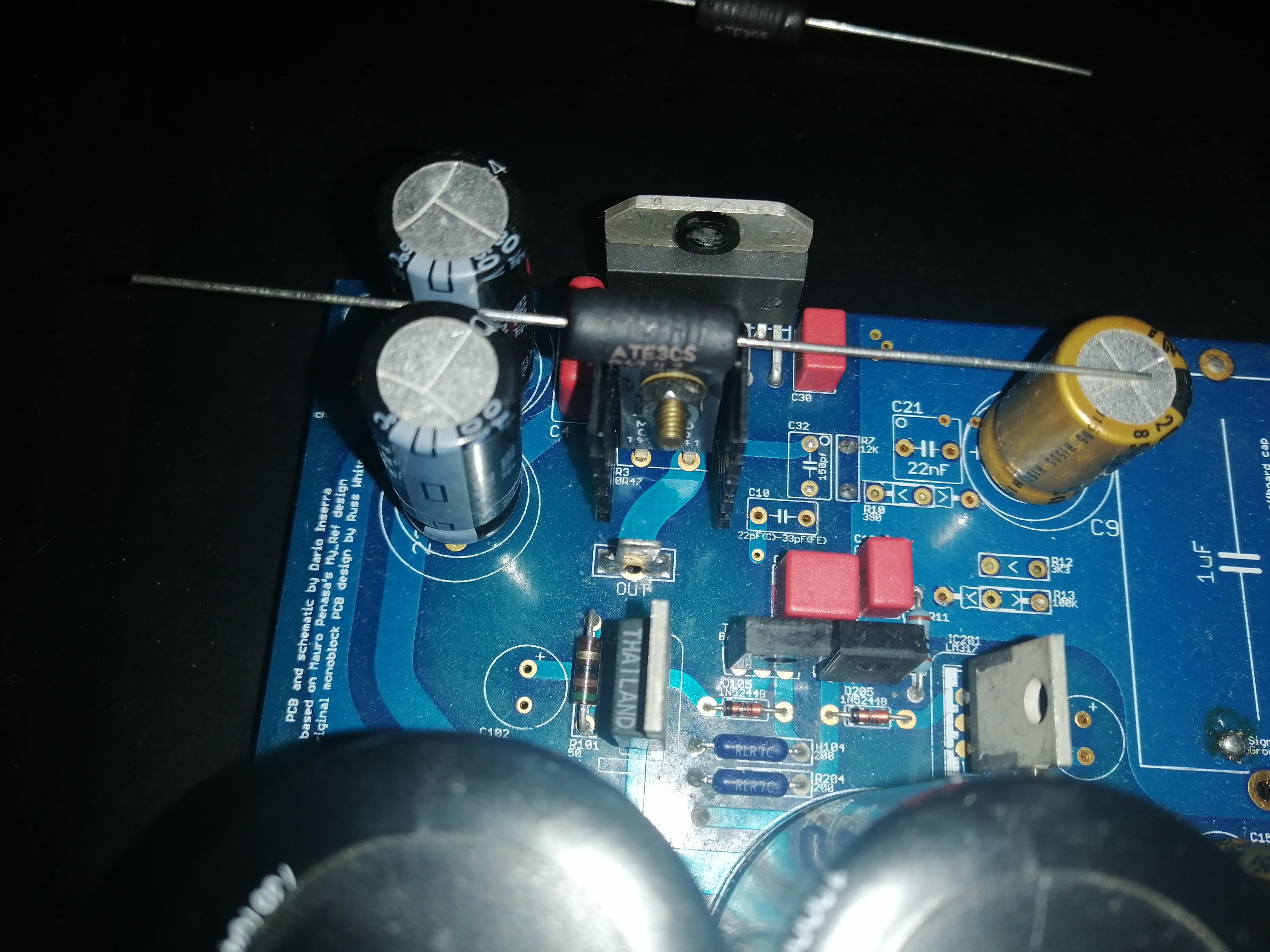

Just a thought. These are ATE 3CS in the photo.
Two times 0.68 in parallel would get us the right value.
Less problematic to fit in the available space. Two on top of each other. Two because of the power handling.

Manganins are running in while I'm working from home.
It seem they're improving but orientation probably has to be reversed, they seems much more balanced this way.
This evening I will repeat again tests and critical listening.
Regarding axial resistors possibly no modification is necessary since they can be mounted vertically and use 5W ones without problems.

At the end, we had decided to put these, in place of the ATE 5CS, which are very much like those RS-5. Like exactly the same structure (and very good sound).
George had reassumed nicely, should be re-run the integration procedure..

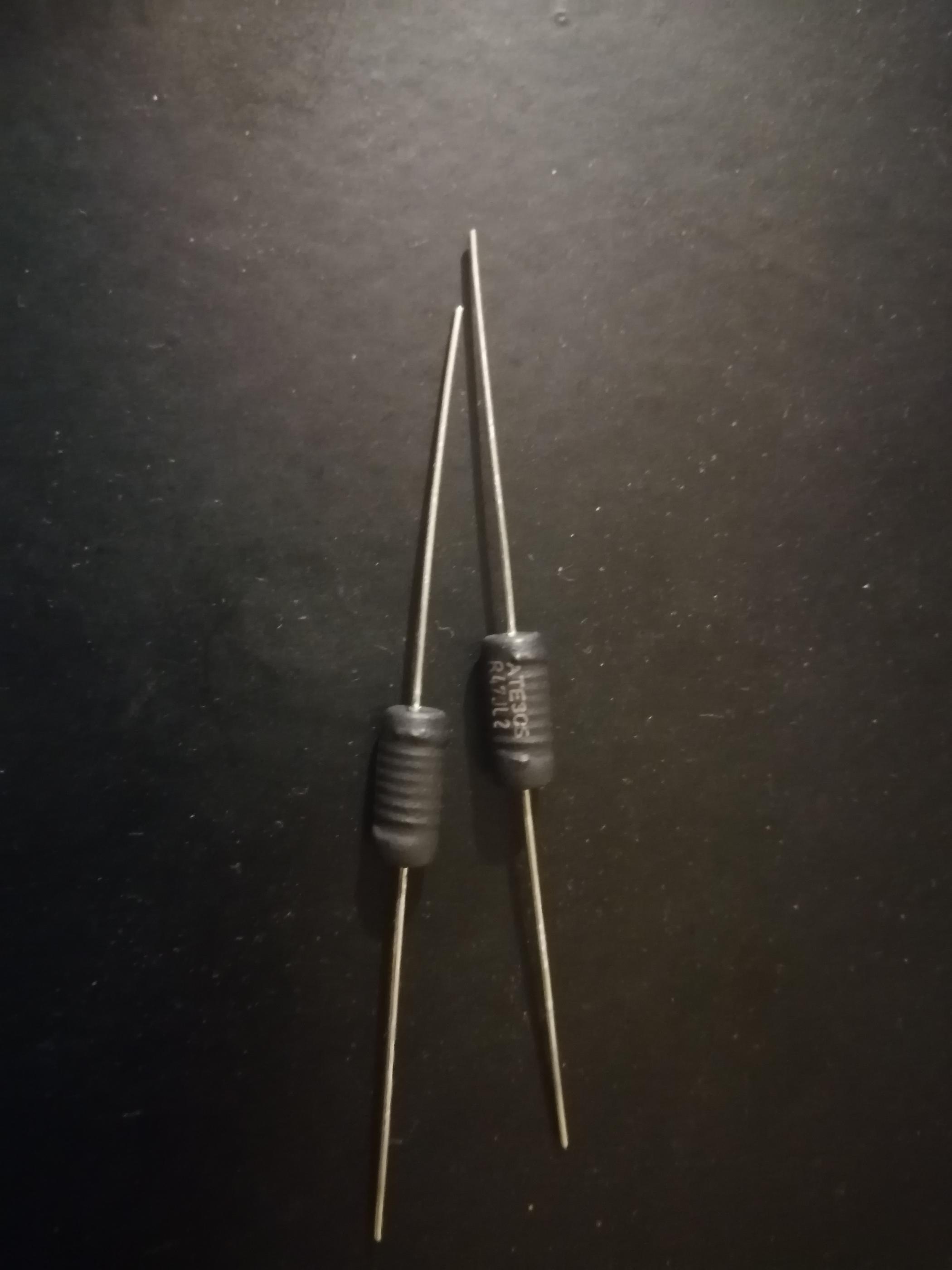

I'm not discarding them... not yet at least 😉Yes, also me would like to give a hint more support to those manganins, before discarding them fast.
My intention was to support both, eventually.
Isabellenhuette can possibly sound different, I'm convinced that those Mundorf are custom Powertrons.
I'll keep you all updated 😉

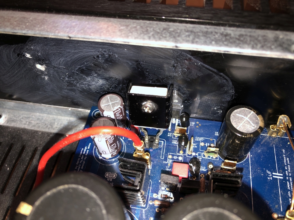

Well, things are going in an unexpected direction...On the contrary Dale RS-5 have spot-on timbre and richness, a nice improvement from the Caddocks that suffer from their peculiar, greyish, coloration.
And this with steel end caps...
Maybe boards could be modified for axial R3 instead of TO247...who knows? We'll see. 😉
Dario, I ordered a set of the Vishay Dale RS-5s (after your post) and am running them now. They sound quite nice! I also ran Isabellenhuettes and even though they sound richer and sweeter than the Caddocks they still left a slight veil over the music. These Dales sound amazing although I’ve only run them for 30 minutes or so.
BTW, I ran the Isabellenhuette for about an hours w/o heat sinks and they didn’t even feel warm.
