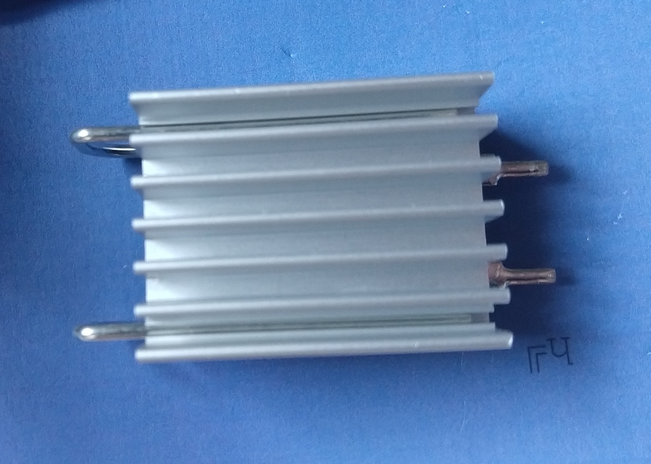

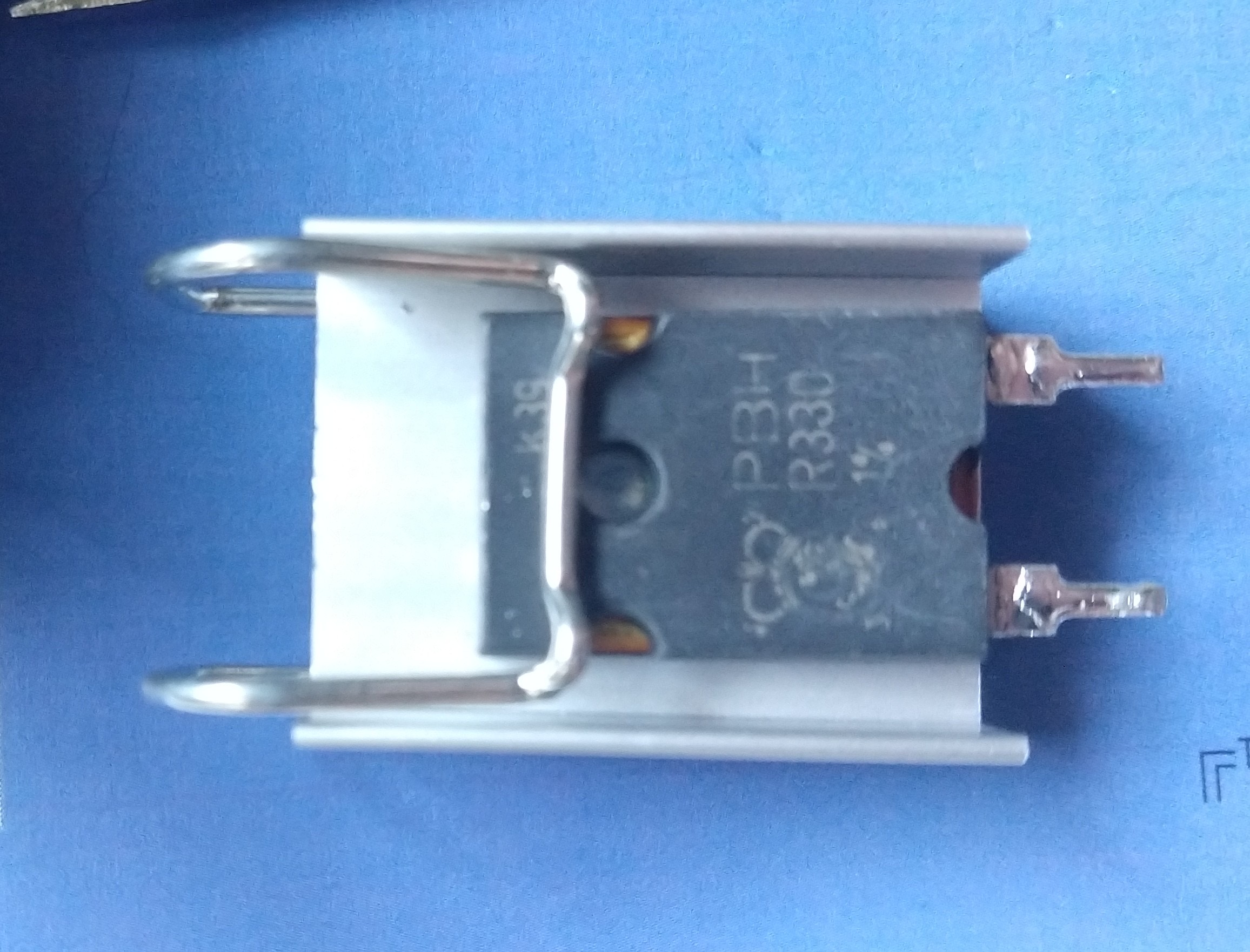

Dario, I meant to send this info on heatsinks for TO-247s. Ohmite makes #WV-T247-101E that might work for your power resistors (see pics). An Isabellhautte (sp?) is mounted.
Regards, Pete
Regards, Pete
Regards, Pete
Wow Pete, thanks, it's a fine heatsink with a nice small size but it has a problem, though.
The spring is made from steel, a high magnetic one from what I've read so for me it's a no-no.
Is there a version with screws?
